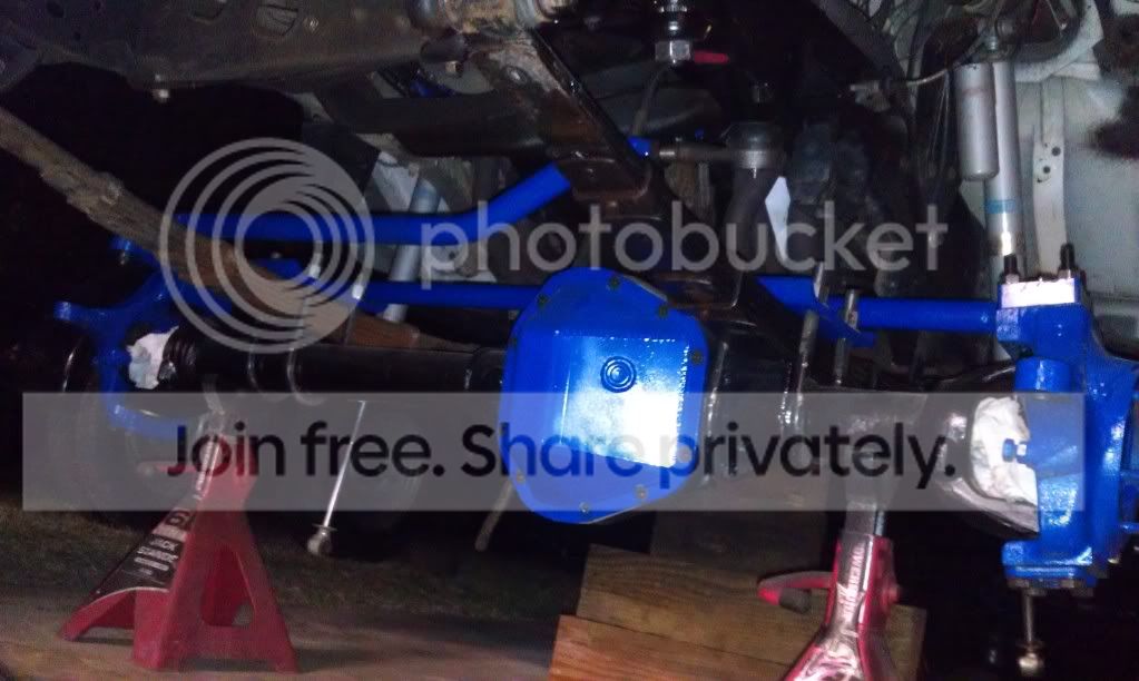

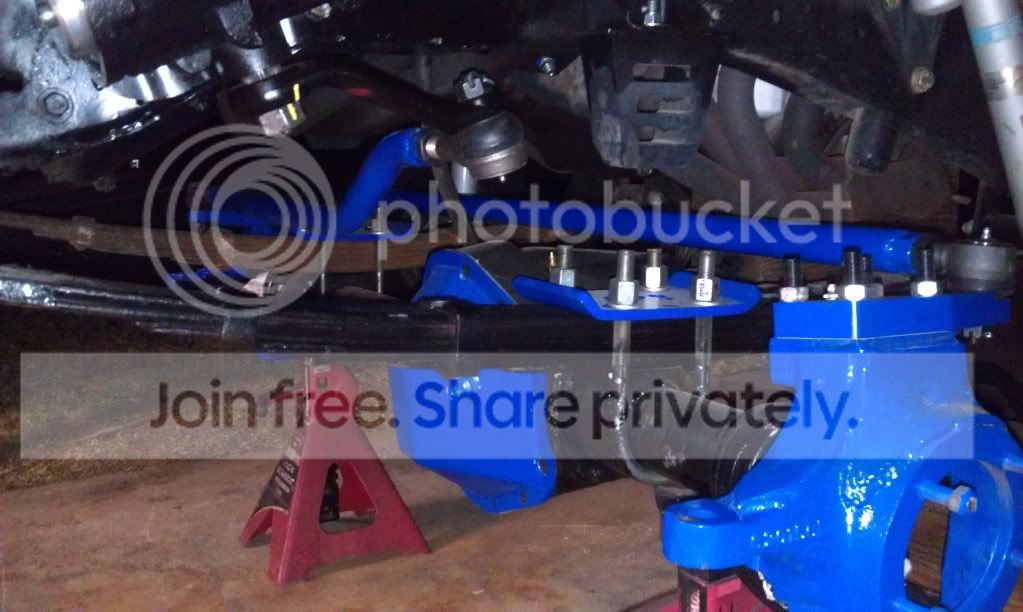

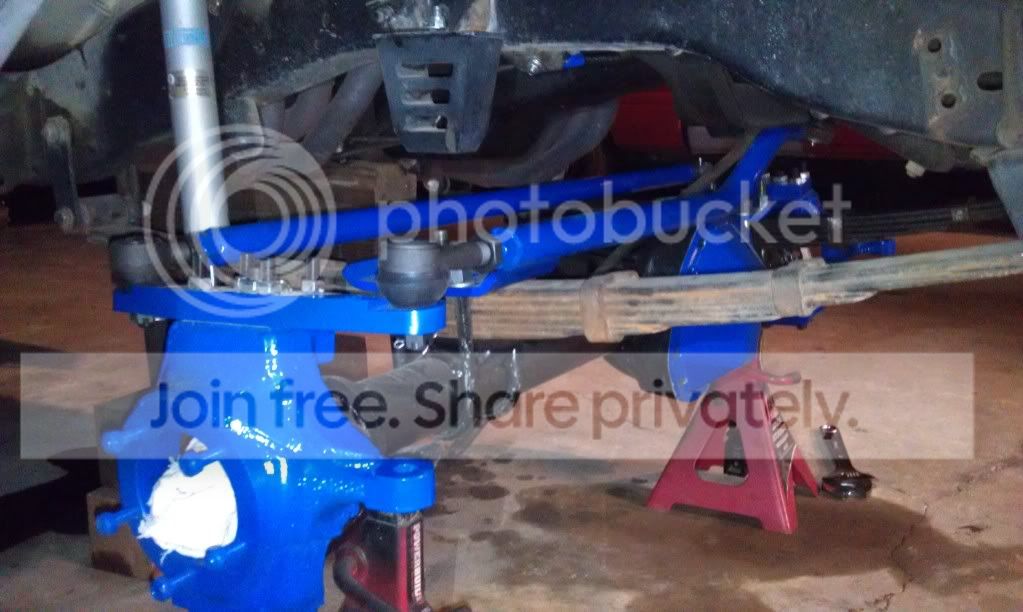

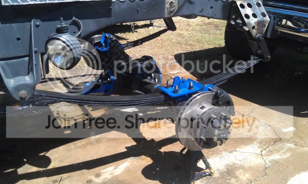

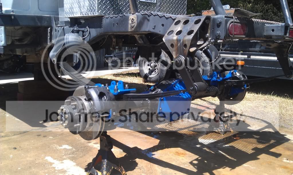

I got the steering all setup and done tonight. I trimmed the tubing, welded in the inserts and got it all painted and adjusted. I turned it lock to lock by hand without the truck running and it's smooth with no bind. I'm sure I'll have to give part of the factory crossmember a little trim but I'll figure that out once I get the truck running and can go flex it out.
Picked up some u-bolts on the way home from work to get the rear locked down so I can take it off the big jackstands and start getting the shocks and traction bar back in tomorrow.
Also been scraping together cash to place one of the last hefty orders for this build and got that taken care of tonight as well. So the 4340 inner shafts and spicer joints should be here wednesday so the front end can go back together after work later in the week.
So this weekend I guess it's getting the traction bar and shocks in with the rear u-bolts. Then yank the headers since I know they won't work and need to be replaced with something and then get back on the doubler linkage. I keep getting distracted from that and it's going to come back to bite me time wise I just know it. :)

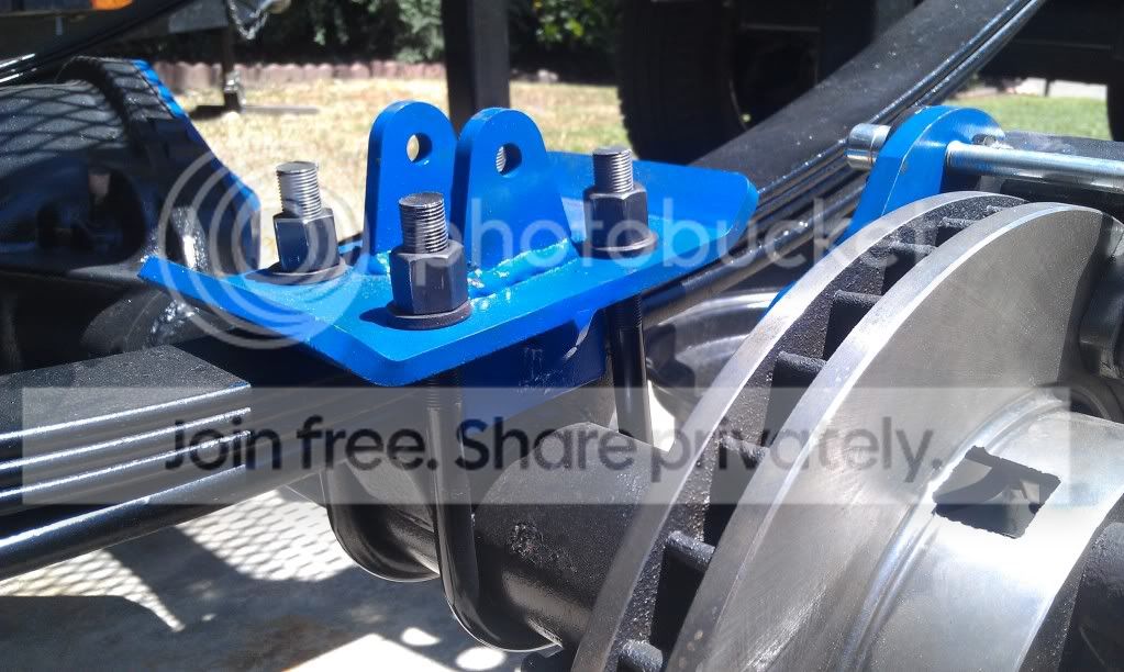

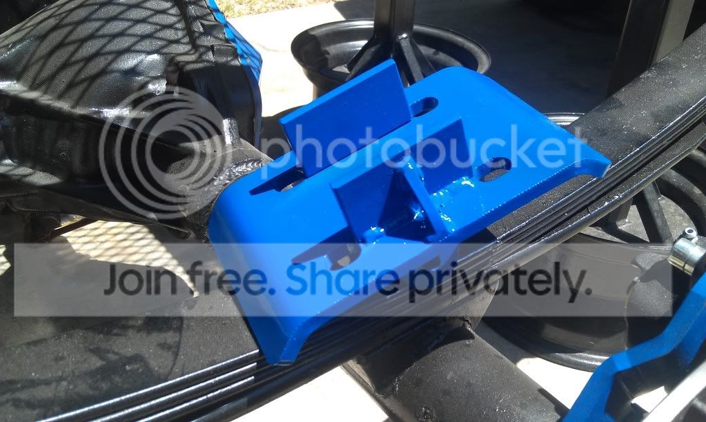

Wasted a bunch of time this morning at the metal yard, they were really backed up and only had two guys grabbing stuff. Came home and whipped up what I hope is going to help with an on-going spring problem. My leaves like to twist out of shape and I saw kert do something like this (much fancier but same idea) and I liked it so I stole it. :grin:

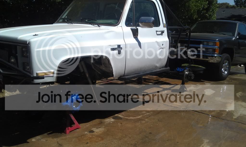

Got the 14 bolt bolted back down so now it's officially back on it's own axles. :)
I have to go take care of some stuff this afternoon but tonight my plan is to get the traction bar back in and work on the upper shock mounts.
