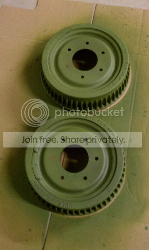

Had to buy new drums as the old ones were probably the originals and had exceeded specs. I cleaned them thoroughly and sprayed some zinc chromate on them as a base prior to hitting them with some high temp black.

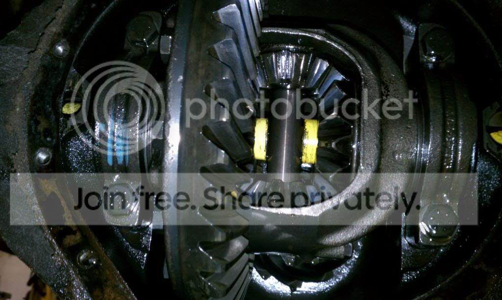

I think there is a stamping on the side of the ring gear...but I am not sure...
Did you find a tag or sticker in the glove box or door jamb that had the VIN code on it?
I read that a Limited Slip Differential test is to get both wheels off the ground....turn one wheel in a specific direction...if you have limited slip the other wheel will turn in the same direction....if you don't it will turn in the opposite direction
Admittedly, I know nothing about differentials...I've never been in one...at some point when I change the fluid in mine I will have a closer look at the inside...
I ran the VIN through the slosh website...didn't find how that info helped with the axles
There could be other RPO numbers that indicate what differential should be in there if it hasn't been changed...here are some of the codes

My sticker says I have the GT4 : AXLE REAR, 3.73 RATIO
I wonder if that is good or bad?
3.73 is a good ratio. 3.42's would probably be better for you, buy 3.73's will be just fine.

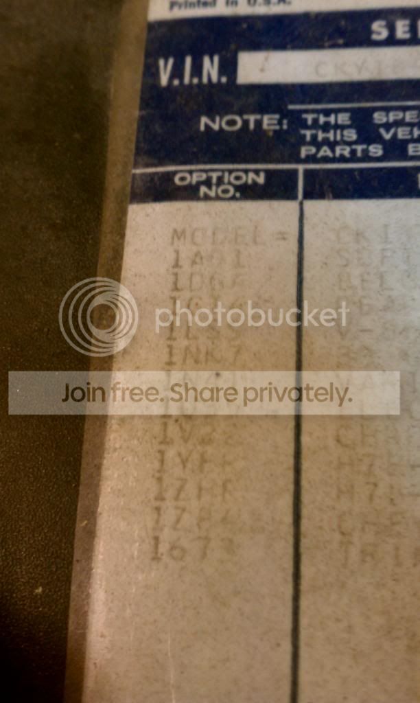

I looked and found the sticker you were referring to. It was in the glove box but a little worn out. The numbers are still readable so I'll reference them against the chart you posted and this website
http://www.rpocodes.com/
Thanks again.
Looks like you have gr4 as well. So 3.73 to 1 ratio like chief. Not a bad ratio. Good for 33 inch tires. I've seen a lot worse rust. That interior is gross but can be worked over. At least get a matching color on there. Lol
Thanks, I couldn't decipher the G code...that makes sense. The interior will take some serious TLC to get it back into shape. But right now, nothing is as bad as trying to get my rear brakes back together. Whoever the sadistic bastich is who created drum brakes should be shot down like a lame horse.:weapon2: Getting my butt kicked getting them back together. The good news is I'm doing one side at a time so I do have a reference.
It gets easier the more you do them. They work well for most situations but I like my disk brakes much better.
