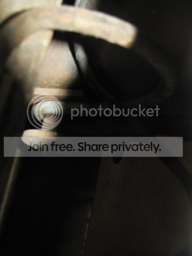

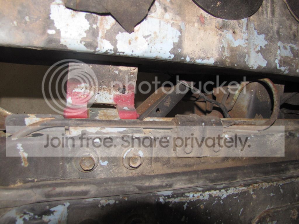

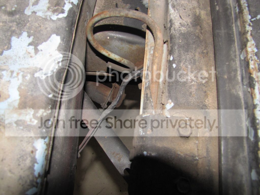

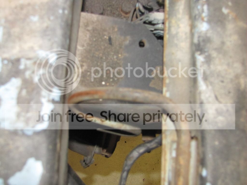

In this picture, you got something I am trying to figure out....on the tailgate there...the torque rod...see the bracket that holds it to the tailgate?
There is a plastic bushing under that...which way is it facing? There is a "block" end and a tapered off end...which way is it facing?
and also, it appears that the torque rod "Loop" is up and not down like I thought it was...right there where it attaches to the frame, the big half circle bend...is it bowing upward or downward?
uh....not sure what you're referring to Chief. Can you circle the area you're talking about with Microsoft Paint or something and repost it?

Alright Chief...saw what you were talking about and took some pics. Those rods are on both sides but not setup the same way. The driver side isn't connected to anything while the passenger one loops around a mount. Seems like the driver side mount may be missing. Considering the physics...the driver side may be backwards...hmmm.
Hope you can see what you need.
