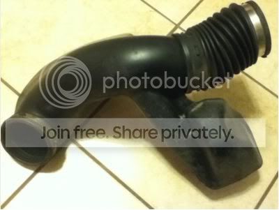

This is the tube i bought. Looks like all i will have to dick with is cutting off the catch basin thing. Its one of the good ones that dont have the silencer things off of it. Even if its ugly it will look factory!

With the fan in the way,that stock intake looks like the only chioce. Will you put the MAF on the other end?
It's a th400 so good there. No egr plug needed. Newer exhaust and intake. Yea the maf will go in the stock location.
