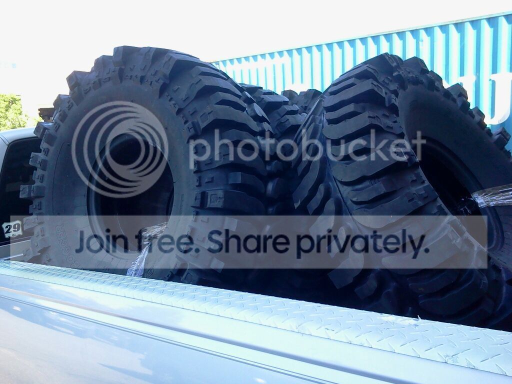

Thanks bud. Motivation has never been my problem, it's always time and money :D. Can't wait to see a cage in yours. Every time I look at yours I want 42's real bad. In fact just straight up 42" TSL's is what I have looked at. Where did you get yours at?
Long story, but I lucked out and got them free as a gift. Basically I made a lot of money for a friend by putting a tenant in his office building and he offered to buy them when he saw my truck. He paid ordered it online and I picked them up from 4 Wheel Parts.

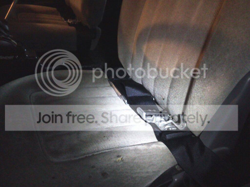

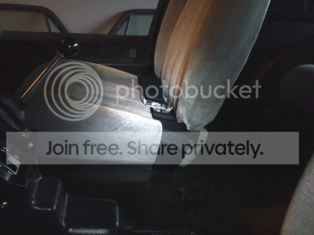

Figured I would bump this up with a small update. First off, I purchased some G-Force 4 point harnesses since their 4 point harness was cheaper than some simple lap belt set up's. For the time being I took out the crappy factory seat belts and installed just the belt portion bolted in the factory locations. When I get after market seats at some point, I will install the shoulder straps too. But for now this is still an upgrade from the factory belts.

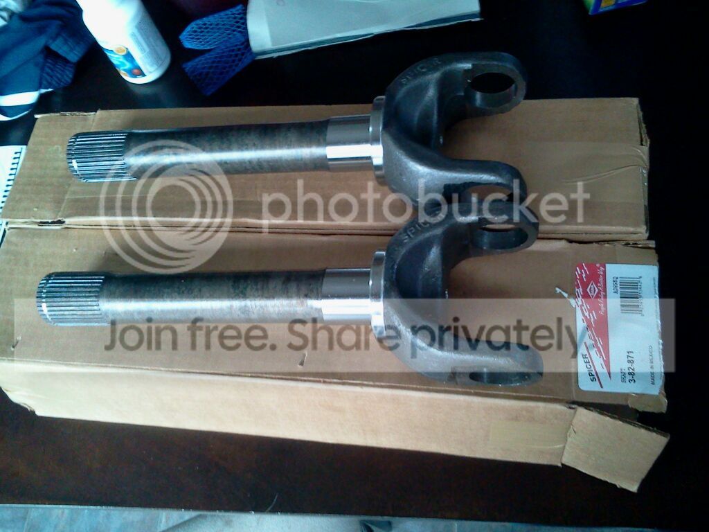

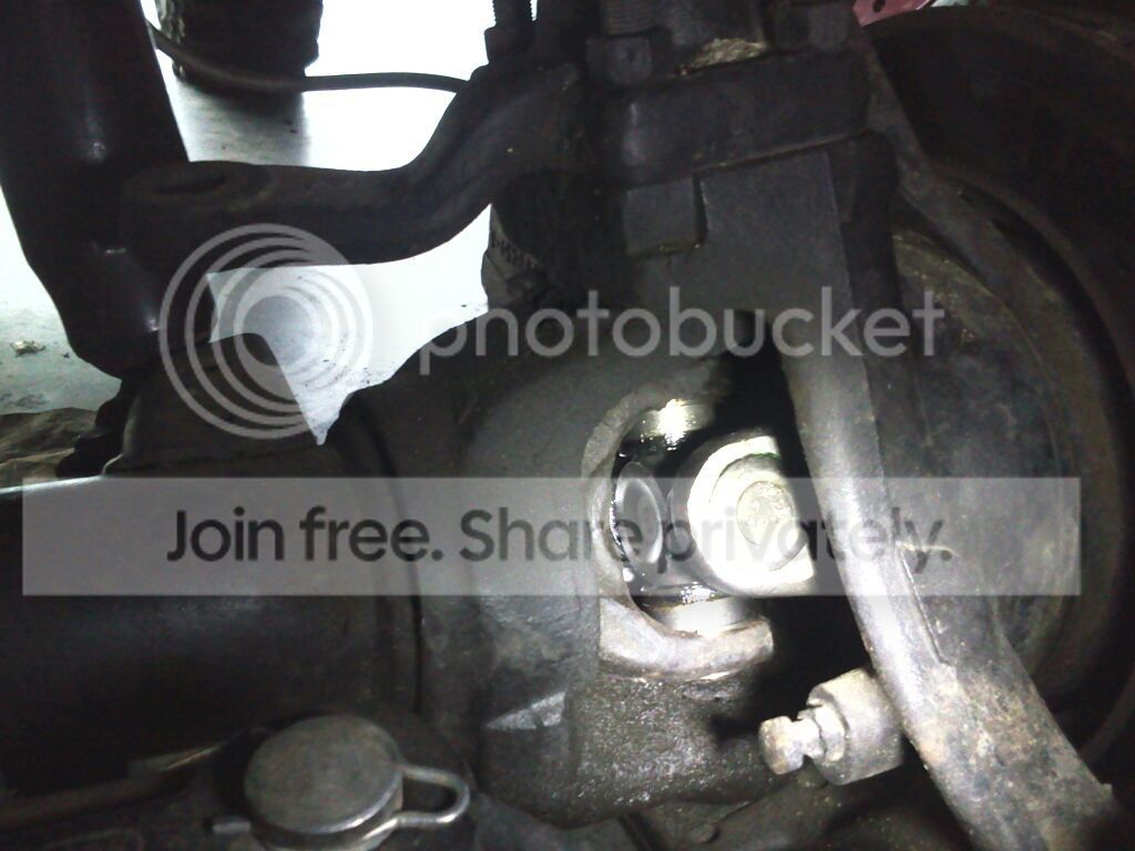

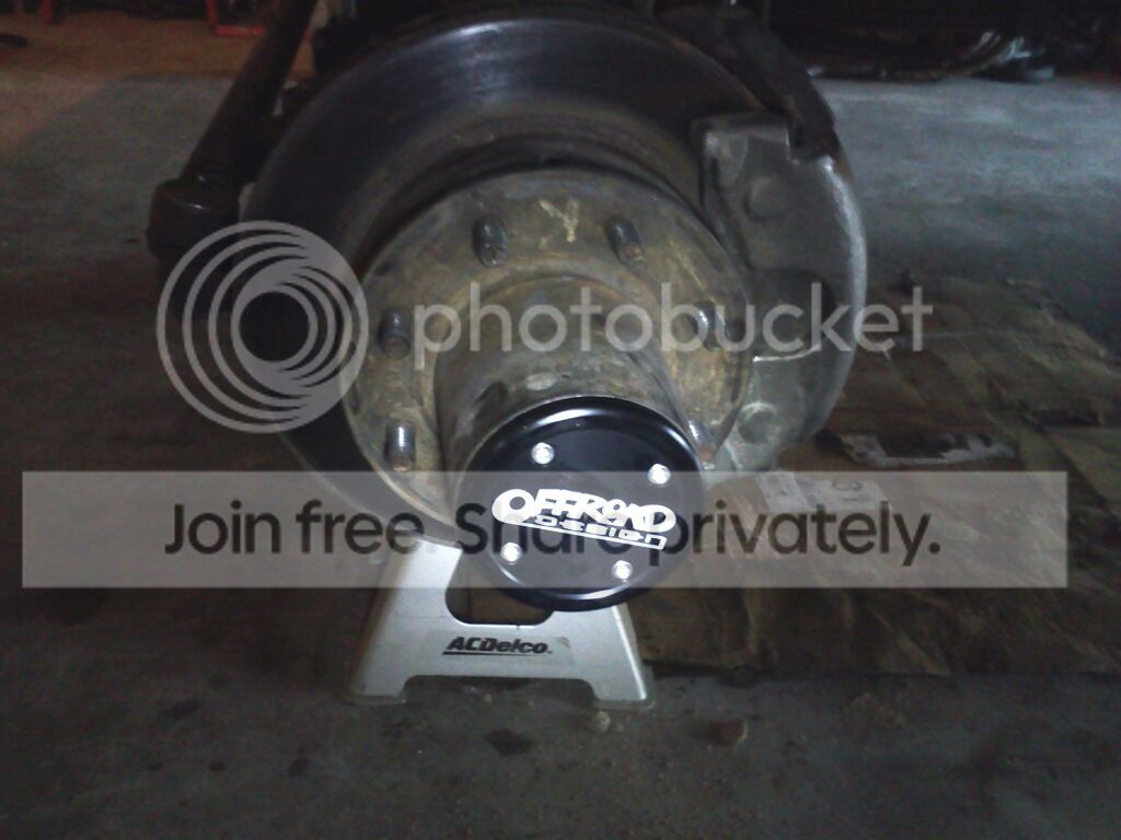

Also, decided it was time to do one of the last real upgrades my d60 needed. Did the 35 spline upgrade. I decided I didn't want to spend the money on chromo's since they are freaking expensive. Considering mine is just a trail rig with no high HP, I went with replacement d70 stub shafts off amazon for a pretty good price. At the same time got some spicer ujoints to replace the current ones
Didn't take many pics of doing this b/c there are about a thousand threads showing this, but at least a couple pics to prove it was done :D
New joints
Decided to go with ORD's drive flanges. I like how you can remove the gear and put the cap back on and keep driving if you want to. Don't know if I would ever do that, but nice to have the option
Bling bling
This was done as a upgrade to handle bigger tires which will happen at some point this year

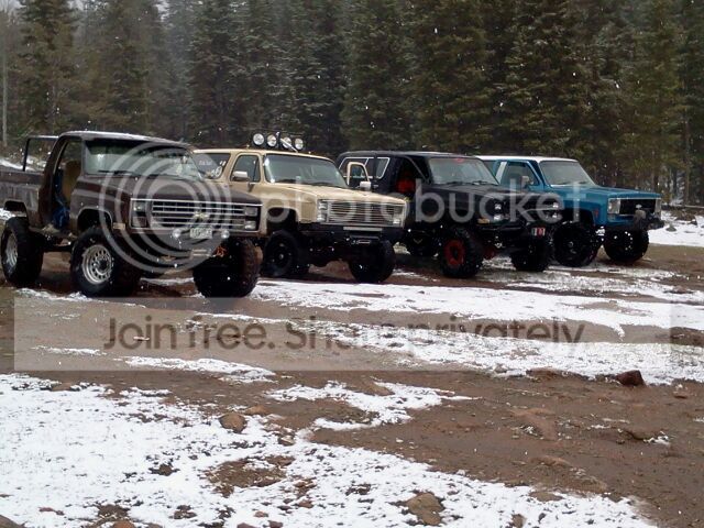

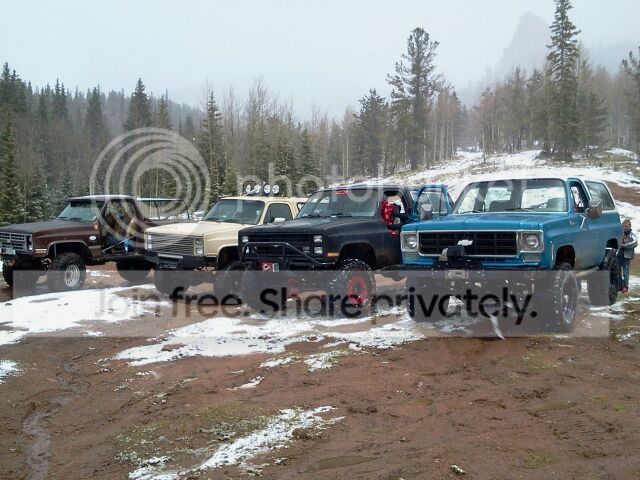

And a couple lined up shots of all the blazers
I love the look of that blue K5. Could definitely benefit from all the upgrades that you have done to your blazer though . . .

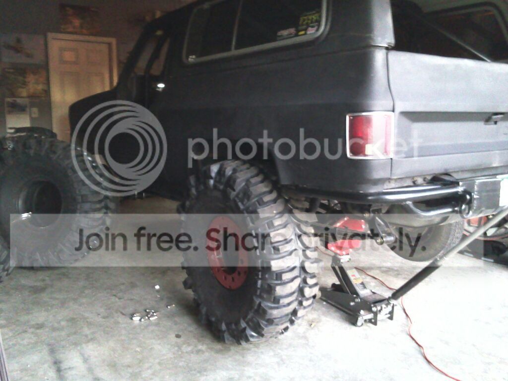

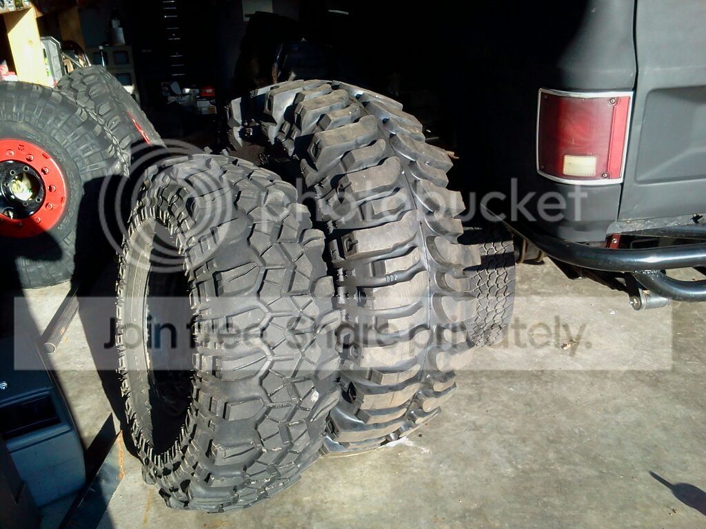

44x18x16.5 boggers. Bought these off of the blemish website cause they were about $300 less after shipping than any 42" tire I got a quote on. These are a bit more narrow than the normal boggers, but the tread/sidewalls are a lot softer. Interco said they were a "competition tire" so weather that means sticky tire or not, who knows, but they are a lot less stiff than normal boggers.
Next to my 38.5...it may just be because I am use to looking at the 38.5's, but these things look so freaking huge
A little mock up on the rear. There will for sure be some more fender trimming happening
I did a little mock up on the front too but it was too dark to get a pic. I think I am going to have to get rid of my inner fenders, do a little more trimming, and probably make sure my firewall is smooth, but overall I am digging keeping it low with a huge meaty tire under here. I am going to extend my bumpstops in the front but other than that I am going to just run it for a little bit. The only thing I am a little worried about is my gearing, but I think it will be "ok" for a little while and then I might regear my axles to 5.13's or 5.38's. Oh, and the 38.5's are now for sale in case anyone on CK5 is interested, get in contact with me
