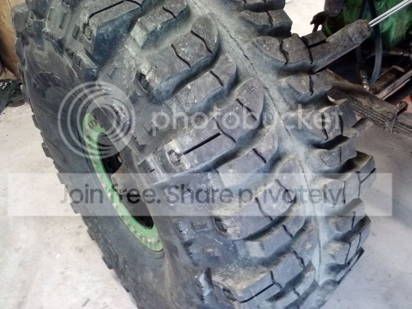

Yeah, my brother who is on 44" boggers too said now he has got so use to them, they look just average size now :haha:. I think once I cut some fenders more it will look more balanced on there. But I ran into a snag mounting up my H1's as it looks like the beads on these boggers are just barely bigger than the beads on my SX's, so with my current PVC inserts I can't get the rims tightened enough to create the seal. I will be calling TrailWorthy tomorrow to see what I can do. I am hopeful I can just purchase some new ones cut down to the proper size and then ship back my current ones for a relatively good price. So the mounting is going to have to wait until I can get that in order then some :hack: will begin
I would just sell the ones you have locally on CL or forums instead of trying to ship them back plus I don't know if they would resell "used" inserts.
Btw, I have a tire groover too but believe me the chainsaw blade disc is WAY faster and gives a nice wide groove. Harbor Freight also sells an adjustable guard that helps set depth of cut as well
Yeah, i was thinking probably the same on the PVC's. I was hoping my current ones would work, but the beads are just barely thicker than the SX's. Oh well, i will figure it out.
I will keep that in mind for the grooving. with how big these lugs are, a little bigger size groove could be beneficial
Bad ass tires but now I'm afraid you won't be up for any of the boring old trails I'm going to run. :doah:
Nah, I am a wheeler. I like to wheel any and all trails. My wife and kids don't really like going on the harder trails anyways. So I still plan on doing simple fun trails so I can bring them and keep it family fun. She already told me the harder stuff she will stay home :D
Update on the PVC's for anyone who is interested. I contacted Andy at TrailWorthy Fab and told him what was going on. He said it probably wouldn't be worth the cost to ship them to him just to cut them down. He told me to just get a table saw and cut them down about 1/4" and then take a flap wheel to smooth it down a little bit so they don't cut the tire and I should be good to go. So at some point this week I will get that done and hopefully get these things mounted up
