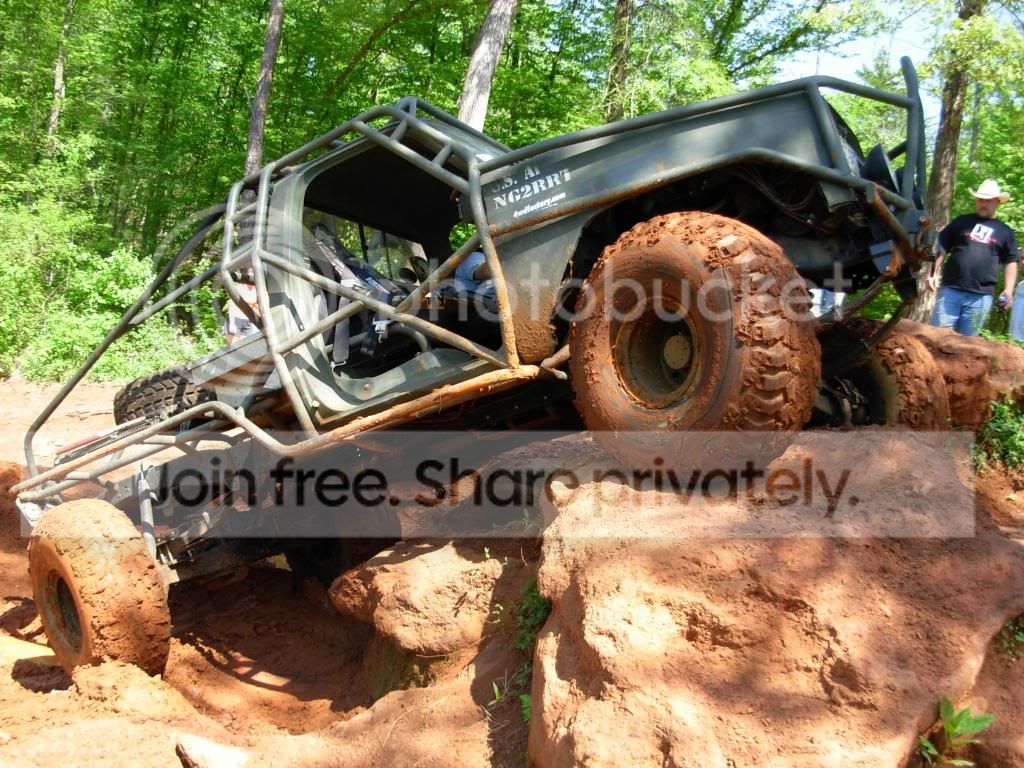

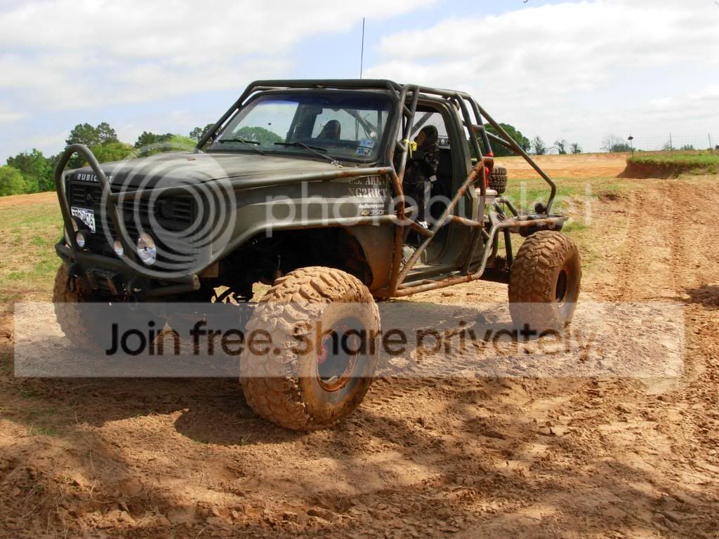

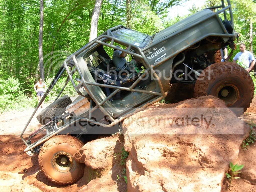

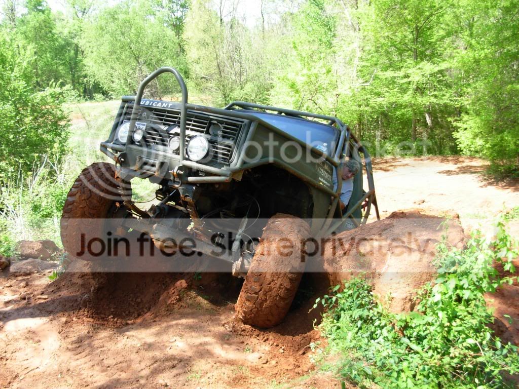

Its an 87 1028, had 28,000 miles on it when I got it in stock form.
6.2 liter diesel, gm-8 turbo, cranked up pump and strait piped
th-400
Klune 2.7 mated to a twin sticked 205
front shaft High angle 1410 cv 13" slip, rear is a 1350 cv and 1410's at both axles

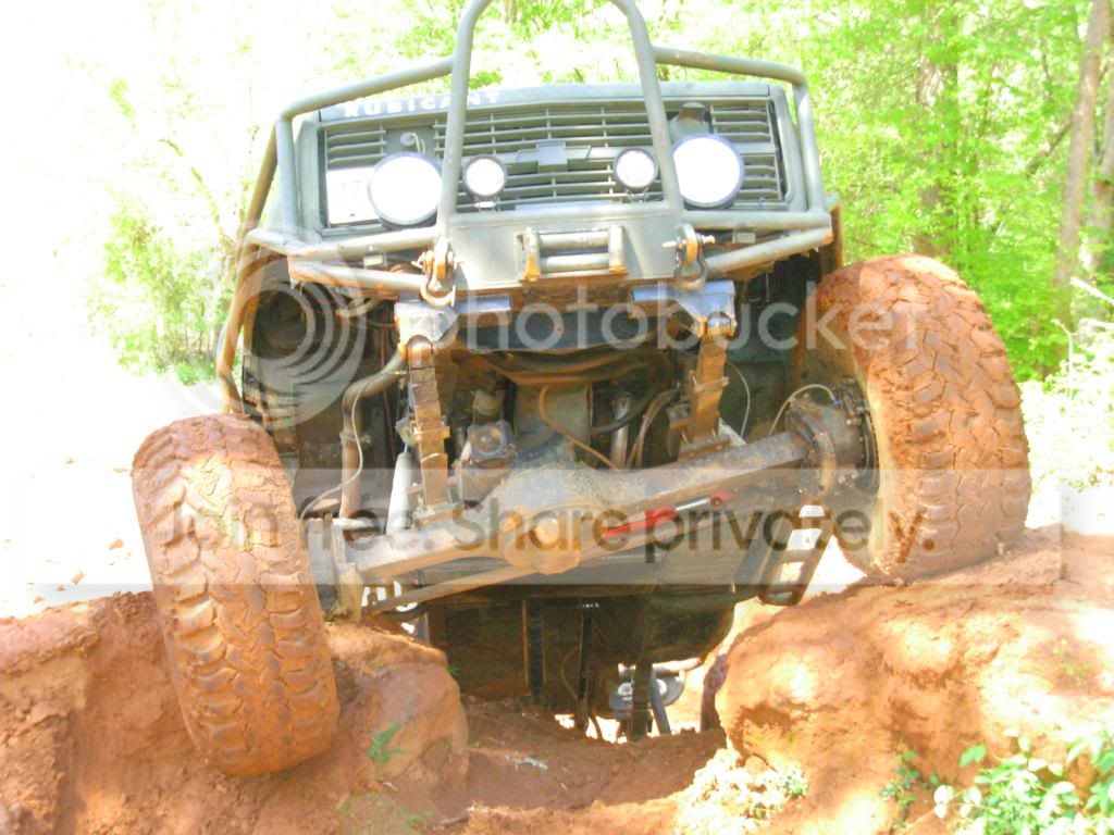

shaved steering rockwells, Ouverson super 8, Willwood 4 pistons at each corner
full hydro front 2.5x10 rams, Haldex electric pump for the rear
front 52" custom leaf packs, rear 56" custom pack w/shackle flip
15x12 eaton beadlocks, 42" Iroks

Yea we will be up there for the Halloween run, should get there Fri. Yea I saw pics of your truck, looks good bro., my only suggestion would be to get it as low as possible. My truck went from 9" of lift to 6" and it was a WORLD of difference, low Center of gravity is the way to go.
Later
Yeah I was wanting it a few inches lower but I need it high anyways to clear my 49's. Plus as long as it is I will need a lot of belly clearance to get over big stuff. When I get done my wheelbase should be around 135"s. It will be tall but it is gonna have a really flexxy suspension under it. I pulled the bottom leaf out of the front springs pack and that dropped it about a inch plus the springs are gonna settle some once I get all the weight back on it. So far being on 49's it really wont be that big but over all it is a big truck.
Also I wont have my truck ready before halloween. I am gonna try to have it ready for a shiloh run on new years weekend. I am gonna try to talk some other buddies of mine into going halloween though. So I may see you down there.
Hows the truck running?
Pretty good, been having some issues with my brake calipers coming loose and ripping off. Just got it all put back together (for the 2nd time), and hopfully I solved the problem.
Bent the rear tierod pretty good, so I built a new one. Now I'm bending the 3/4" grade 8 bolts that hold it on.
I also narrowed the front around 20 inches, and have a couple loose ends to tie up. Overall I think it turned out bad a**. I'll get some pics up tommorow.
