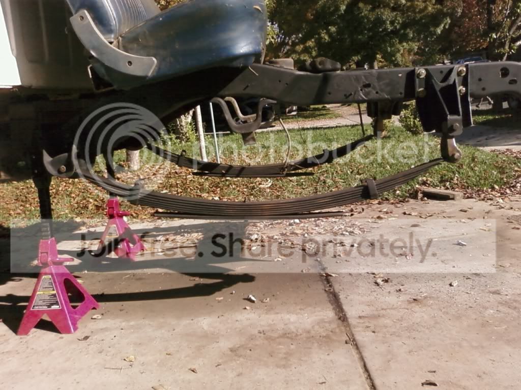

now that got the front suspension done i moved to the back. i took the 56's off the axle and removed a leaf out of the pack and replaced the overloads with other ones i had lying around i got em all painted and i bolted the fixed end of the spring on since im still working on finishing my hangers. im making them the same way howdiy did his except im doing a little more support but anyways i plan on finishing the hangers tomorrow and then ill clean and paint the axle but im not touching the brakes since im gunna do disc brakes in back and i need to gather up the parts. and what do yall think about putting one inch blocks in back wouldnt it pretty much be exactly the same as a zero rate?
what do you mean by spit it out? all ive ever seen happen to blocks is being literally crushed from axle wrap but they were aluminum ive got steel ones
When I got my truck it had 4" blocks in the rear, and they would start to fall out cause of the axlewrap no matter how much you tightened the u bolts. Happened so often it squished/rounded the spring perches
oh crap well im planning on doing an anti wrap bar so i guess i wont worry
yeah it shouldnt be a problem with a 1" block and the beefy perches on 14ff, the 12 bolt perches just suck

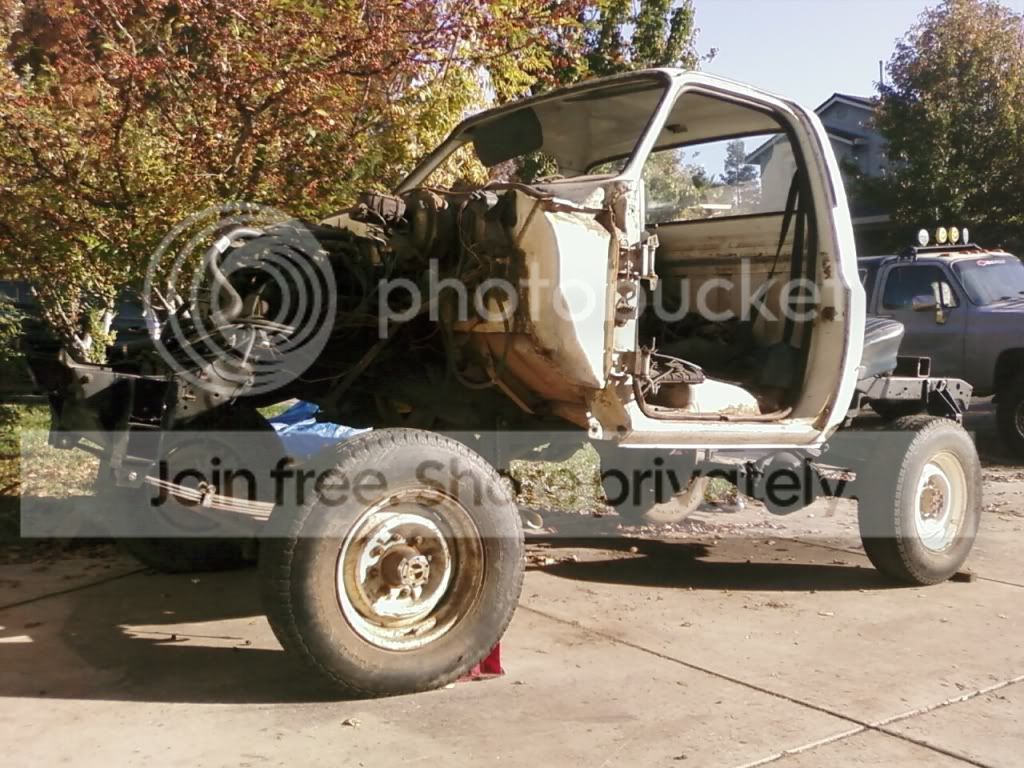

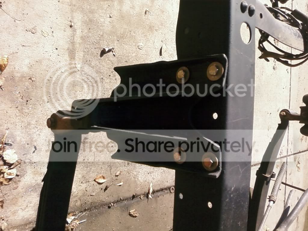

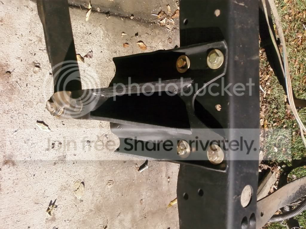

well i finished the hangers tell me what you think

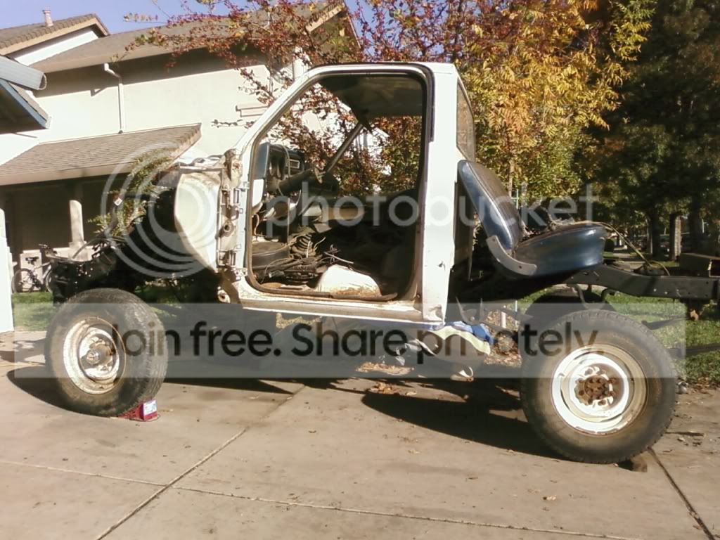

the 56's on
suspension done

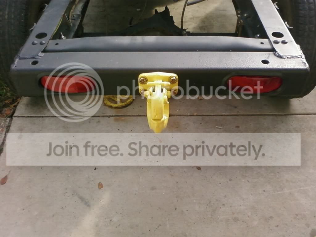

next on my list is finishing my rear bumper putting radiator support on and start wiring stuff up
looks pretty good. It's hard to tell from the pic but how's it sitting, looks a little nose high. But then again you still need to add the rad and sheetmetal so it may level back out
ya its a little high in front but i think its gunna level out and even if it doesnt im not going to mind i kinda like the way they look a little high in the front but i was very surprised at the lift i got with the 56's i measured my blazer that just has a shackle flip and 52's and measured the trazer which has shackle flip 56's and a one inch block and its 3 inches higher than the blazer. but i guess the blazer has the fliberglass top and the rest of the truck so i dont know but its higher at that!

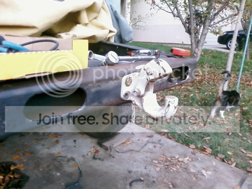

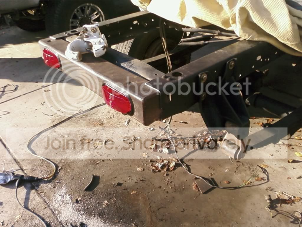

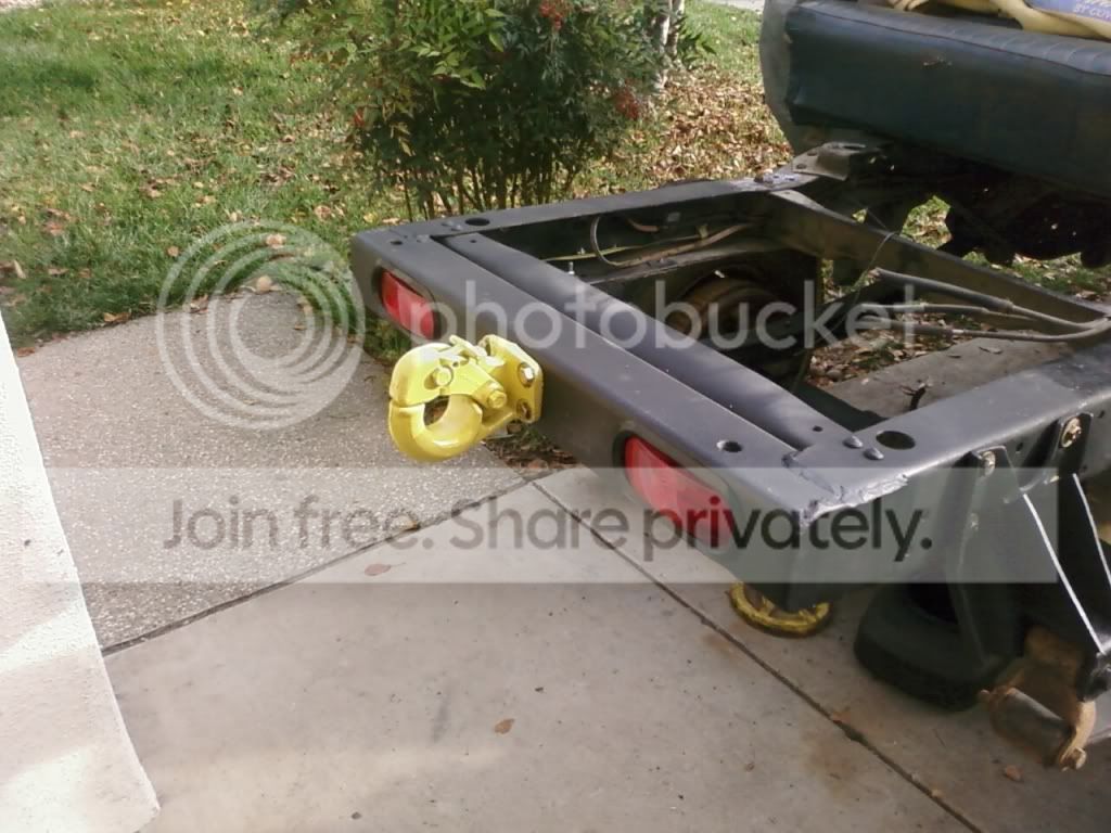

Looking good. Are those tractor supply lights I see? I have those on my trailer and they pop out all the time cause I cut the hole to big
ya haha the best deal i could find 9 bucks a light but i cut the hole so they would be super snug and the pintle is courtesy of metro for 10 bucks
