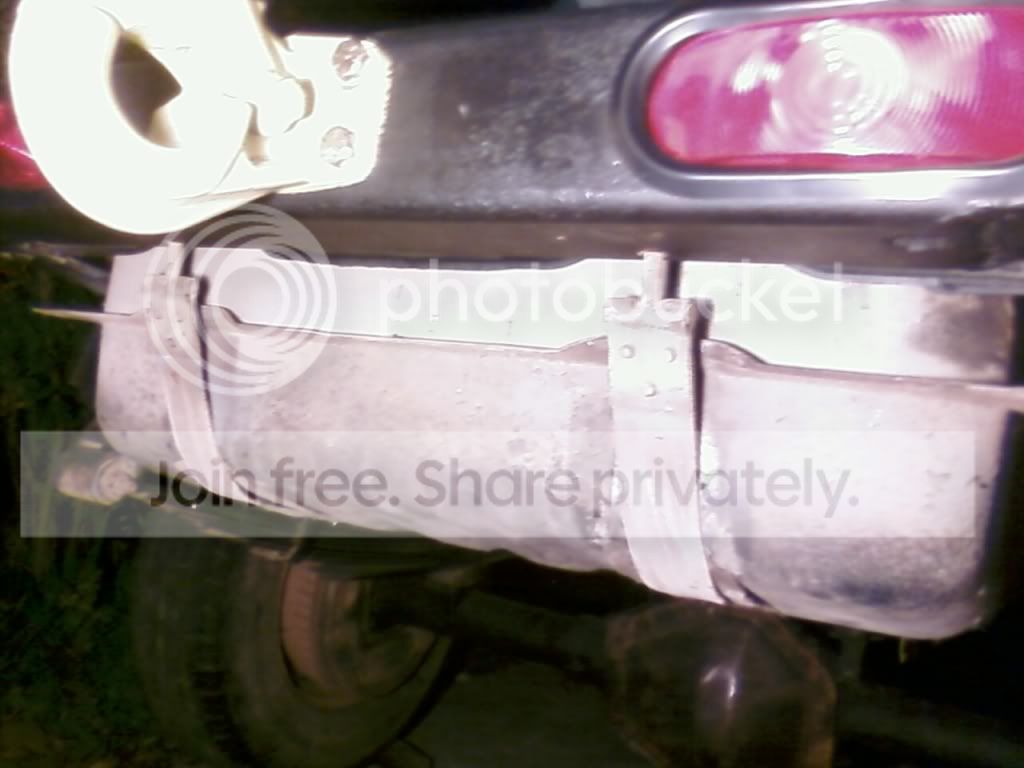

Nice, do you still have clearence to get to the rear bolts for the gas tank straps? Or are you going to relocate the tank?
i actually cut that tab off that had the holes for the tank straps so i could tuck the bumper in there as much as possible so im just going to drill two holes in the bottom of the bumper that the little hooks on the tank straps can go into.

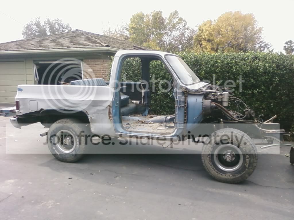

well as i said before i got a blazer for free from my buddy. heres a pic of it after i tore it apart
it was a complete truck except the engine im using the fenders hood doors hydroboost the floors and some interior stuff for the trazer and the guy i got it from wants the axles the rest is scrap. heres a video of us taking the body off.

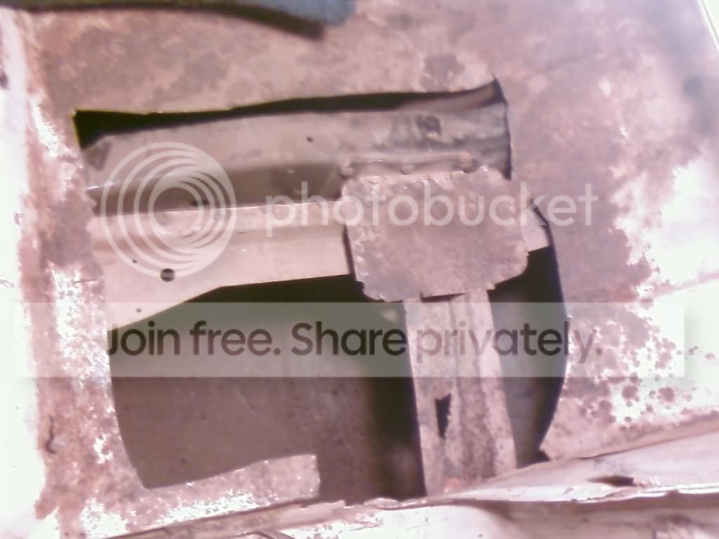

heres the passenger side floor i need to cut some more out so i can completely get rid of the really rotted parts and i need to replace that cab mount as you can see its rotted through
