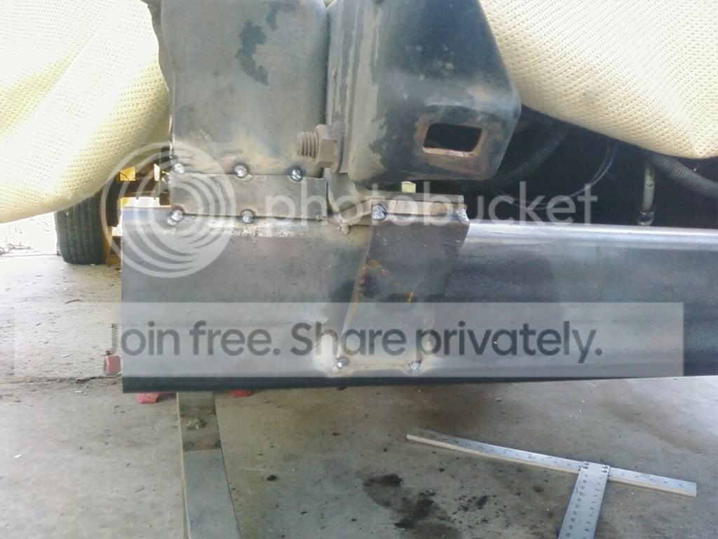

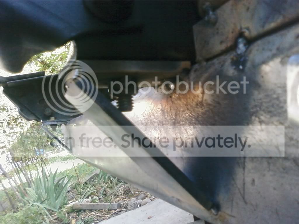

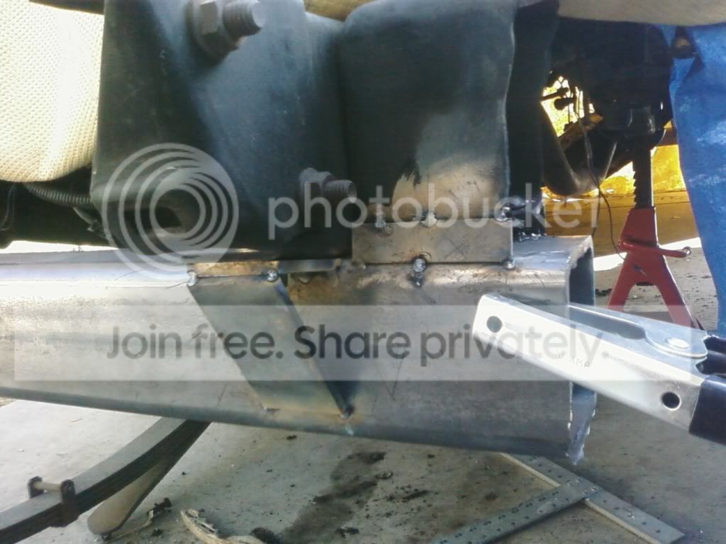

i did some stuff to the x member today im tacking everything then im going to take the member off and weld everything all up ive still got quite a ways to go before i take it off but i think this will show you the general direction im going in
with the crossmember that low, your gonna have a good about of lift, but I think its gonna mess up the caster on the front axle unless you're planning on cutting and rotating the knuckles.
Also if your not going to box in the sides of that little brace in the front its not going to be strong enough.
ya i know about the steering so to get it back to the right pinion angle im going to do longer shackles as well like i have on my blazer. also with the front mounts i was planning on boxing everything in im not really done with the design yet im just posting progressive pictures. and i dont know if i mentioned this in the pics but i kinda left out the fact that im doing the x member so i can fit 52's:D
