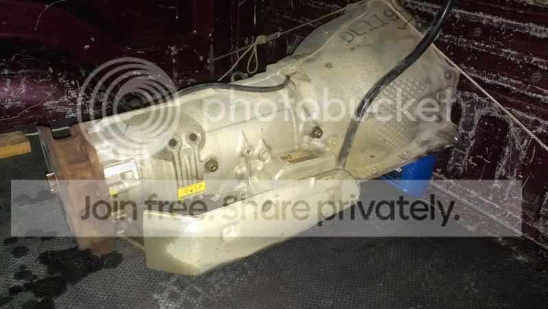

Well, it's been awhile, but I picked this guy up today...
Matches my engine in that it's an 04. Torque converter was included and it has 70K on it.
Well, turns out the trans is a 99. Gotta deal with that now...fantastic.
