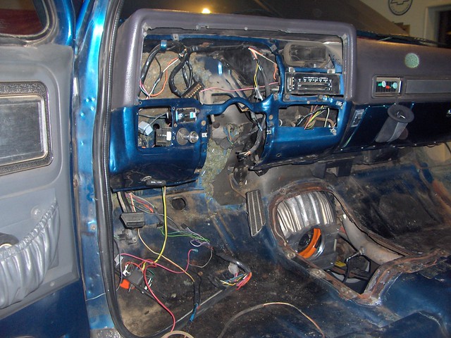

These pedals are kicking my ass. I got the steering column dropped to the seat easily enough, but no go on getting the old pedals to budge. I have the two bolts/studs on the front of the pedal bracket.
On the pedals in the truck, there are two lower studs that go from cab to engine compartment and two studs on top that go from engine compartment to the cab.
The new pedals have all four firewall studs that go from cab to engine compartment. So the top 2 studs will need to come out.
Am I missing something? Does the column need to come all the way out, or just drop down out of the way.
The pedals are a total pain in the ass to swap I’ll tell you that. Pretty much have to gut the driver’s side of the dash to wrestle them out. Not only did I have to wrestle the pedals out of my truck, I had to wrestle out the hydro pedals from the donor truck at the junk yard in December while freezing my skinny ass off. You’ll prolly need a box of band-aids when you are done too. Lots of sharpies under the dash to let the blood out of your fingers and arms.

I concur. But I will add that I didn't wind up tearing the dash apart like Larry did. That part must be optional. :dunno:
Ya, I went crazy when I did mine. Did all kinds of stuff at once since it was in bits anyway. Hydroboost swap, a bunch of rewiring, new stereo, new cluster, Rhinolined interior, blah, blah blah :haha:
I took my column all the way out. I also had to beat under the dash a bit with a hammer because some stuff was in the way.
