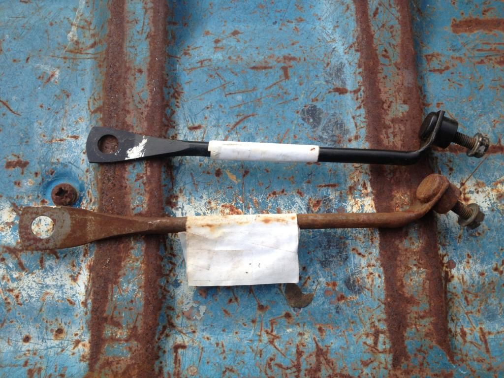

Nope, just checked, they are different lengths.
Martn
Martn
I don't believe the firewall is significantly different, I'm thinking the place the rods mount on the pedals is not the same.
IIRC the bolt holes are offset on the clutch master cylinder though too. http://www.yuk0njack.com/bbproject/brakeboosterp1230001.jpg
Are the different-length rods going to different spots on the firewall? I'm having a hard time picturing why they're different (and wondering if it's gonna come back to bite me-I have hydroboost brakes and a set of vacuum pedals).
It has nothing to do with hydroboost brakes, it is for hydro clutch. Both rods go between the firewall where the clutch master bolts on (note studs on one end) back to the pedal assembly.
)That is what I feared. Who has these to sell?
I could send you these if you wanted to try and duplicate it, and then send them back.
