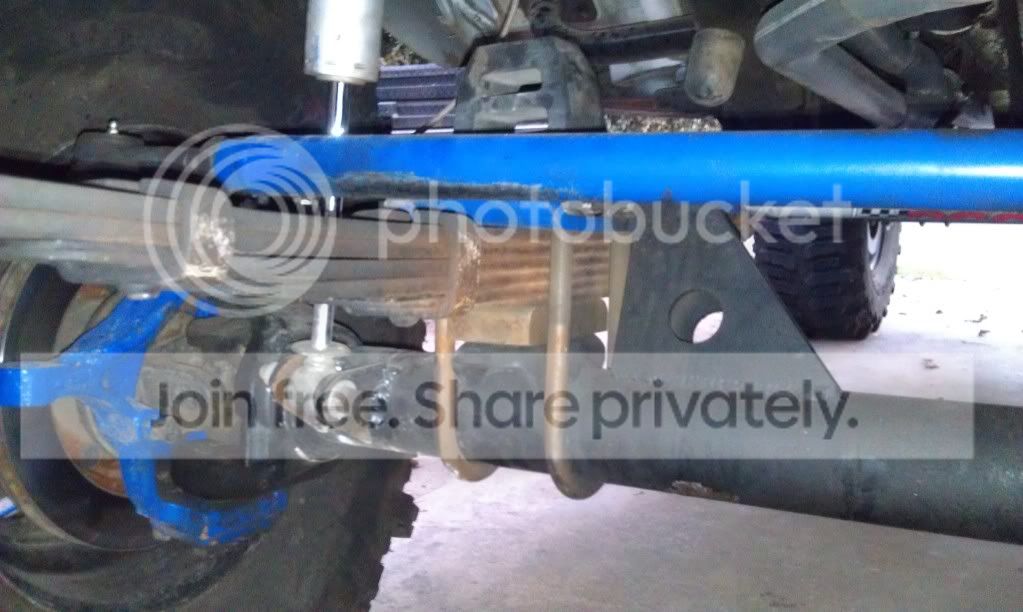

Well I'm in a pickle...
My current spring pack is 2" thick plus 1" for my zero rate and as you can see my draglink regularly rubs so adding another 1/2" to the overall height isn't an option.
I need to get some made up that are 5" lift with an offset center pin hole so I can ditch the zero rate but maintain the same height and axle location.
So as of now I'm (sadly) out. :(
If im reading that correctly your spring back is 3 inches think? these are 2.5 would a half inch of clearance help the not rubbing?
oh never mind you probably used the zero rate to push the axle forward.
Yeah my pack is 2" + 1" zero rate so 3" total and yes I'm using the zero rate to move the axle and get the extra inch (4" lift springs + 1" zero rate) so I have to keep the zero rate in there unless I get custom 5" lift springs with an offset center pin hole.
Link it. You can put the axle where you want it. And the tie rod won't hitanything.
