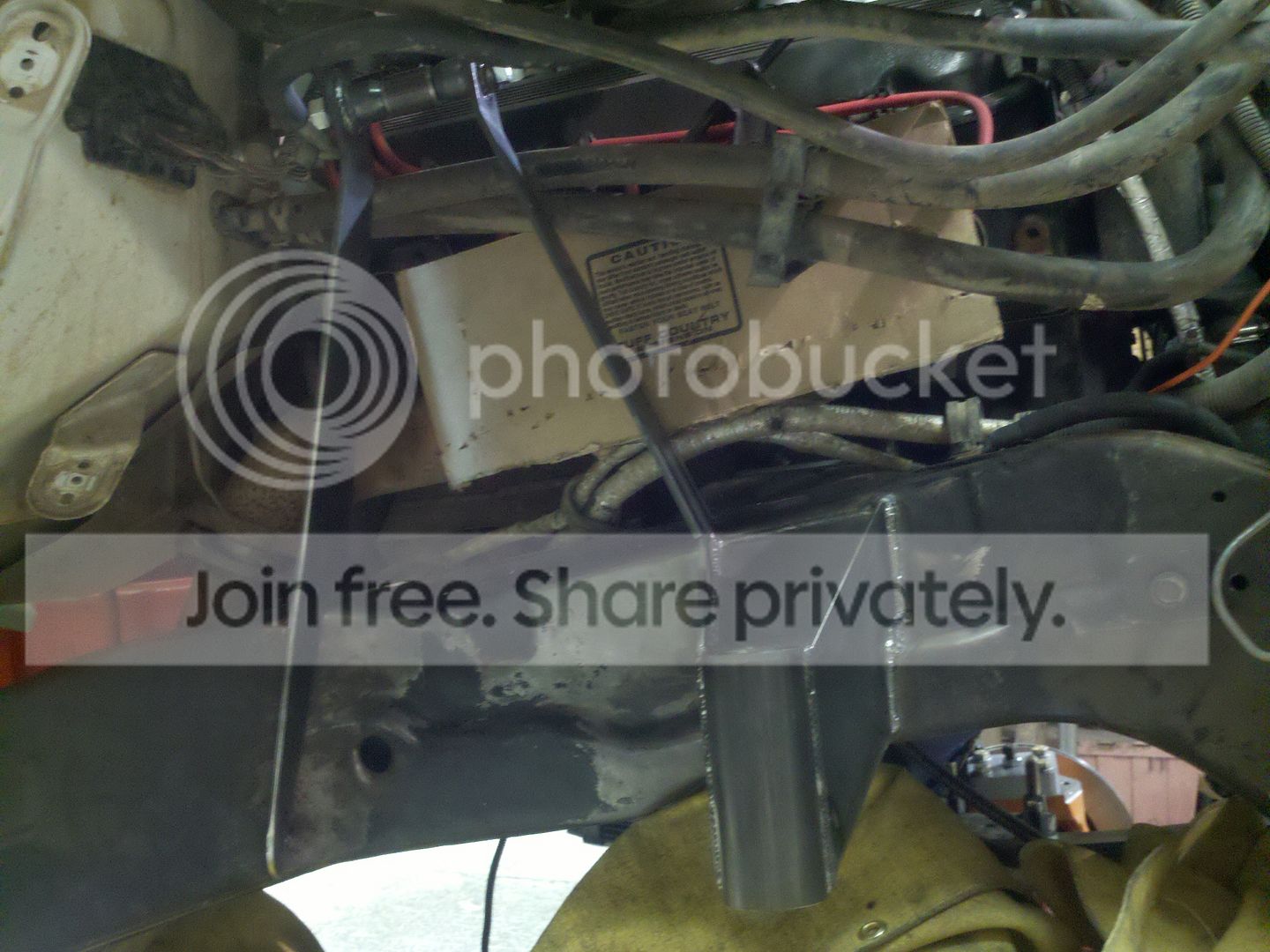

Shock mounts in progress and bump can mount:
T-case shifters got a little convoluted but they clear the seat, dash, driver's leg, trans shifter and each other while being relatively convenient to use and leaving some room for one of my kids in the middle seat.

The only problem I see is, I doubt that cardboard heatshield is going to hold up on the ultimate adventure. :waytogo:
