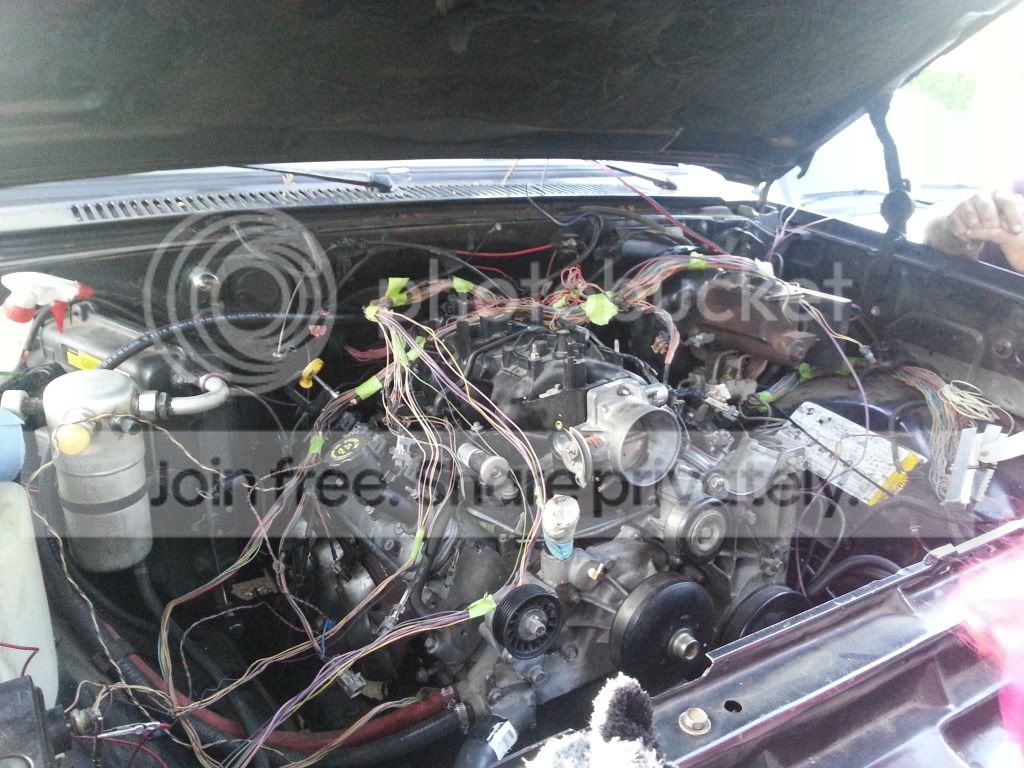

It Fired! It Fired!
Pics of harness just roughed in to make sure it would start, my awsome fuse and relay block and of course the vids!! :D
Oh and I think its sweet that my factory oil pressure gauge even works!!! 55psi:pimp:
