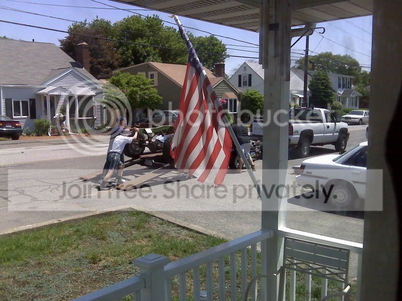

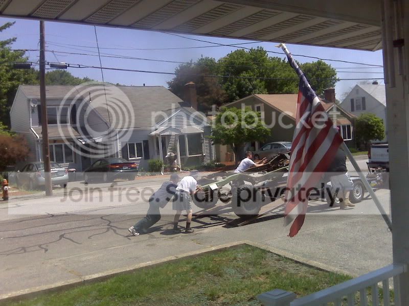

Couple pics my mom or sis took on their cell phone,
My favorite parts are:
1. The golf impersonator with the Bermuda shorts and black socks.
2. The "twist-proof" flag twisted convincingly around the pole.
Carry on. :waytogo:
x2. I was crackin up but didn't say anything
Yeah, thats one of my neighbors, who likes to tell me I`m doing things the right way, and how to fix my grass, etc. He once poured in a little conrete wall along the length of the gap in fence between propertys, because when I cut the grass, it would all blow down in there, and I couldn`t get in his yard to sweep it up, because his fence was always locked :rolleyes: He`s a good guy though:p::p:

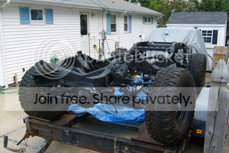

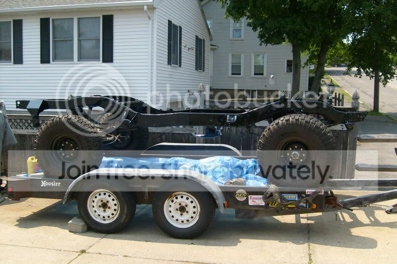

Well, the frames done! Hopefully the rain holds off tomorrow, so I can start working on the motor.

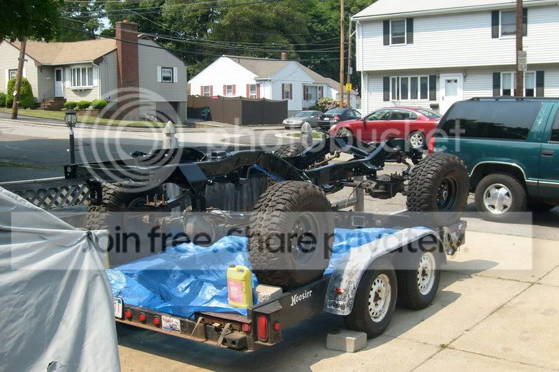

Back from blasting and ready for paint!

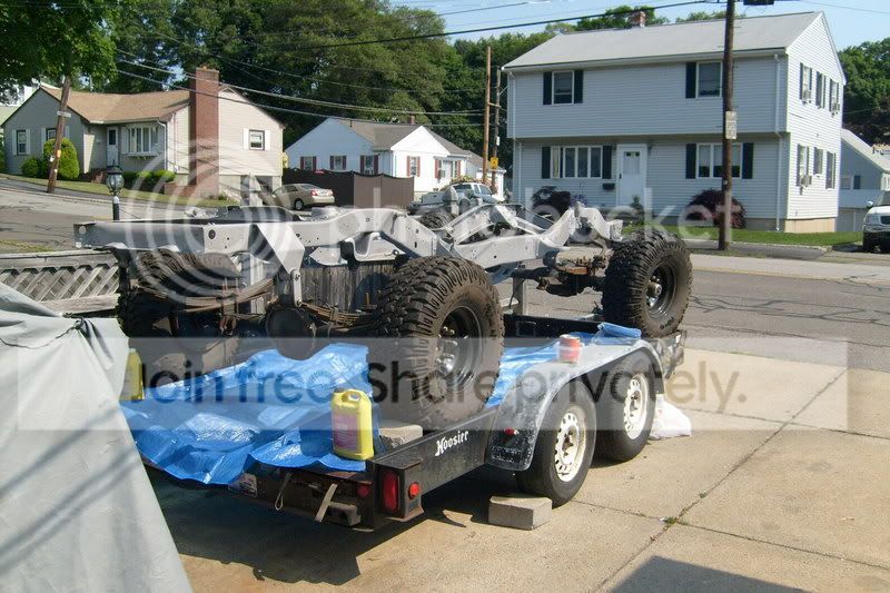

Prepped with Metal Ready, and first coat of POR15 applied.

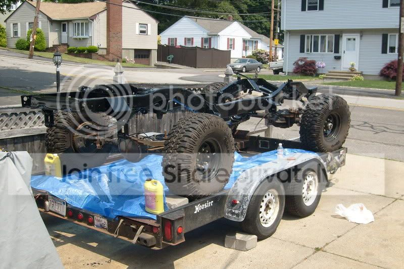

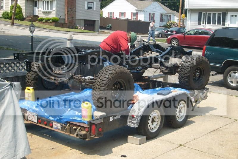

Second coat in progress, with a pic of the help. Hey, she asked if she could help, who am I to say no :p: I love my mom :o

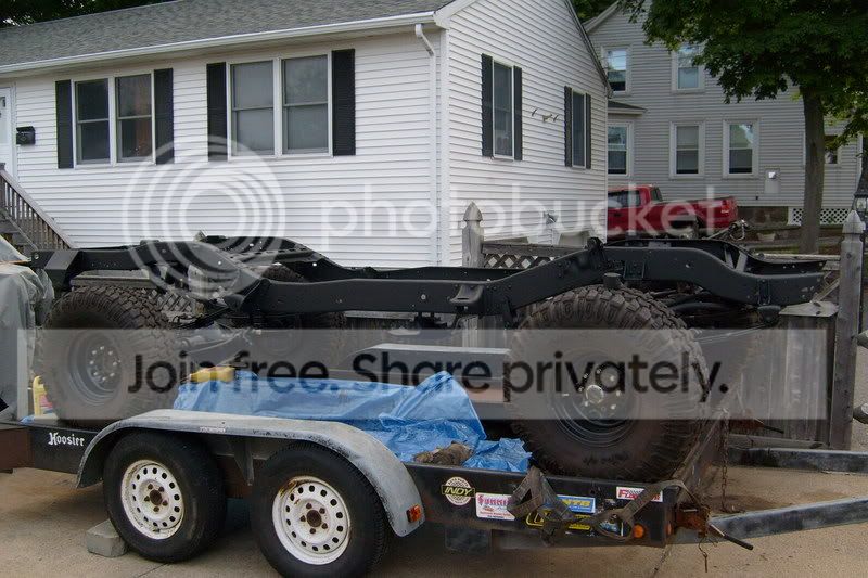

Second coat done!

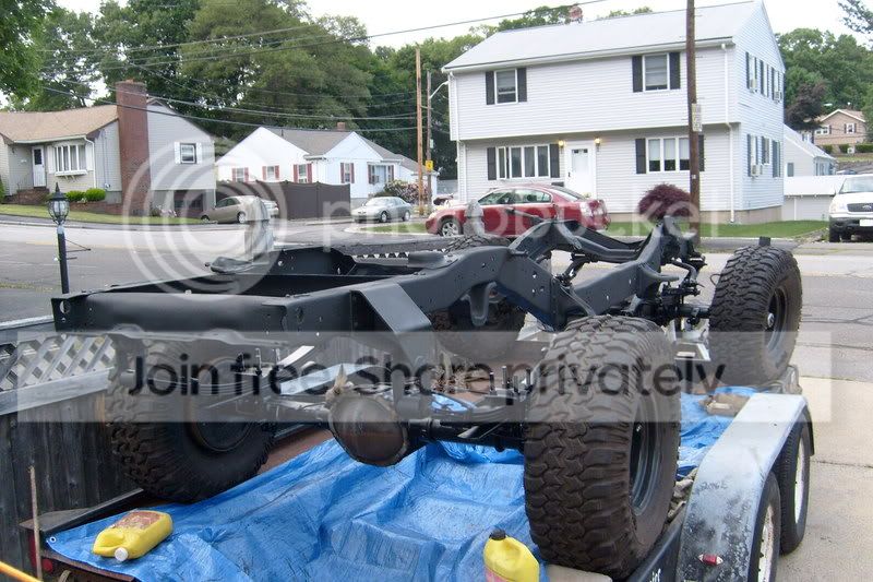

And last but not least, the flat black top coat. Even cleaned up the frame and axles a little, and rattle canned em black again.

Wow Ben! That turned out really nice. Makes me wish I went that extensive when my truck was torn down to the frame
LOOKS NICE :bow:
Now that you've got that frame lookin so good you're gonna make the rest of it too clean too like I did. hahaha. Or you'll regret not boxing the frame too like I also have. haha.
Looks like it was well worth the time and money... even though most of those areas won't see the light of day anymore at least we'll know they're clean and rust protected :)
