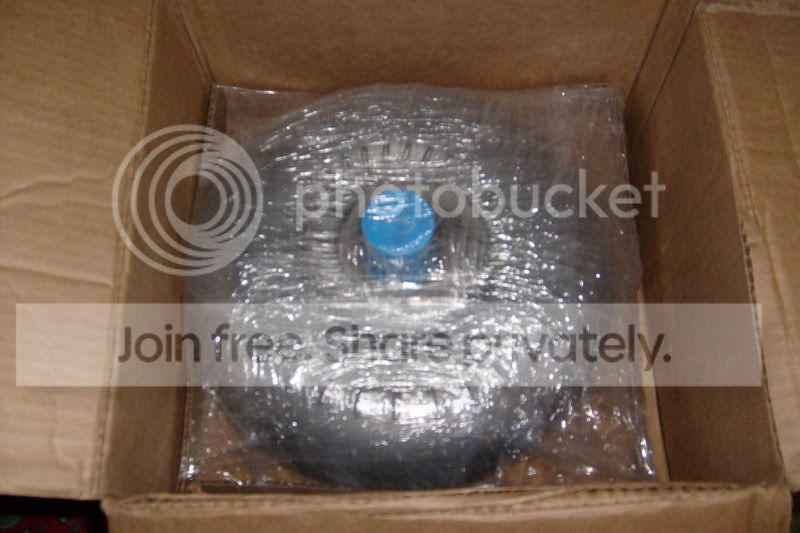

First package, from Monster Transmission, HD Low Stall Torque Converter:

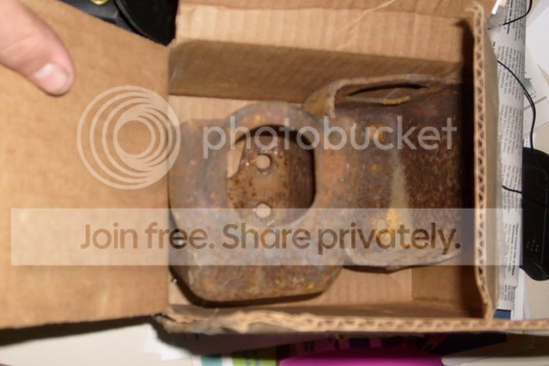

Second package, from our very own k30bb468, rad support mounts to replace my rotted one :eek1::

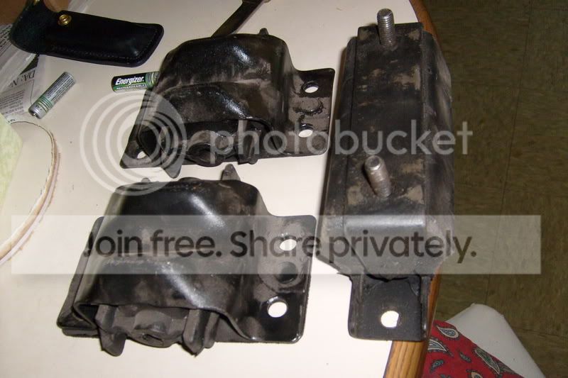

And last, but not least, the third package, complimentary, from our very own ryoken, new motor and tranny mounts!:

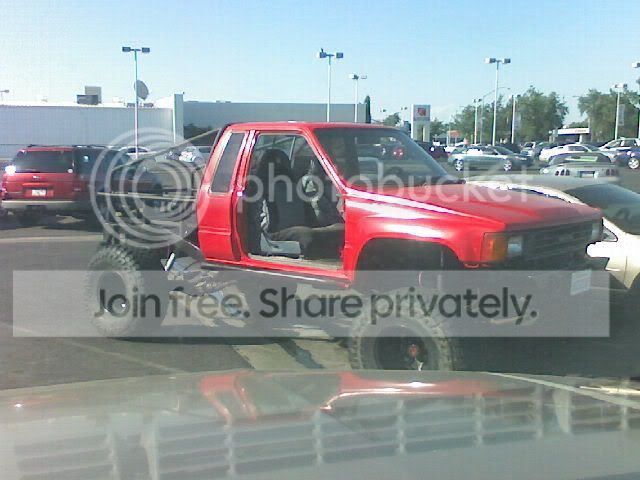

anyways here is my favorit toyota bed, I saved this a long time ago
Do you remember where he's from? I saw a 'yota at the hardware store last week that looks exactly the same... down to the cab, tube work and tires...

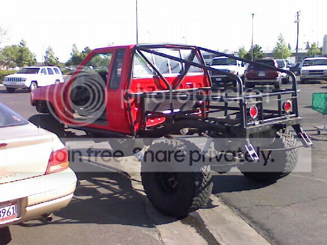

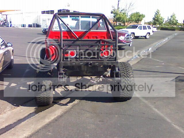

Well we're in luck... I went back to the hardware store this afternoon for a sprinkler project I was working on and to my amazement he was there (must work there)... so anyways they're crappy cell phone pics but at least it's something.
It's not quite the same rig but it's similar...
