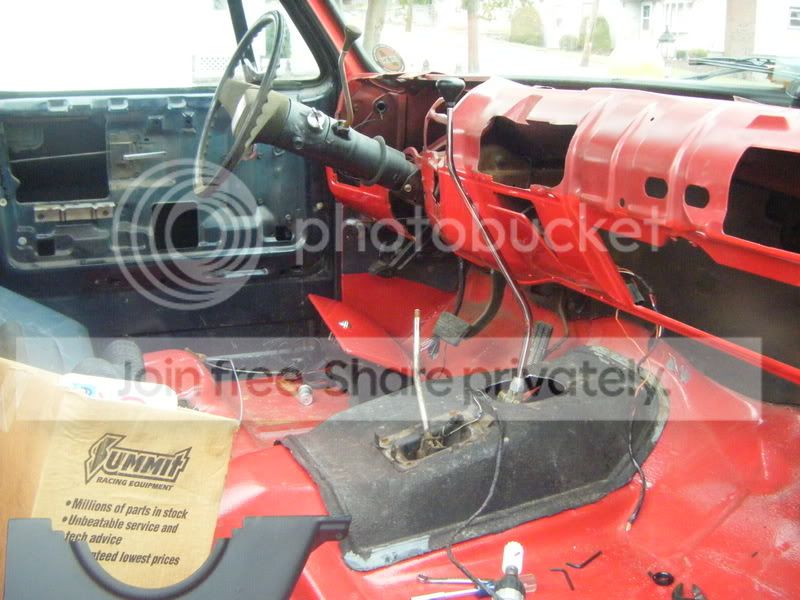

Tunnel cut out and resting on floor

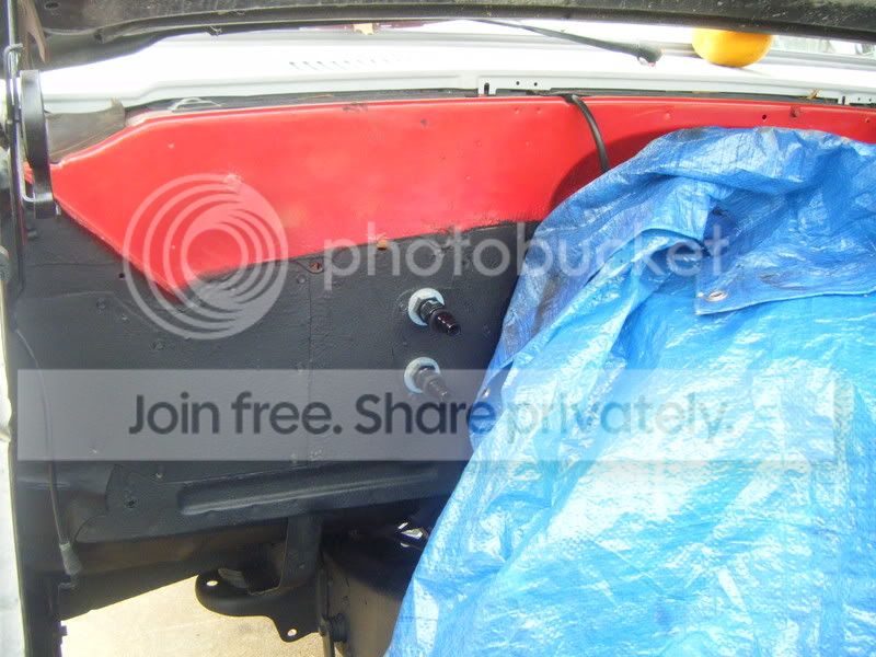

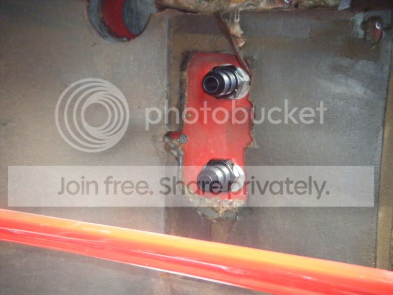

bulkheads installed

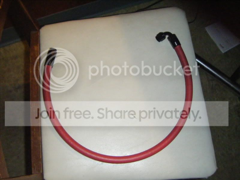

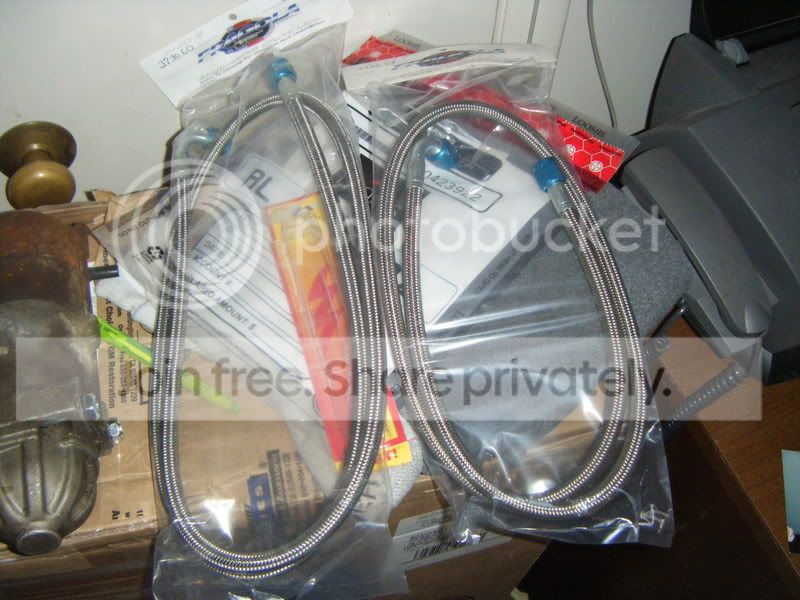

AN lines for initial runs of tranny cooling system
curious why you didn't just buy reusable ends, bulk hose and cut to length for perfect routing?
these are pretty close to perfect, for me anyways. The smaller one will allow me to work with the aux. filter mount a little. Besides, AN lines have given me nothin' but hell, hence why I bought the push-loc hose for the pump to carb line. The price would`ve been about the same just buying to materials to make them myself...locally anyways...

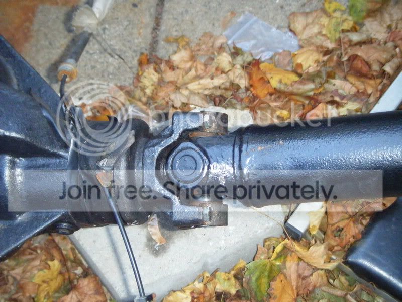

rear yoke all fixed up...had to tap the holes back out....long story short, the 14bsf is a weird axle...just because the bolt threads in 4 turns, doesn`t mean its the right thread size :crazy: metric in one spot, doesn`t mean it will all be metric :crazy:

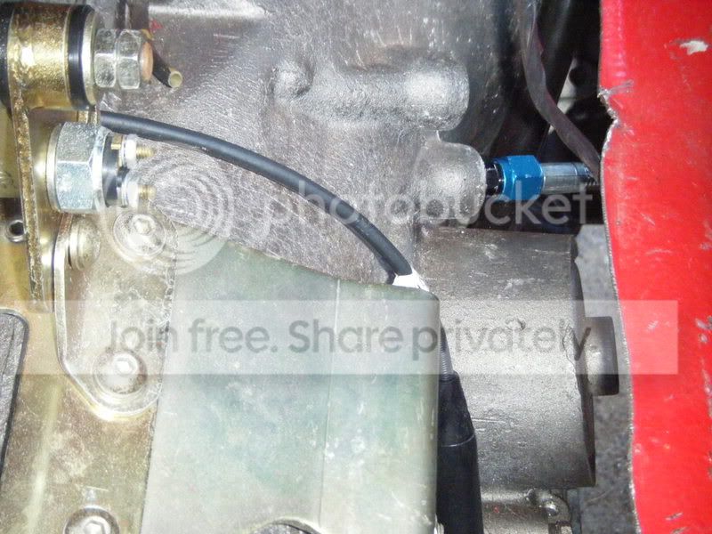

1 of the adapters with the AN line connected....still in search of the other adapter :crazy:
Almost rediculous....almost :D

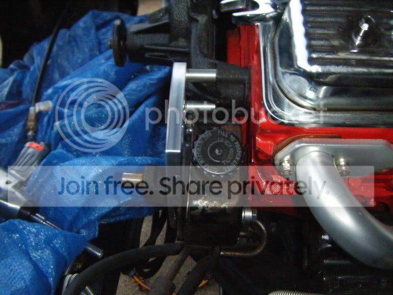

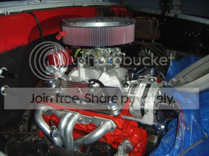

just about done putting the P/S pump on, throw the pulleys on, fuel line from pump to carb, belts, adjust the rockers, starter, power, vrooom vroom!

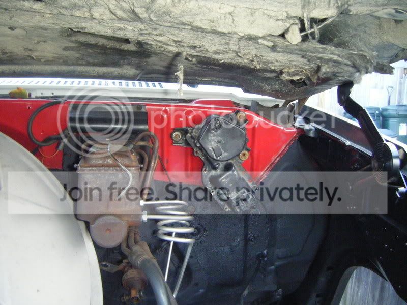

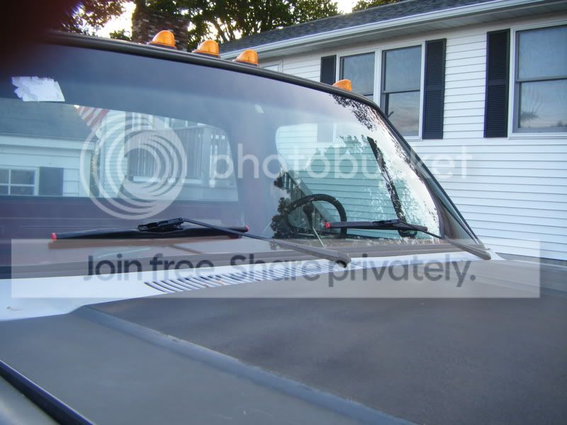

wiper motor
new wiper arms and wipers

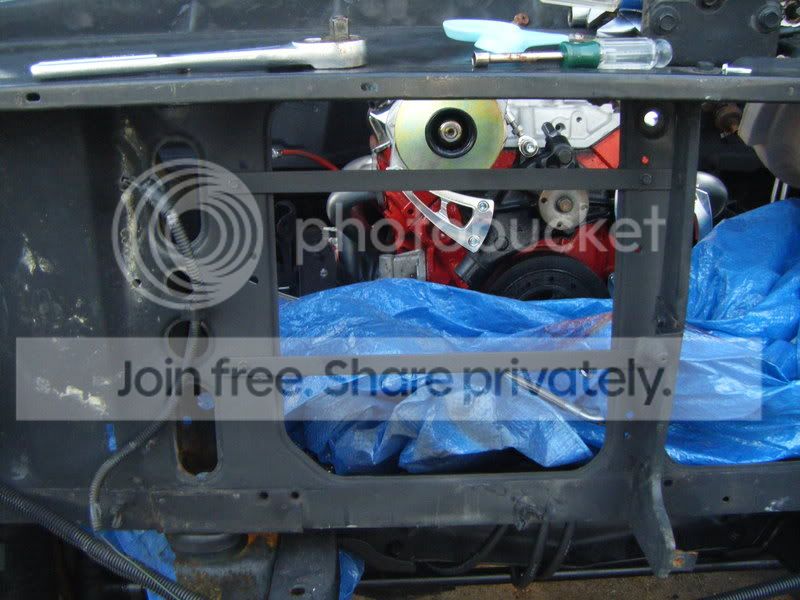

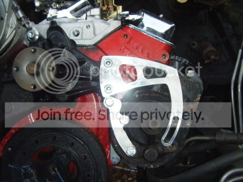

P/S in, finally! (not completely bolted in that pic)

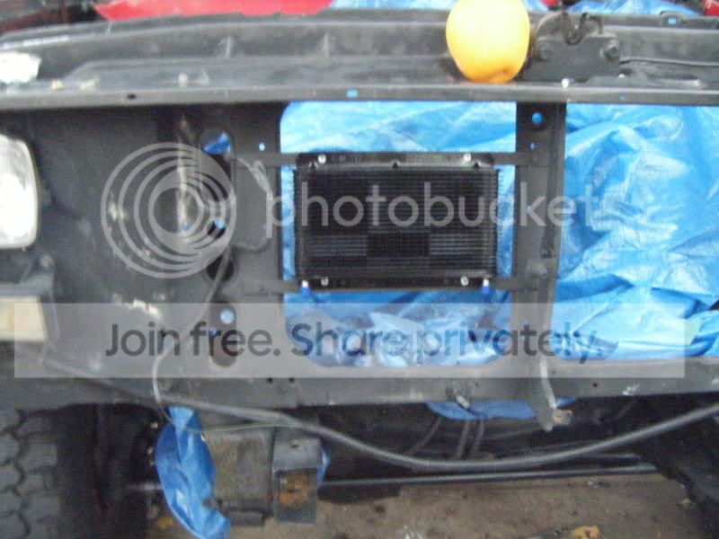

mount for trans cooler
cooler mounted (24k GVW B&M stacked plate cooler)

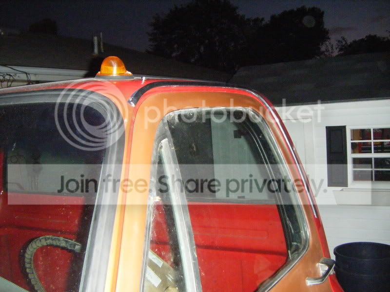

drivers drip rail on

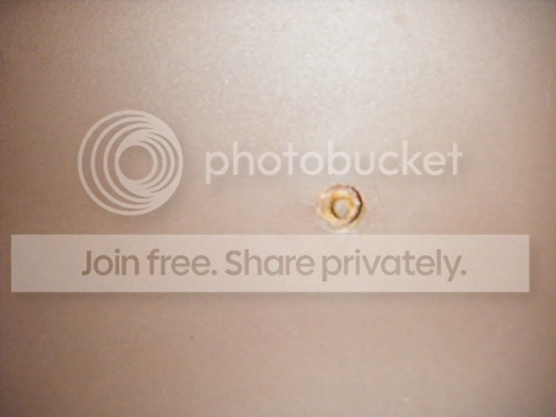

any thoughts on removing the broken fastener? Haven`t tried vice grips, but pliers wouldn`t do the trick....
