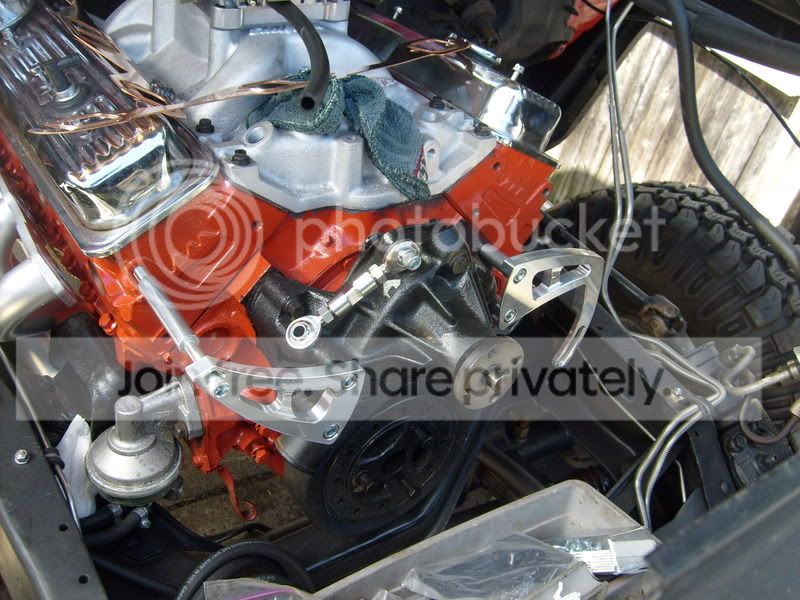

Thanks budyou can say that againLooks real good!
Yeah, pretty much. It will end up something like this:so what did you decide on for the bed?
I`m also filming a moving, "Honey I shrunk the rig!"Wow that should be interesting, how are you planning on shrinking a full size down to the size of that Toy?
Looking really good, keep the work going and the updates coming.
