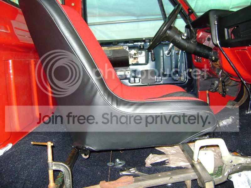

Looking for ideas. I planned on doing something similar to what Brett (sweetk30) did, but it doesn't look like that's going to work too well.
For those of you running these style seats in a pickup, how did you mount it?
Any suggestions?
For those of you that have seen the other thread about aftermarket seats and mounts, check this out.
The only difference I see, would that it would be maybe 2" higher. What If I were to just stick some angle ontop of the square tube...just like he did:
Where I'm at now:
http://coloradok5.com/forums/attachment.php?attachmentid=78199&d=1234741741
I think this'll work, as long as it doesn't make it a PITA for me to get in the truck. The stock wheel is going in favor of a smaller Grant wheel, so that will help too. It will also allow me to keep the slider mechanism in-tact for easy access to stuff behind the seats...:crazy: Going to need Kert to get the steps done for the trazer boys soon:bow:

Tell me about the seats... I know your a big guy like me. I need something better than stock. Do they come in gray(My interior color)?
Also, where did you get that t-case shifter boot(saw it in another thread)? Looks very nice..
Can't wait to see this done..
The seats were custom order from PRP, so I'm sure they have something to suit your needs. :wink1:
As for the shifter boots, Spectre brand from AutoZone :crazy:
