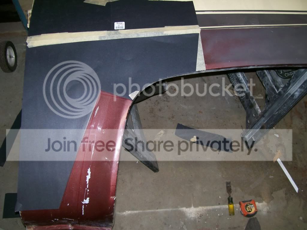

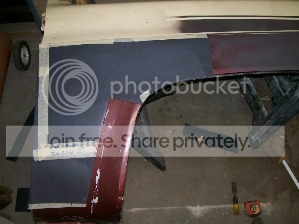

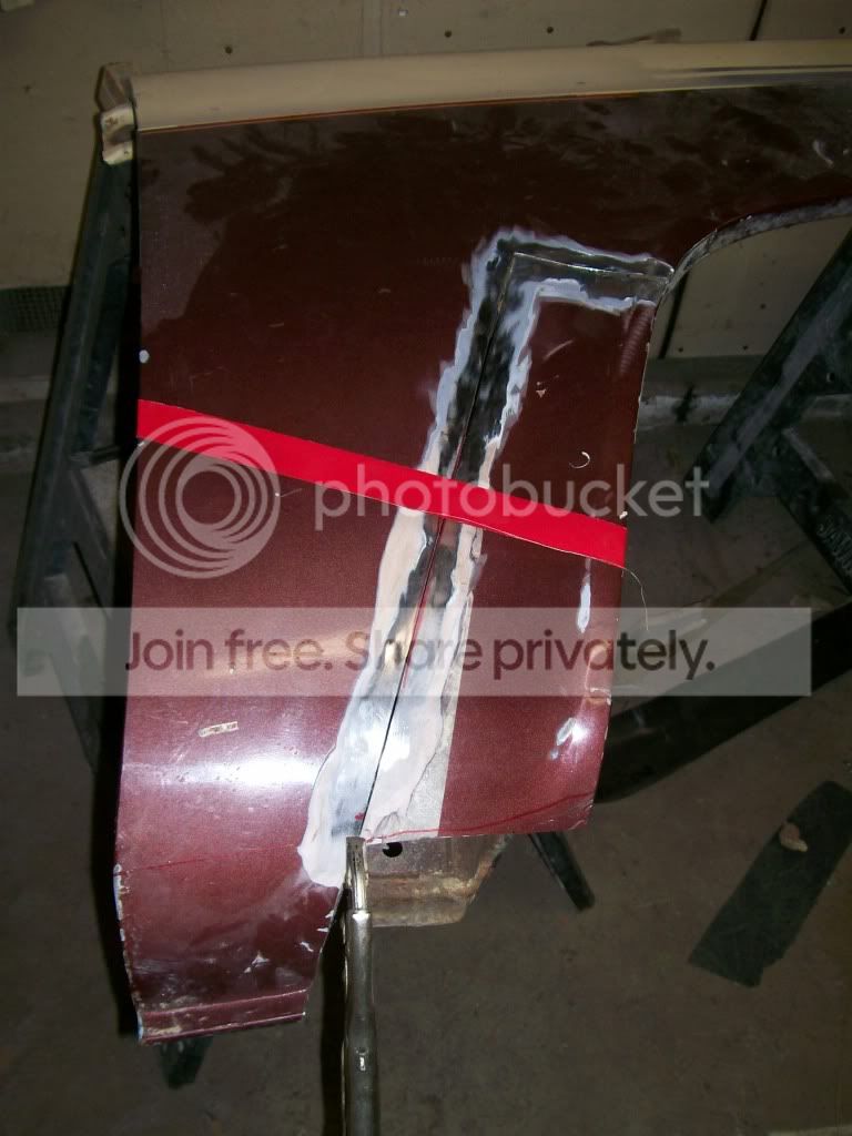

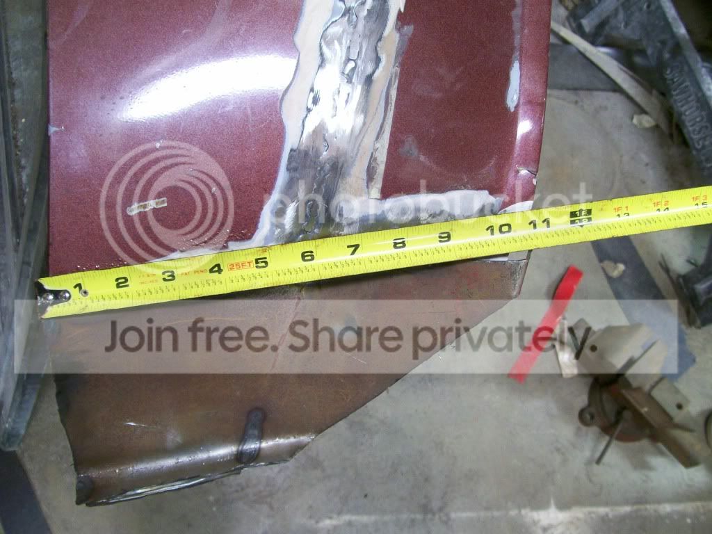

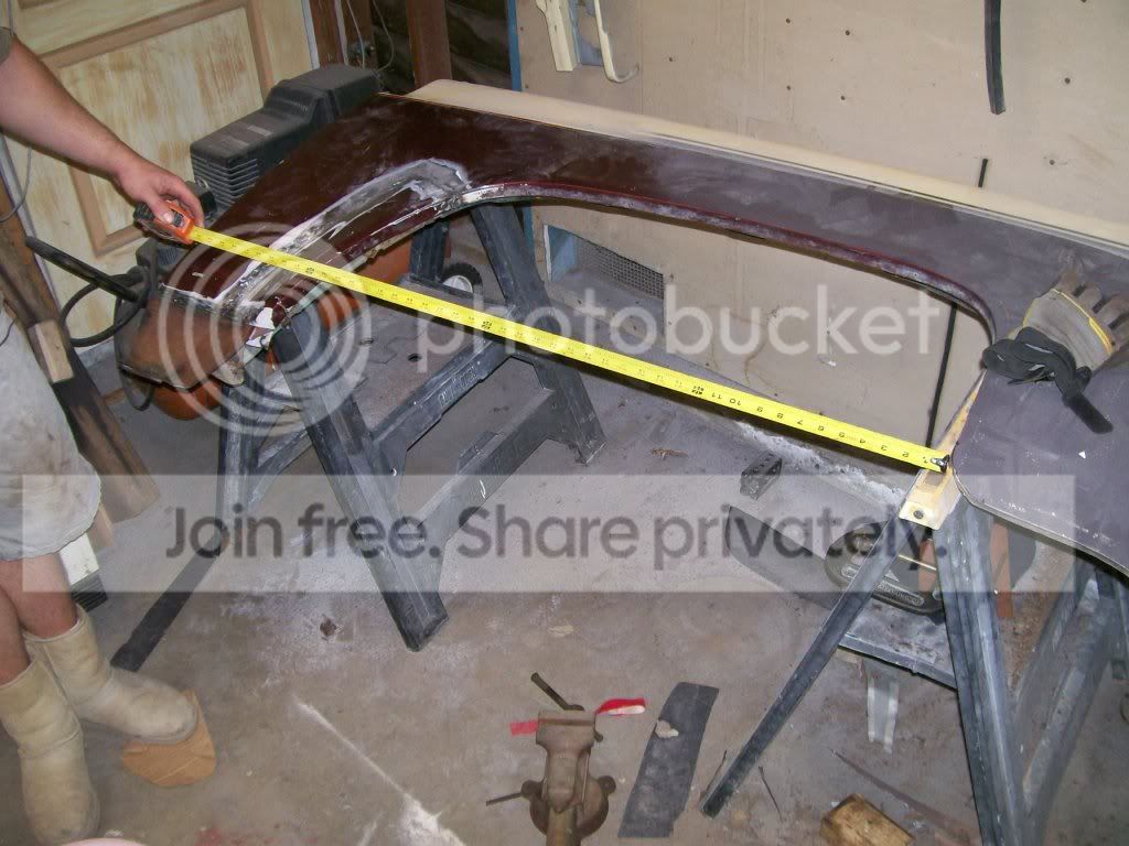

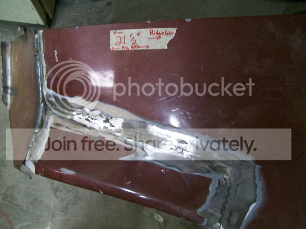

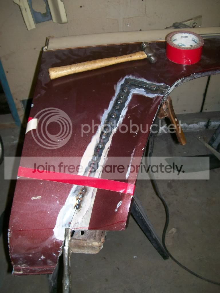

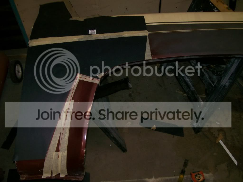

heres a more detailed rundown on the fender chop.

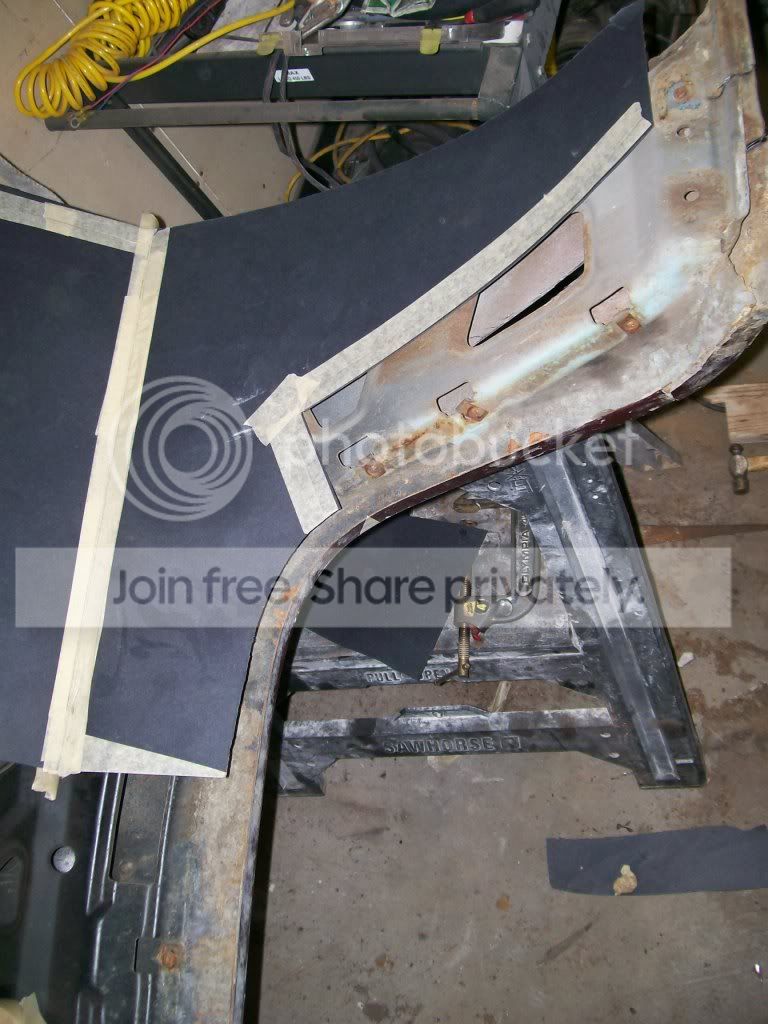

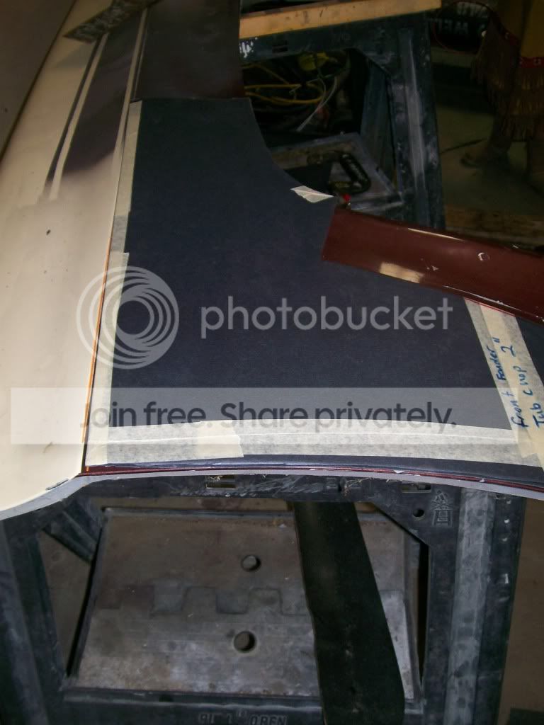

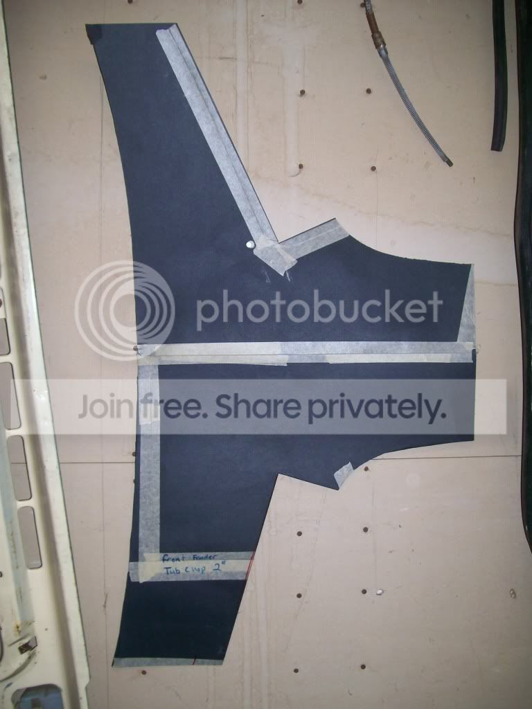

made a template 2 peice so the lines could be traced easily
starting the lay out
upper template
lower template

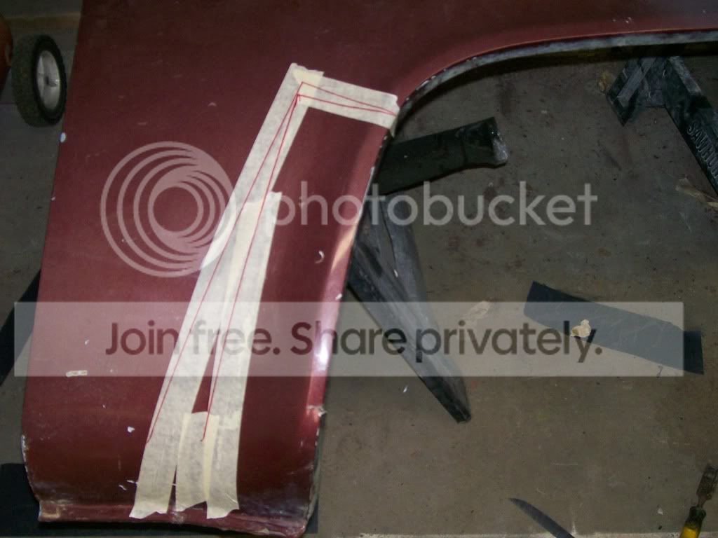

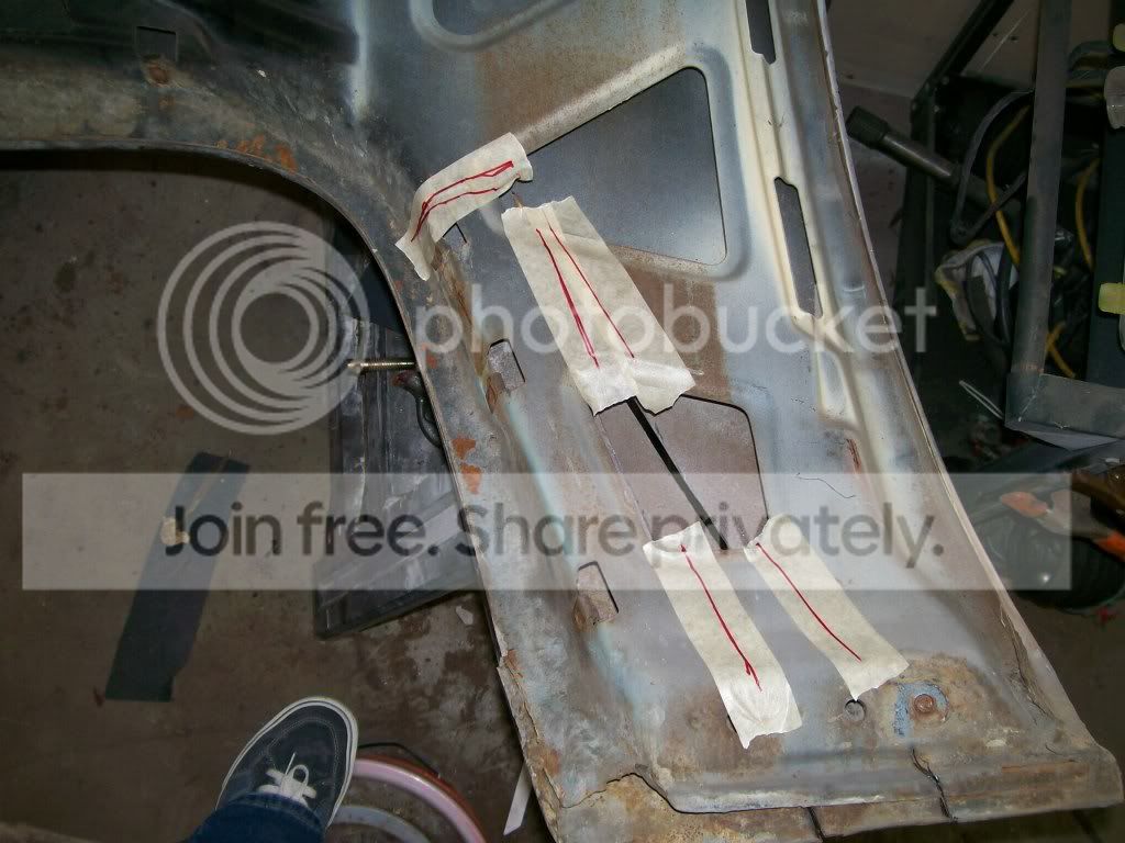

lay some tape to mark the lines

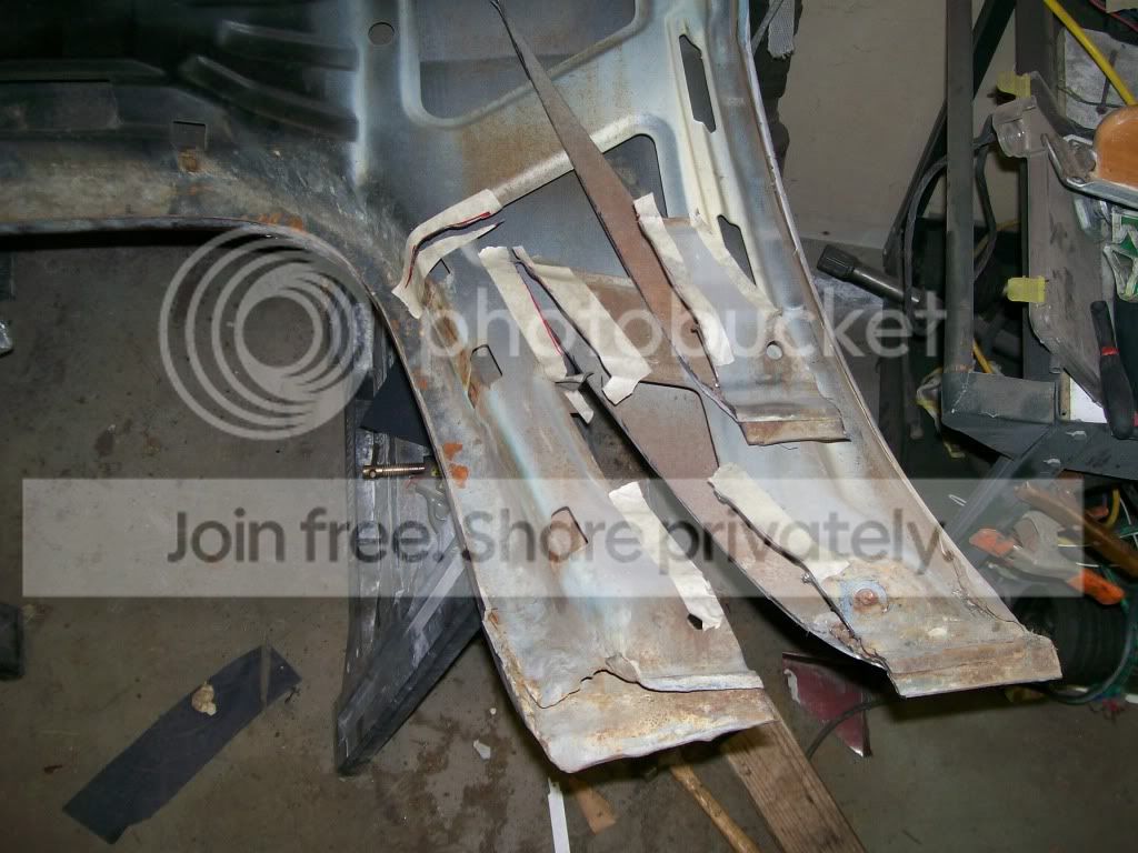

inner layout

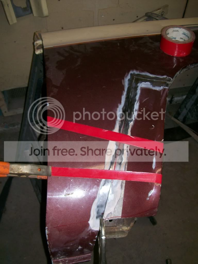

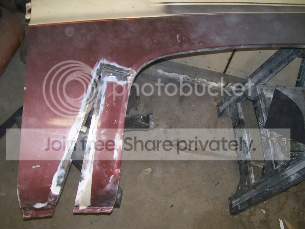

start cutting

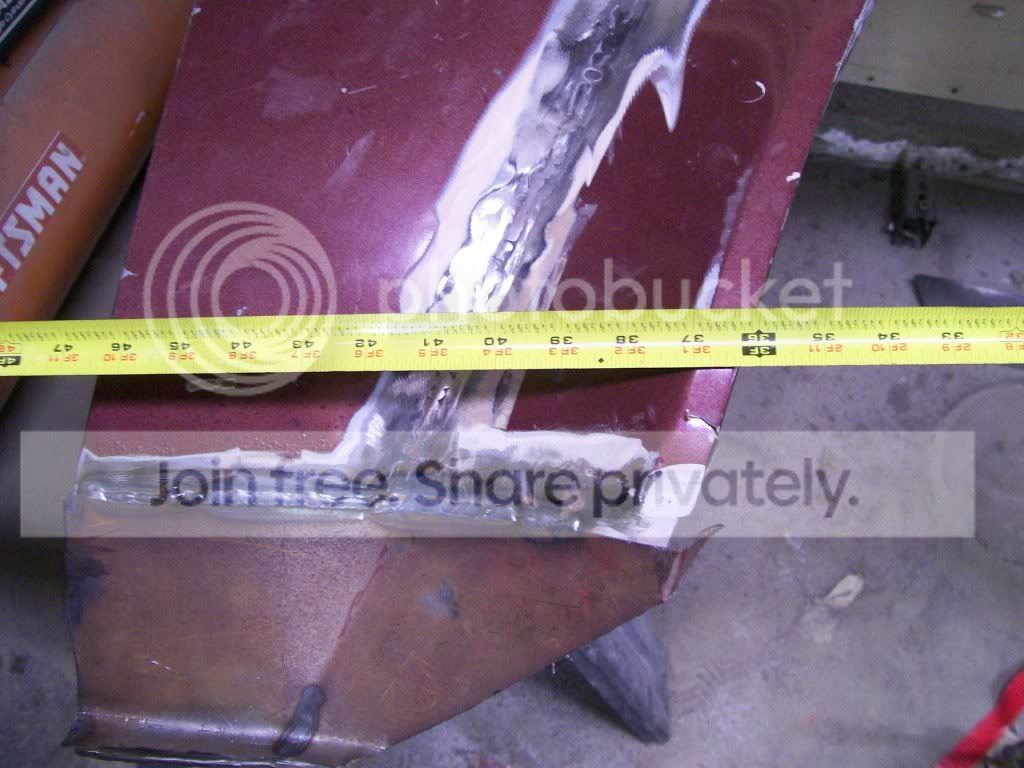

tack the backside together

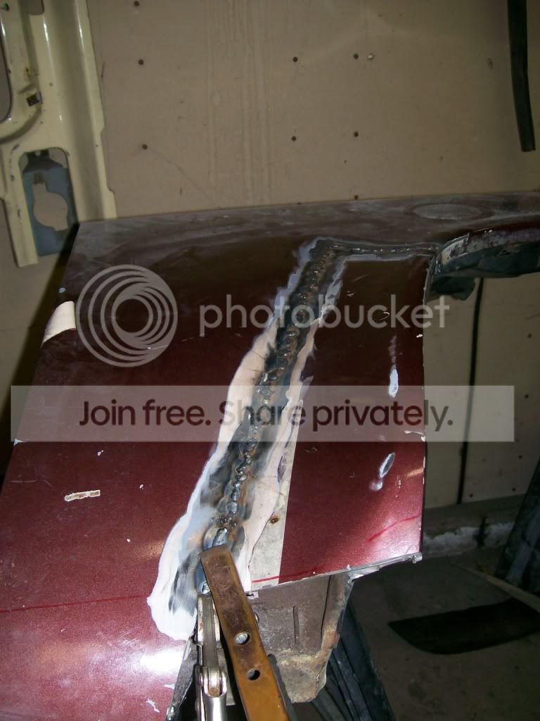

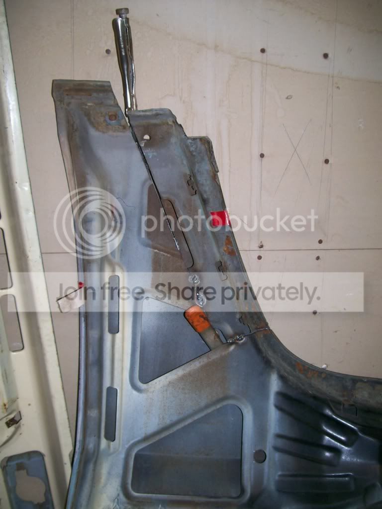

some tape and visegrips to help in the fitting process. I had to put a block inside the fender to push out a section.
tacking it up

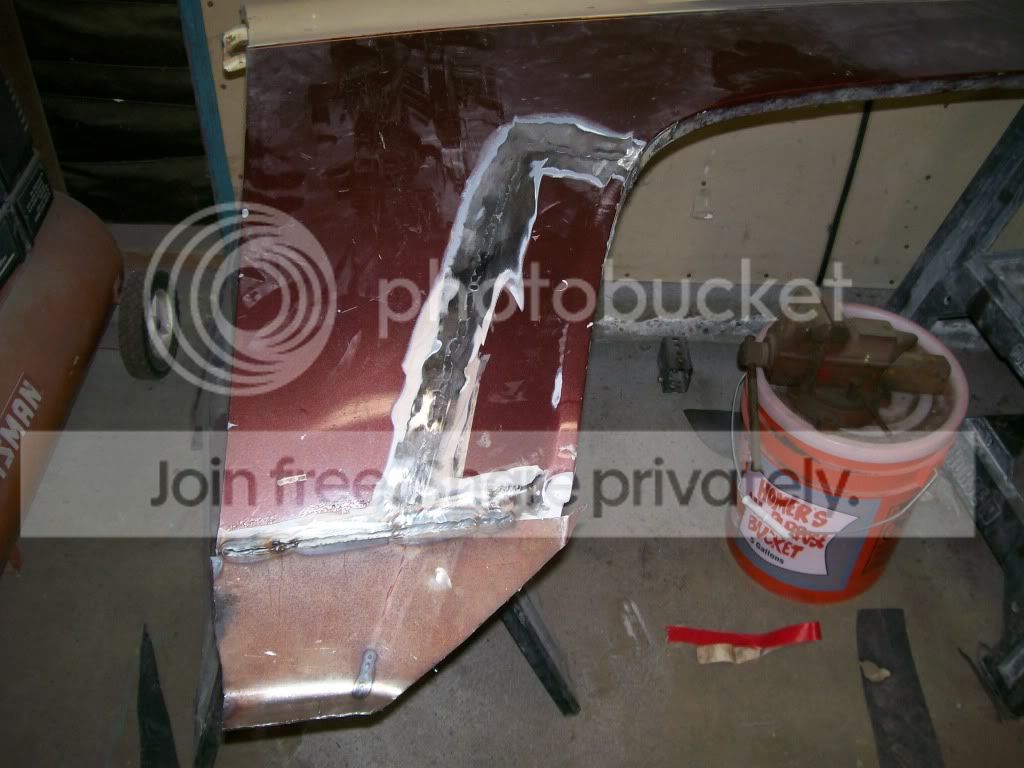

welded
I like that the fenders still have a nice shape and a factory edge. Good Job!!

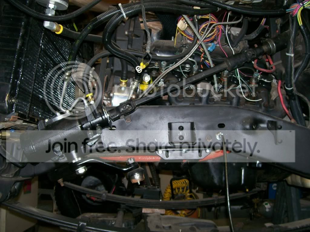

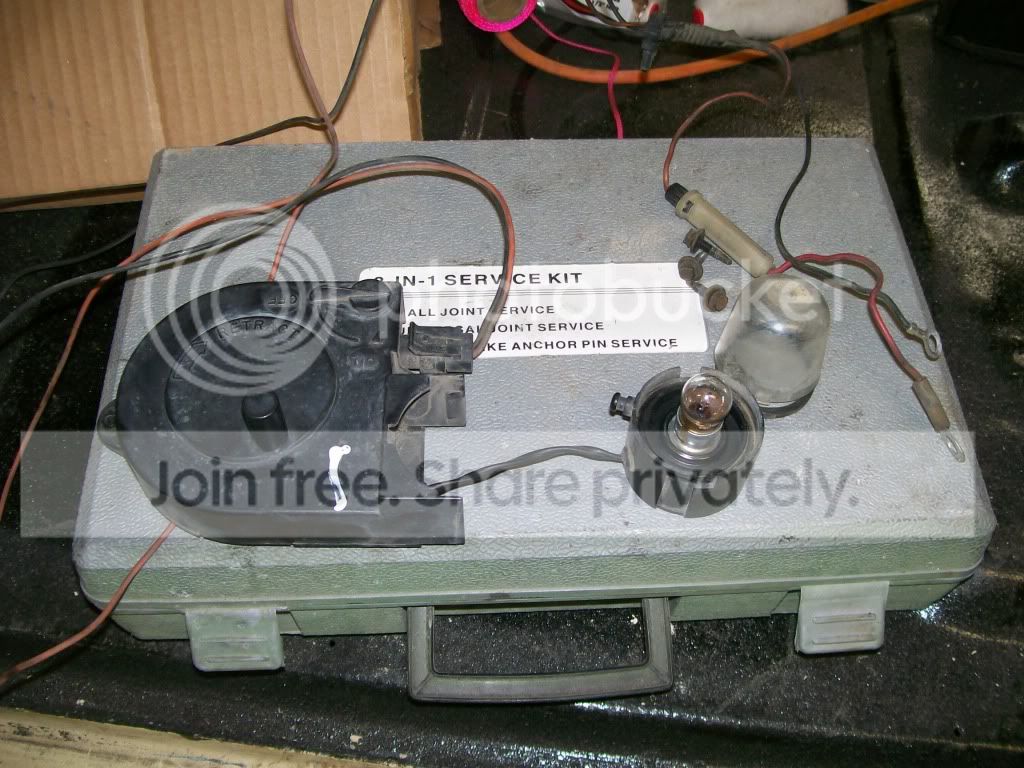

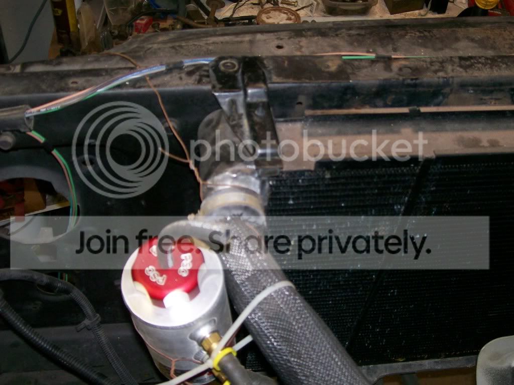

went to pick ur part and got a xj steering shaft, one of those nifty underhood lights and some brackets for the top of the radiator out of an OBS chevy
