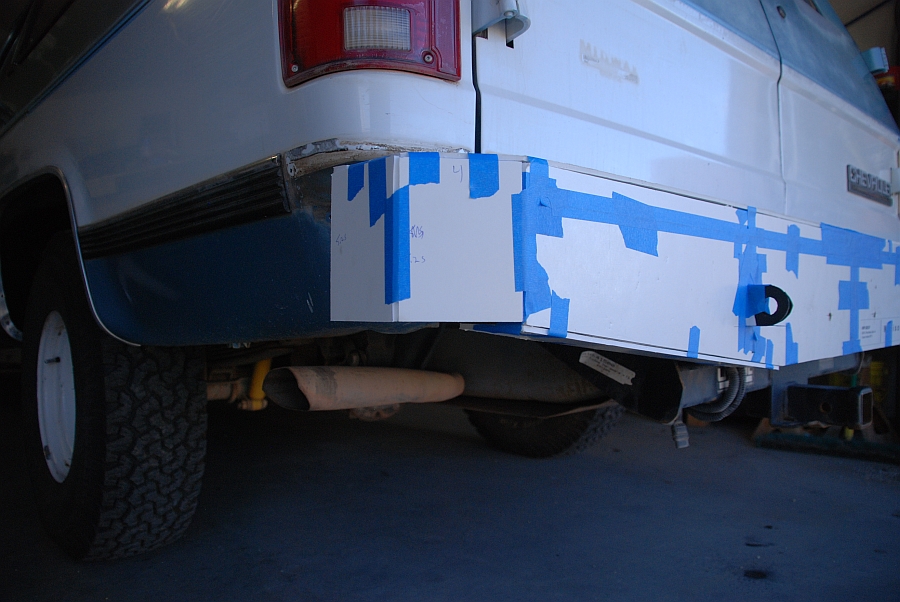

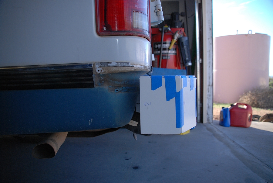

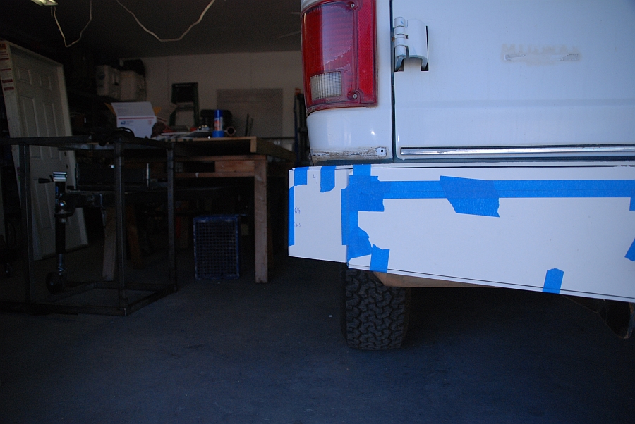

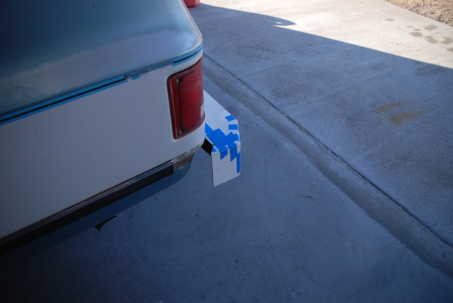

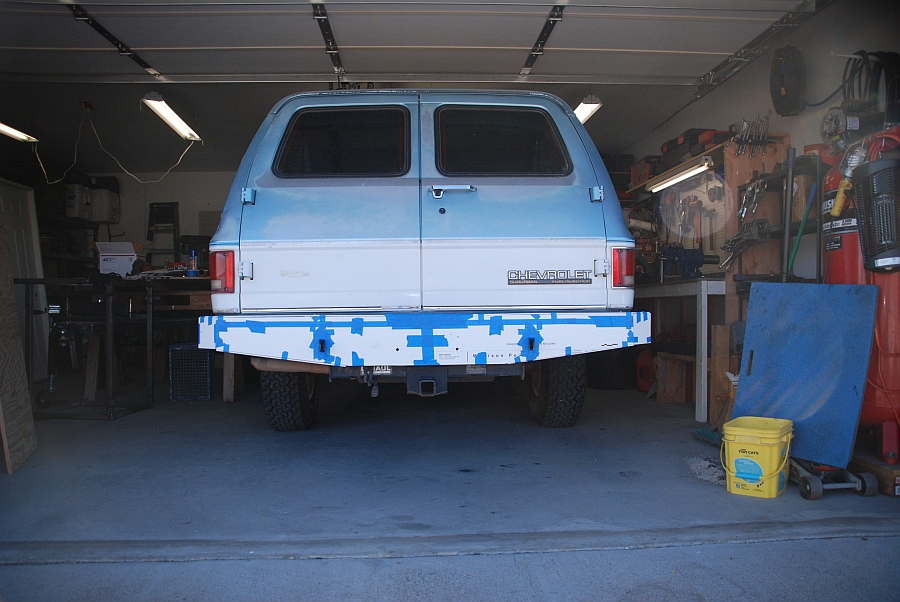

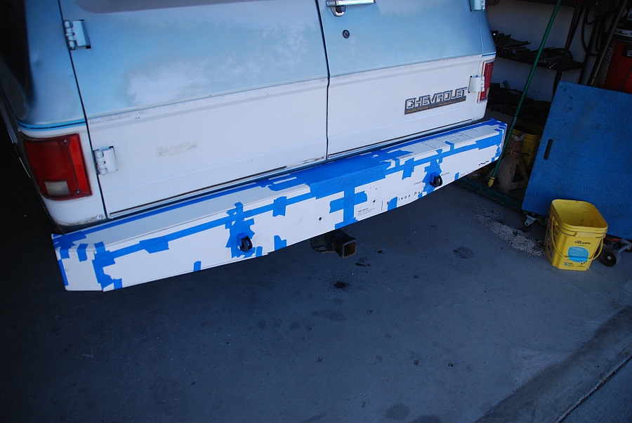

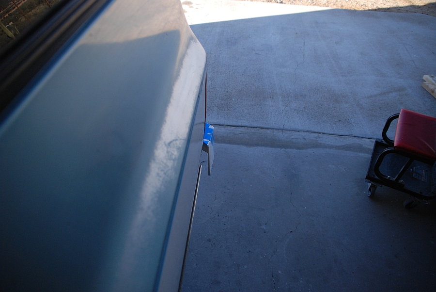

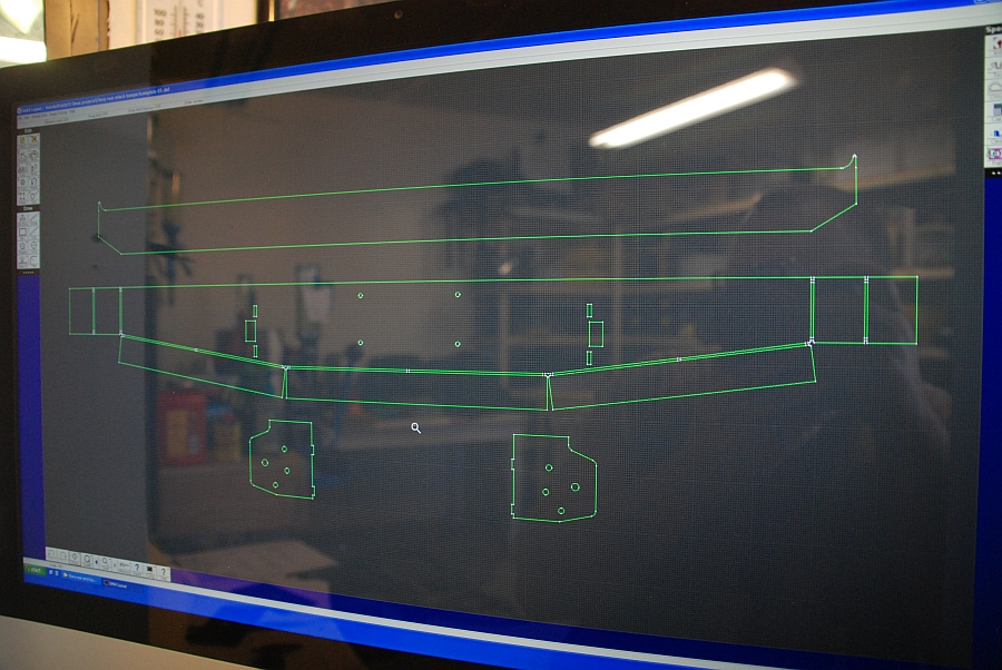

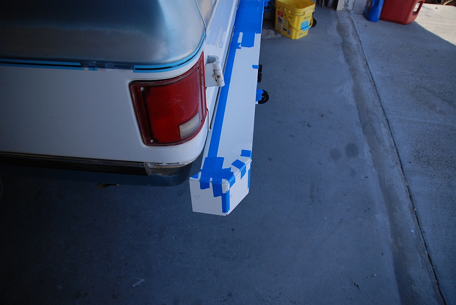

OK another re-work on the ends of the rear winch bumper. I want back to the design where they level off before wrapping around the body. I also added a inside radius to flow with the body.
It may seem tall, but this is necessary to mount the winch and I wanted the ends tall (or low enough) to protect the body. This still sticks out less then the factory bumper and is actually just as tall. This one just has more flat surface real estate.:D
I am finding it a PITA to find the right angles for the ends. The front was no where near this hard to find the lines.
Suggestions?
grab a pic and draw on it. I am up for ideas.

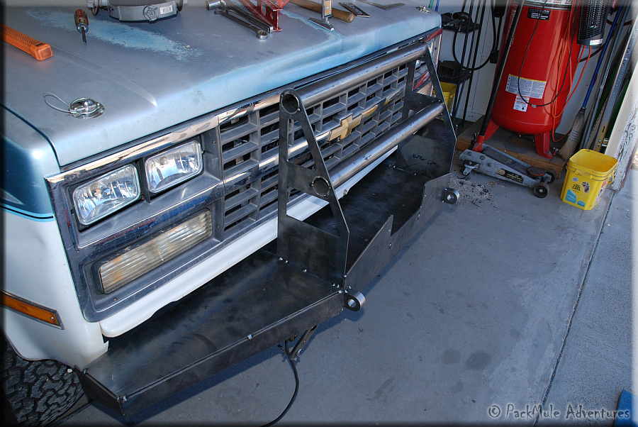

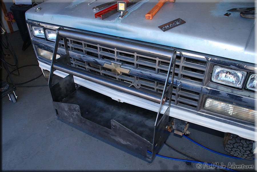

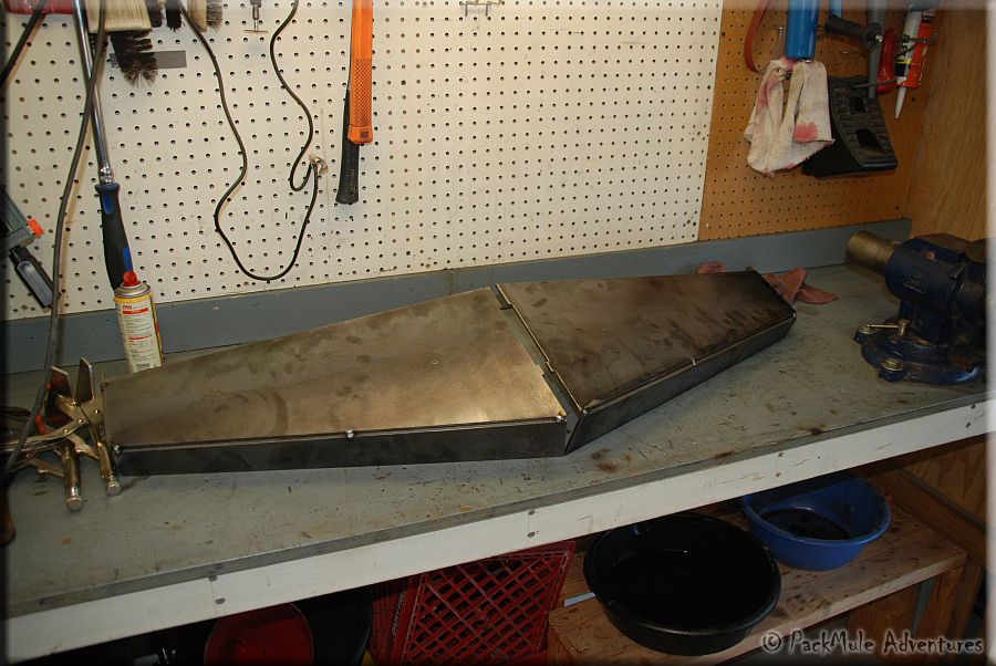

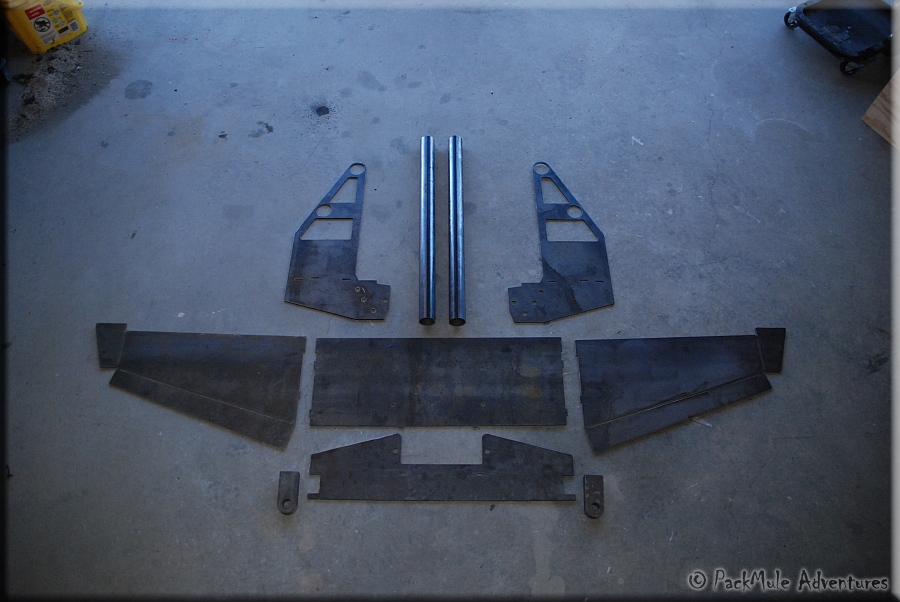

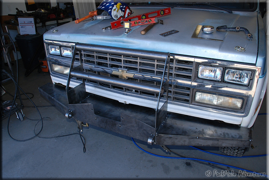

I finally pick my front winch bumper parts up today. I am also dropping off the rear winch bumper files for cuttin next week.
Its going to be a welding weekend! :woot:
