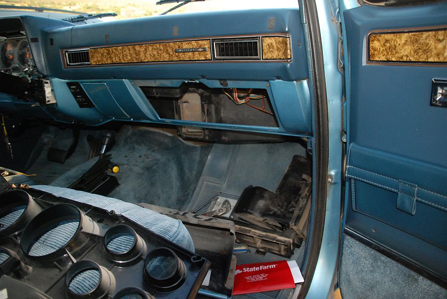

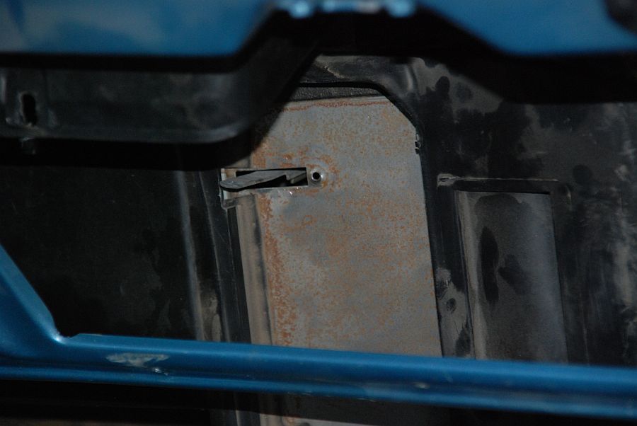

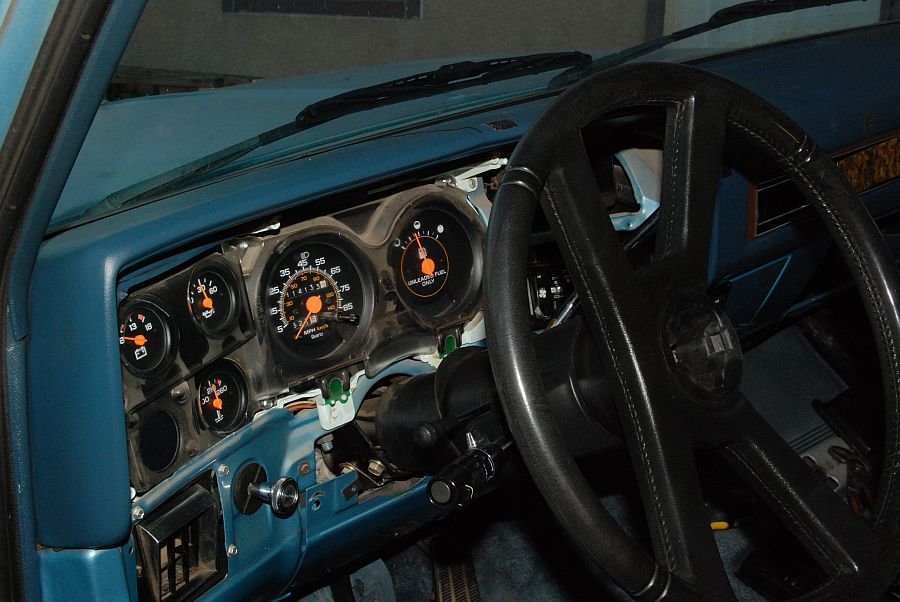

So with the heater/vent problem I have been having being that it blows thru both the vents and the floor I assumed it was that vacuum manifold behind the HVAC controller. So what do I do. I rush into it and pull the dash apart!
Then find out it was the little plastic Actuator arm price that's a common brake and not 5 minutes to get to:doah:

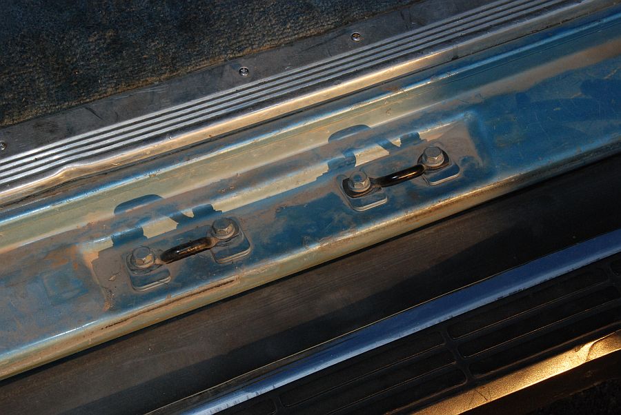

The barn doors had some rattle and found the pass side barn door lower latch bar had a notch worn into it over the years so it wouldn't secure tight any longer. I ordered a couple of new latches from LMC, swapped them out and adjusted them inboard a bit more to offer a more tight seal against the springs. It did the trick the doors don't rattle and they have a nice positive seal when closed.

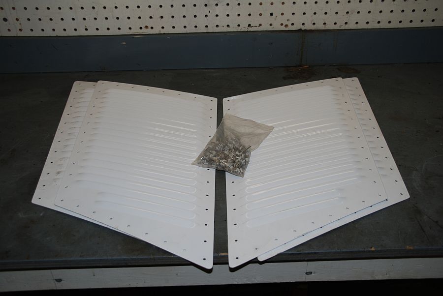

Within the next month or so I will be repainting the hood if not the entire sub. But when the hood gets doen I am installing a set of RunCool Hood Louvers from Hoodlouvers.com Thet are bit spendy but they are well proven to be one of the best ones for helping hot air escape the engine compartment. The picture shows to sets but I am only using one. They measure 22 by 11 and are powder coated white.

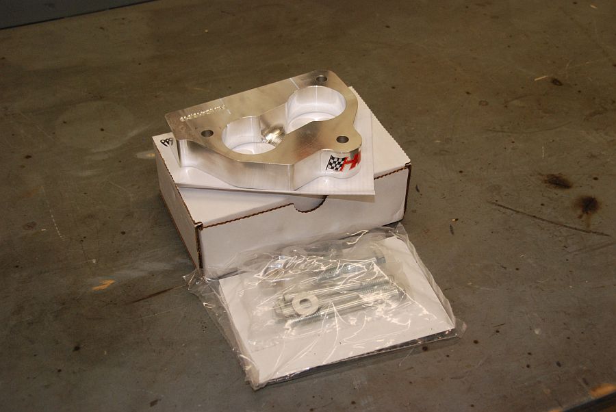

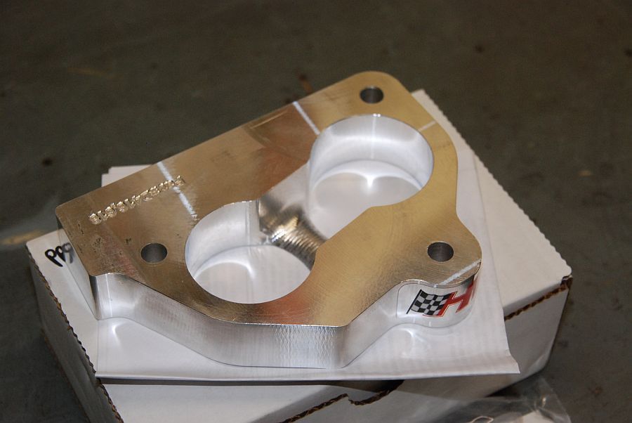

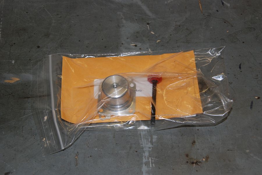

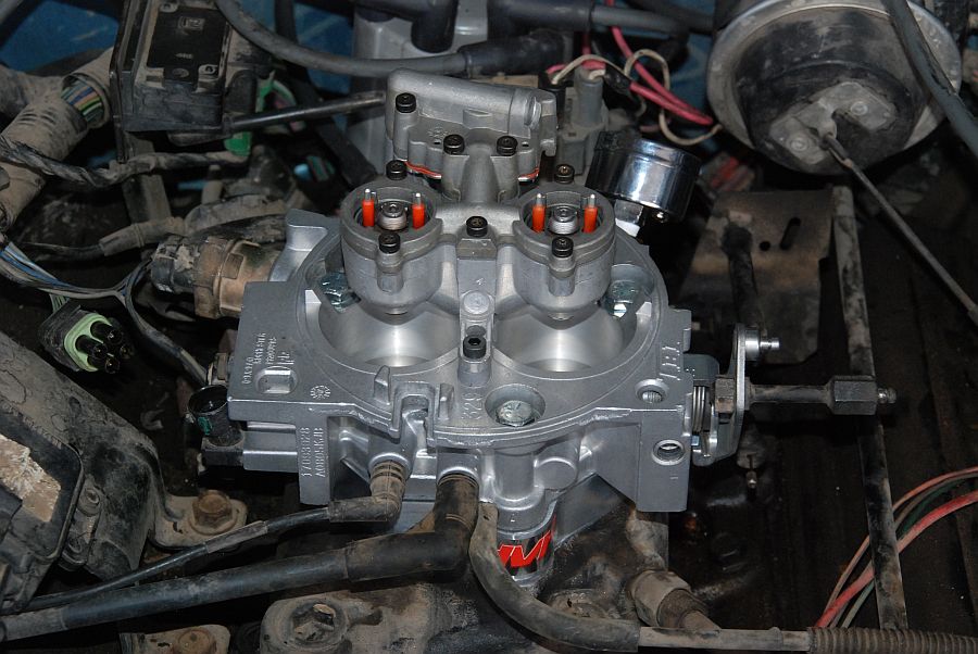

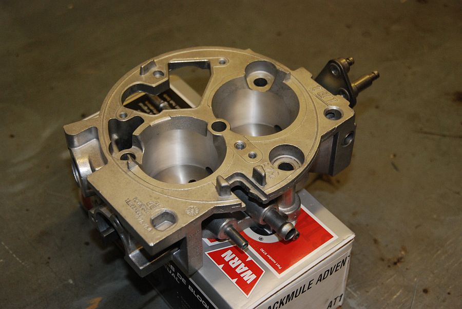

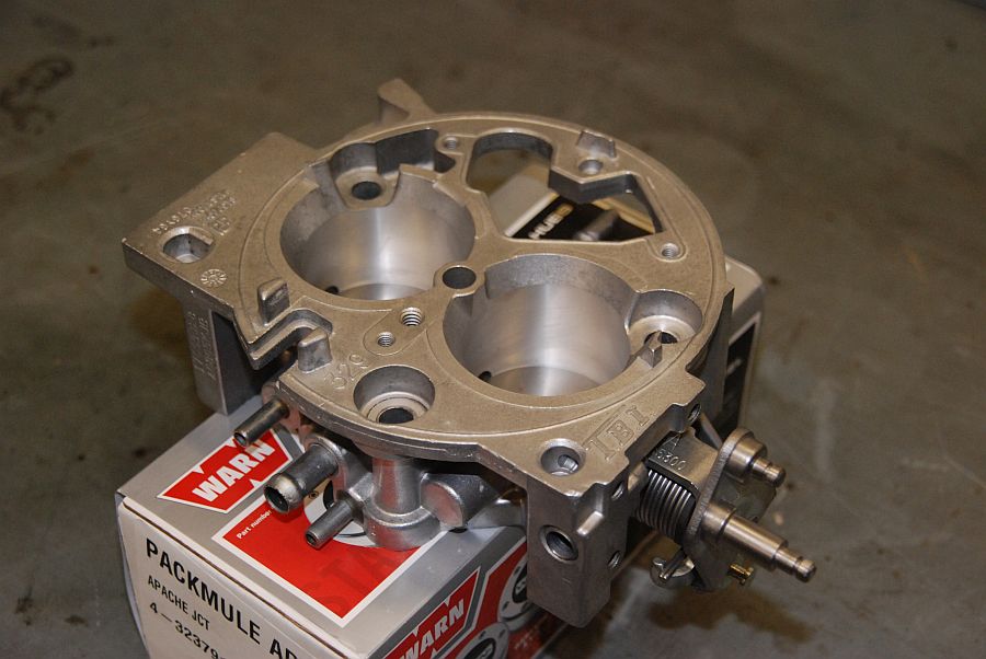

TBI upgrades from RV Morse start tonite plus a write-up for it.
Parts are as follows:

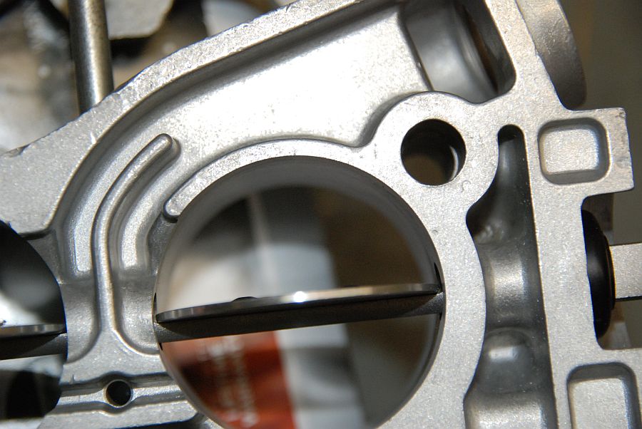

Bored Throttle body
Powerplate (Bored to match)
Adjustable fuel pressure regulator

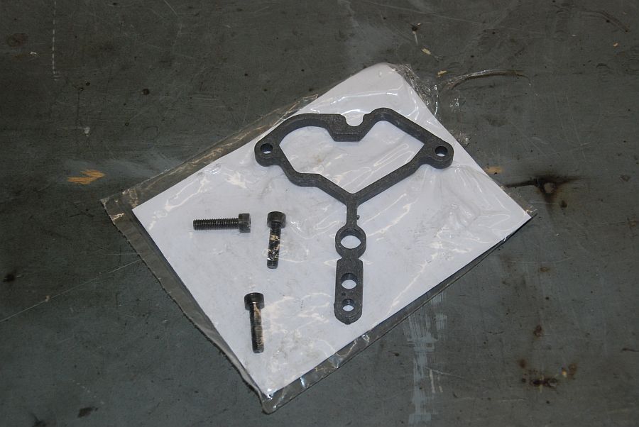

Injector Pod spacer
remanned Injector pod

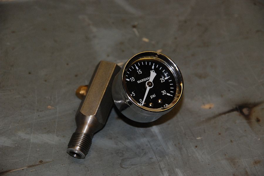

Fuel pressure gauge
Matched fuel injectors
Hypertech Powercharger (aka Salad Bowl)

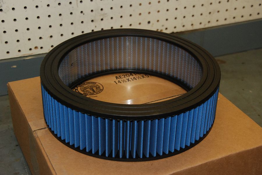

Amsoil AE performance air cleaner.

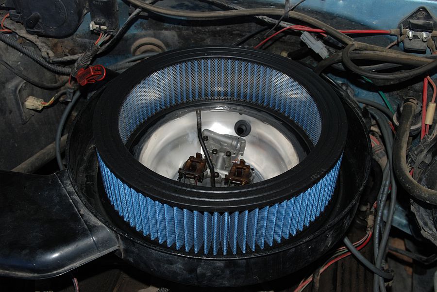

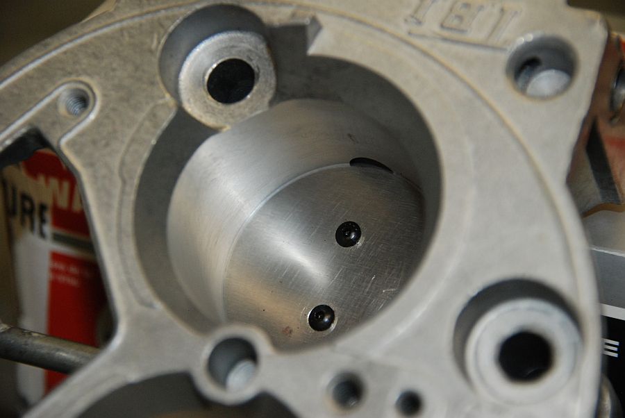

Will have to finish it tomorrow. It runs, Its just the stupid throttle cable is a hair to short and high idles. I am using the supplied spacers but its turning out to be the biggest PITA in this whole project.
Sore, sweaty and I am pretty sure I bled into the TB. I know my DNA will forever be cooked onto that intake!
Had to modify how the coil sits so that adds to it when its on the same bolt as the spacer.
Ok Good news. The TBI project is done!:woot::woot:
I just need to modify the air cleaner for the salad bowl tomorrow morning and that's it.
