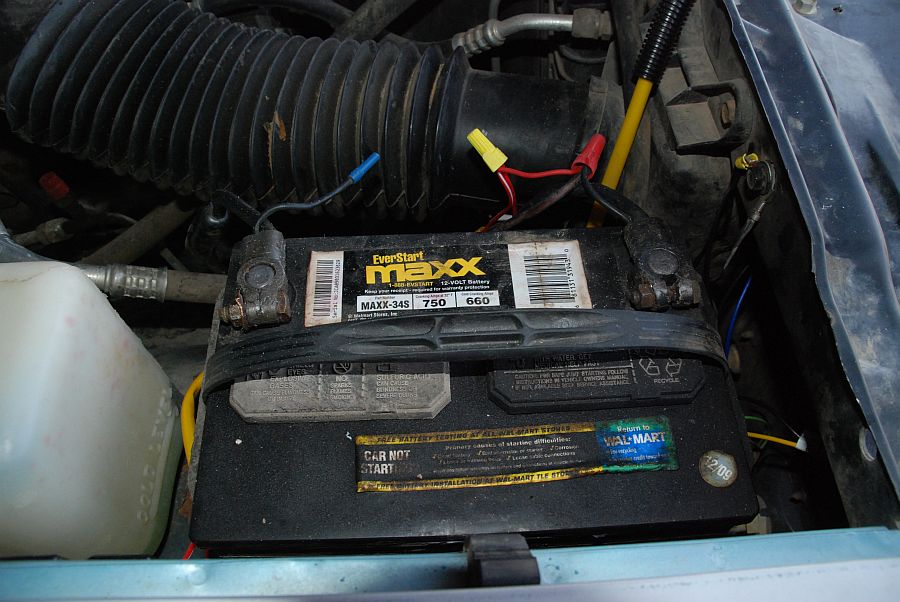

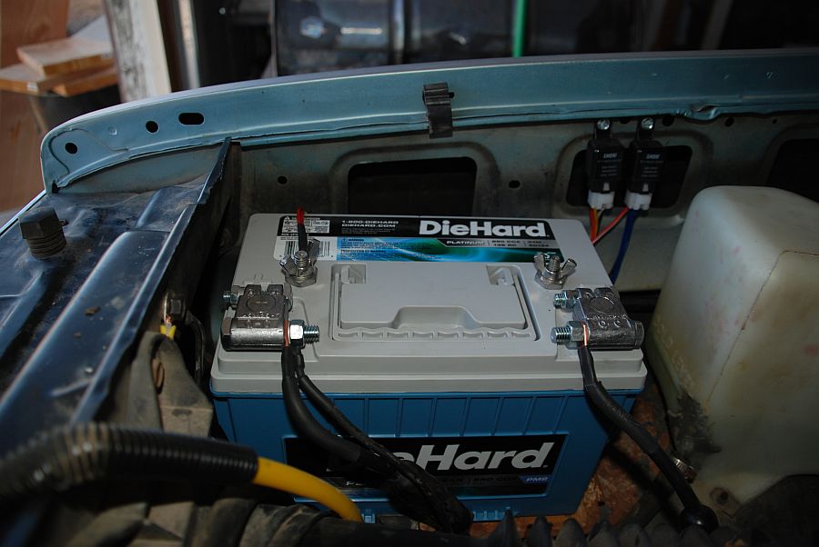

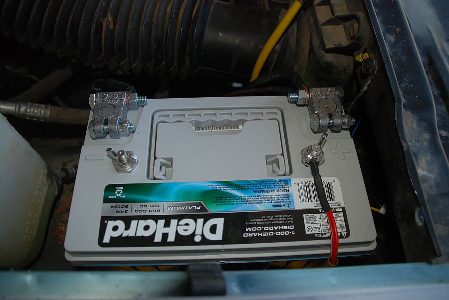

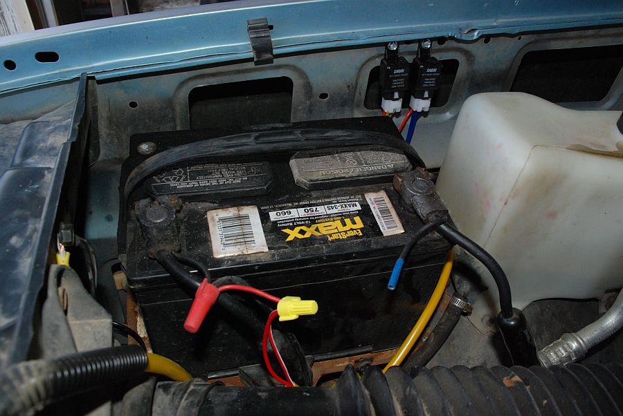

Battery upgrade and clean wiring.
Installed a Marine Deep cycle AGM battery which is made by Odyssey Batteries. Used military battery clamps and redid new battery cable ends with waterproof shrink tubing.
Before
After

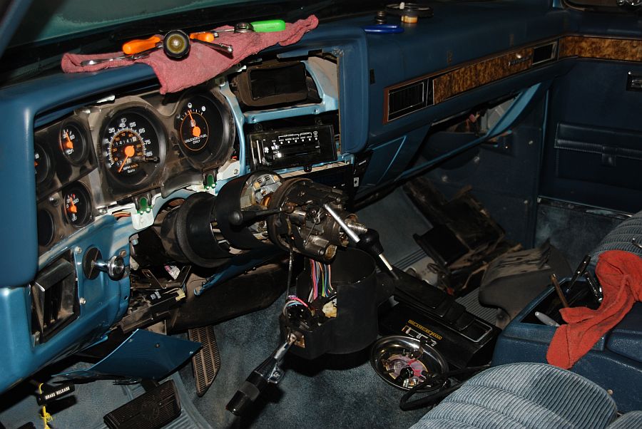

Well that was an exercise in futility:angry1:
I loctite and tighten the 4 bolts that were in fact loose! I reassembled it and its still loos int he exact same way. I think its in the tilt ball joint its self maybe.
