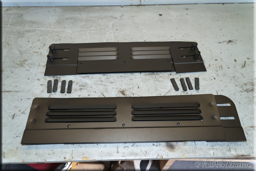

those vents don't look that hard to make, other than the louvers...wonder if a baffle of some kind would work...I like the idea of secure vents..

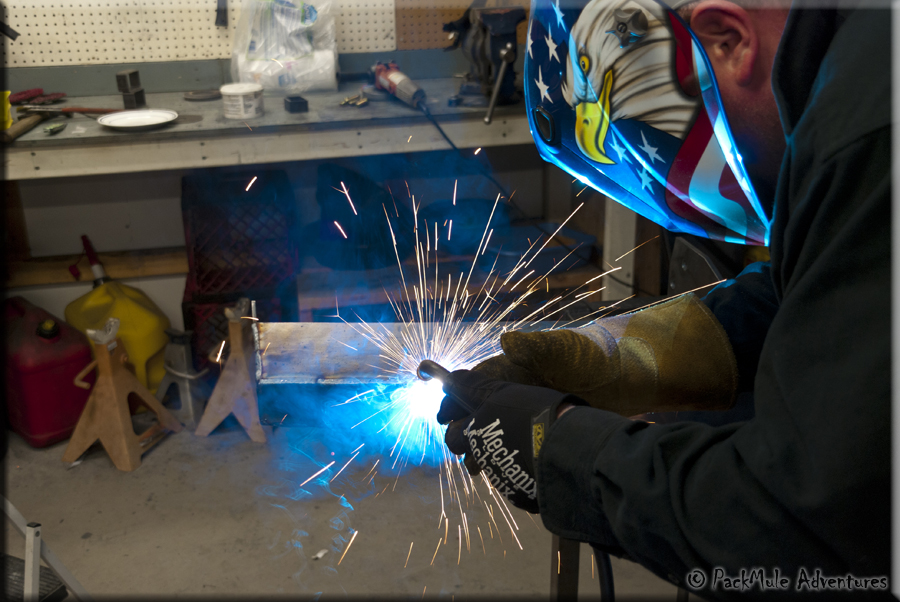

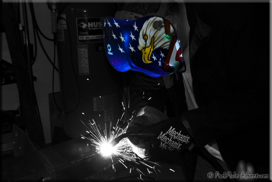

Welding the expedition bumper together. Wife took some shoot while I was busy, didn't even know until she told me. Enjoy
