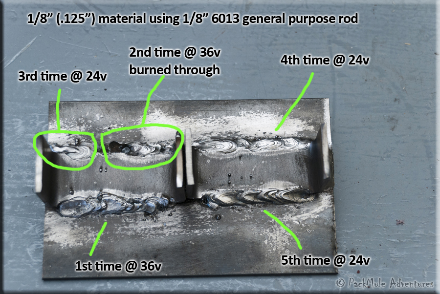

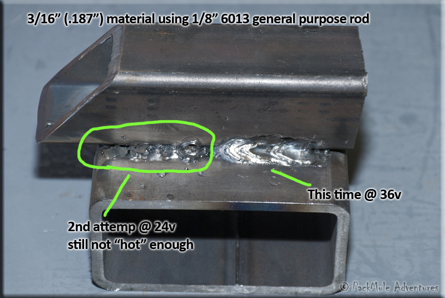

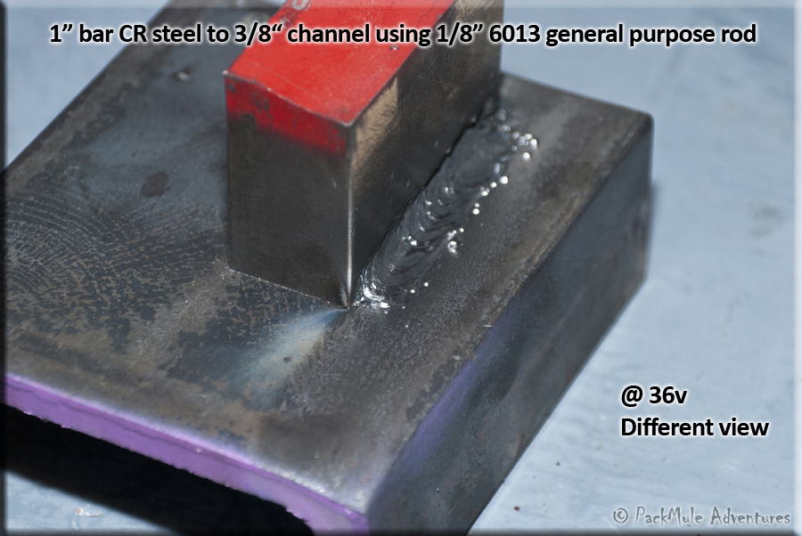

I have never been able to find an answer and I dont think there is one. WAY too many variables in play for how much you can do before they are dead. Type and age of batteries, how much of a charge was in them. are you getting good strikes, are the rods damp and so on.
It is my guess that you should be able to fix what whatever broke in two to 3 sticks and get you home or maybe keep going.
That makes sense. And yeah if you can 3 sticks out of them and still keep going you should be fine.

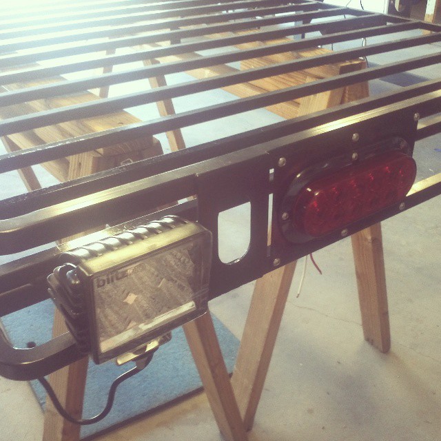

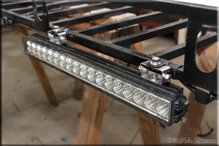

Awesome! Can't wait to see what shots you get with this. And the roof rack is looking good too, I want to see it mounted. I'm thinking of doing the same thing with some red LED's like you have for extra tail/brake lights.I have been a bit side tracked lately with some new video equipment!
