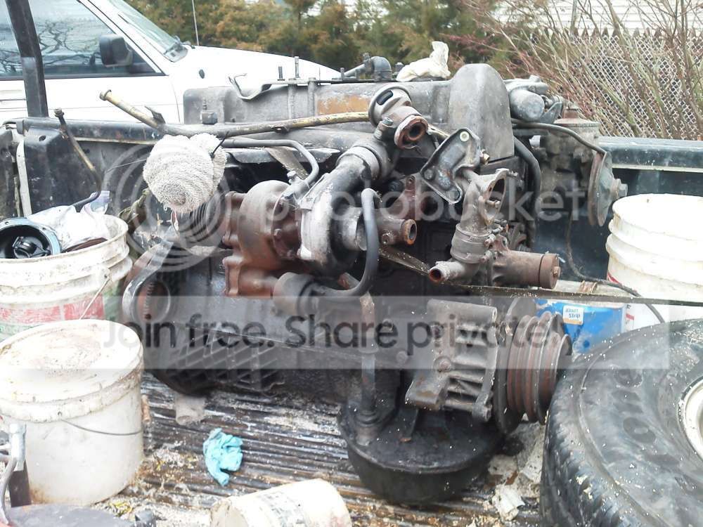

Picked up a motor today. $300 for a dressed OM617 Turbo with 180,000 miles. Sounds like a lot and Im still getting used to that being low mileage but these things dont start getting tired until 300,000 plus.
Got lash the valves and run a compression test and then start it on the floor this week. If the compression doesnt come up good I'll use this motor for parts and mock up.
Im excited to say the least... :woot:

Its from an 80-85 Mercedes 300td. 5cyl, full mechanical, 125hp 170 ftlbs.
Stock pump tweaked, more boost, intercooler, and injector nozzles will give you 150-175 horse and around 225 ftlbs. That's my plan. If its not enough I'll get a pump built which with a bigger Turbo could do 300 HP plus.
From what I've read this motor is way peppier with a stick behind it alone.

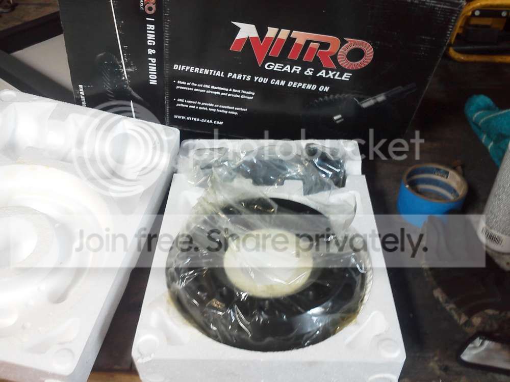

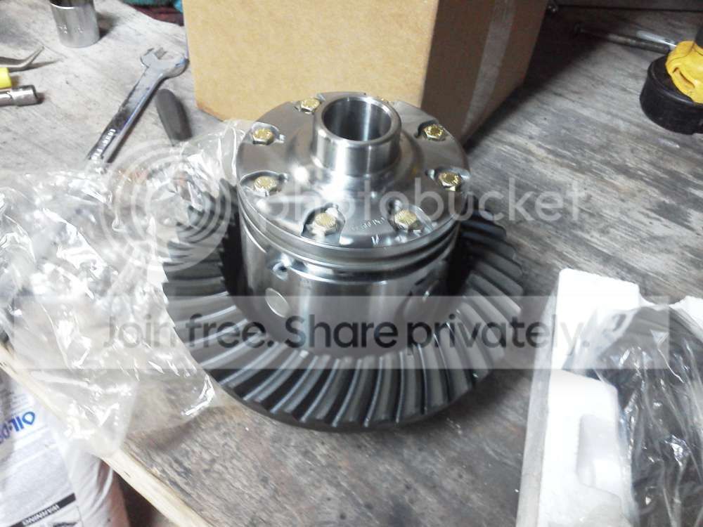

Parts started coming in to build the rear. Got my gears and locker. Install kit should be here this week and hopefully Ill be getting one of the 4 super 88 kits that will be coming into stock at superior this week.
Bad ass box...

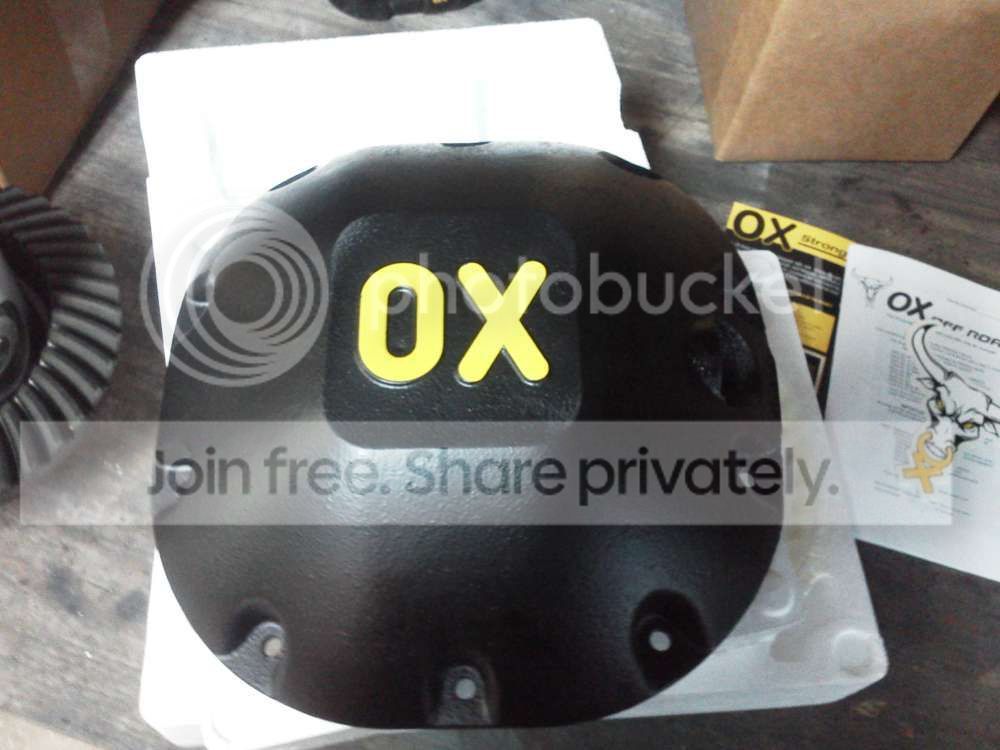

Can check upgraded diff cover off the list too.
Im going to be running the ox with their electrical actuator system. Really dont desire buying a $150 long ass cable. Electric makes it easy while still being reliable inside the diff with no added motors or weakness to make it all fit.
