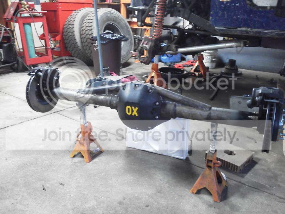

Finally made some real progress today. Got the rear caliper brackets done and on the housing painted. Put the axles in FINALLY :bow:. Time to get the frame rolling this weekend and get to do some working on the motor and the engine to trans adapter ordered.
Also came to the realization I'm going to wind up running a fuel cell. The blazer tank wont work with the rear body mounts.
Retainers I whipped up for easy install with full circle pressure on bearing/seal.
Got the brackets on the housing, axles in, calipers on.
ALL DONE except drilling and tapping a breather since my truss covered it.

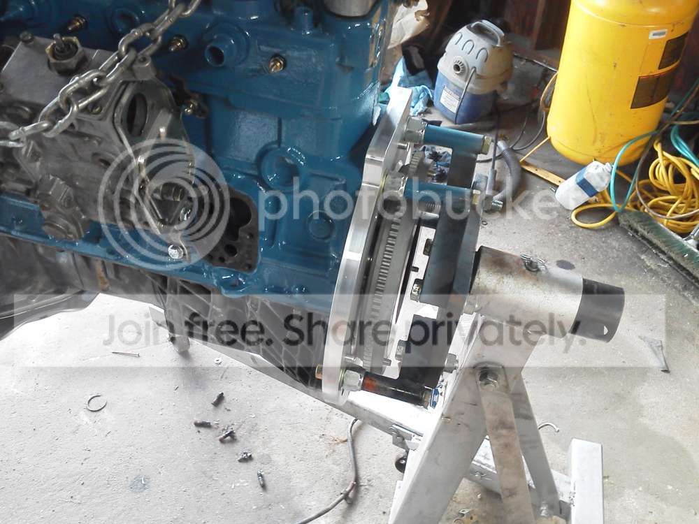

I also got my adapter kit on. I ditched the mercedes torque to yield bolts and went with ARPs. Behold 12 chromoly ford pinto bolts fastening my toyota flywheel to my mercedes engine lol.
Some adapter shots. Really nice piece from Luke over at 4x4labs.com
And just some overall shots of where the engine is up to now.

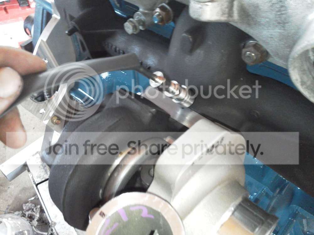

I did take a couple hours today and get my turbo clock and plotted out as to where I want things to end up.
Plumbing will be super easy with or without an intercooler. Its also much smaller than the factory setup length wise. I also planned out a nice, easy to access but not in the way spot for my EGT sensor.

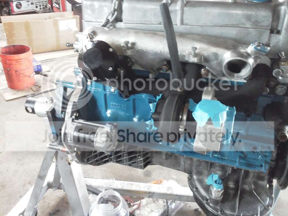

Buttoned up my manifold mods and got the exhaust manifold, waste gate, and turbo on for good. Ive got some CAD files into Kurt to cut out for my for a downpipe and oil drain flange. Brushed up on my stick welding. Going to have to spend more time doing that. Stuff didnt come out too bad but man was it a pain welding a threaded bung in with 1/8in rod...
Also bought a new starter and got it mounted up to see what my downpipe clearance will be like. I really dont think it will be an issue if I run a 90 straight off and go under the starter. But I'll find that out when the motor is in the chassis.
