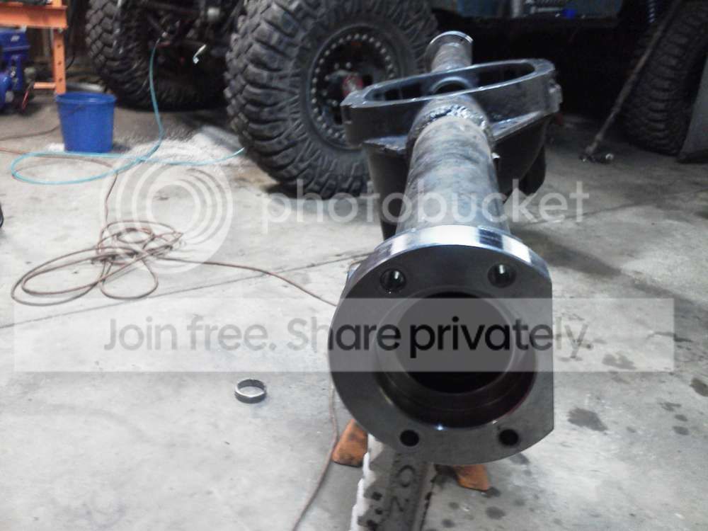

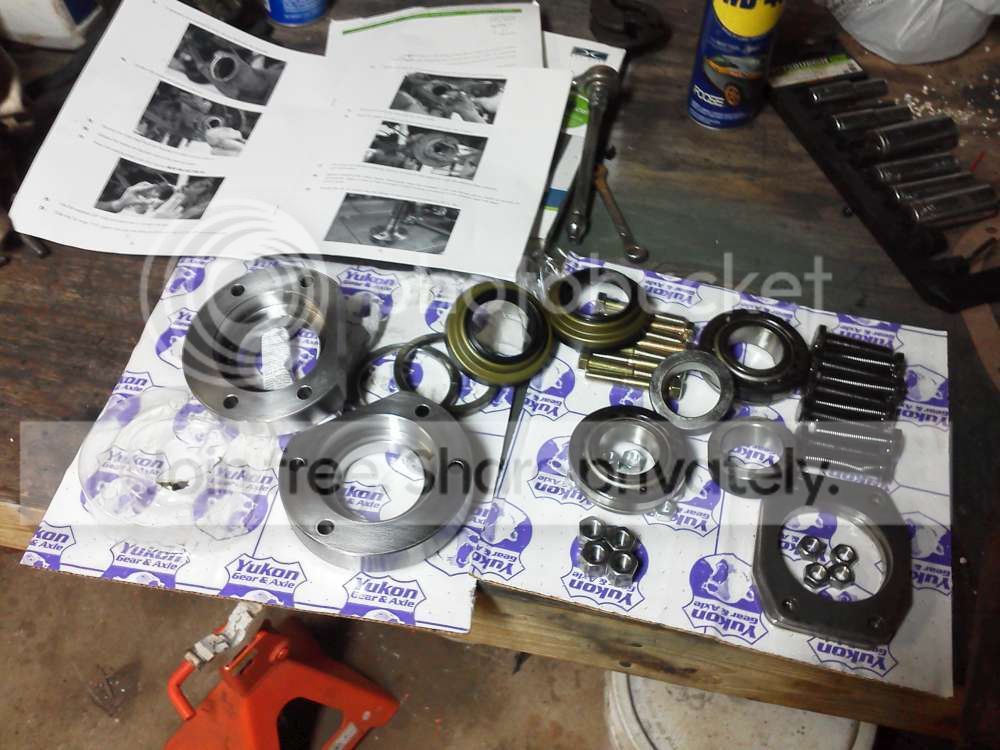

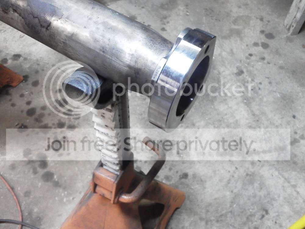

I found a company with the yukon version of the kit called the ultimate 88. Called him up and got him to honor his intro price from last year. $450 instead of $600 + shipping (superior price). It got here today and its pretty damn cool setup.
Basically you cut the seal / axle retainer section of the housing off and bolt on 9in style bearing pockets. I still need to send the shafts out and have them copied into 6 lug versions. My gear install kit will be here tomorrow so my rear will be 1/2 there tomorrow night.

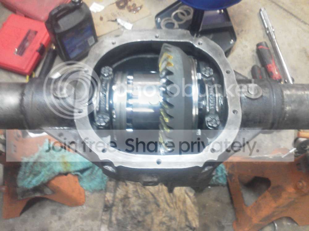

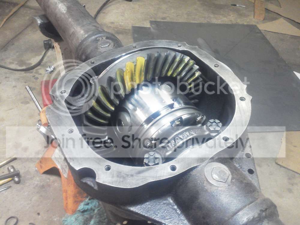

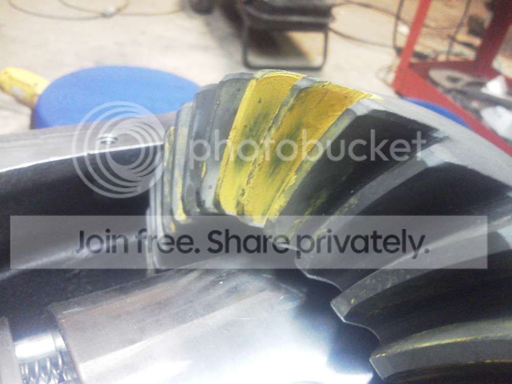

Got the locker and gears in the 8.8 today. Still need to send my shafts out to get 6 luggers copied off them.

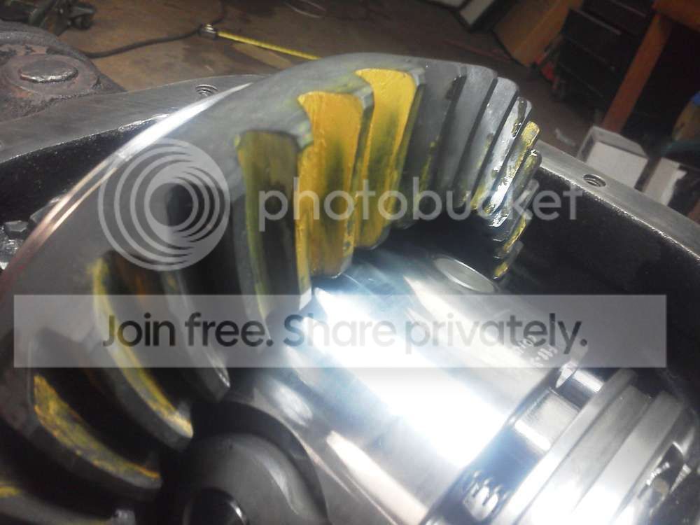

The $90 summit pinion depth tool that measures off the main bearing race surface was an utter waste of money. Its going back, the thing is friggin useless. Theres so many places for the thing to be off and mistakes in measurement made plus the math that I just threw in the towel and pulled a pattern off the stock shim and adjusted. One day I'll drop $350 on a pinion depth kit that has the tapered pucks and bolts into the main bearing races and gives you pinion depth dead nuts in 5 minutes...
