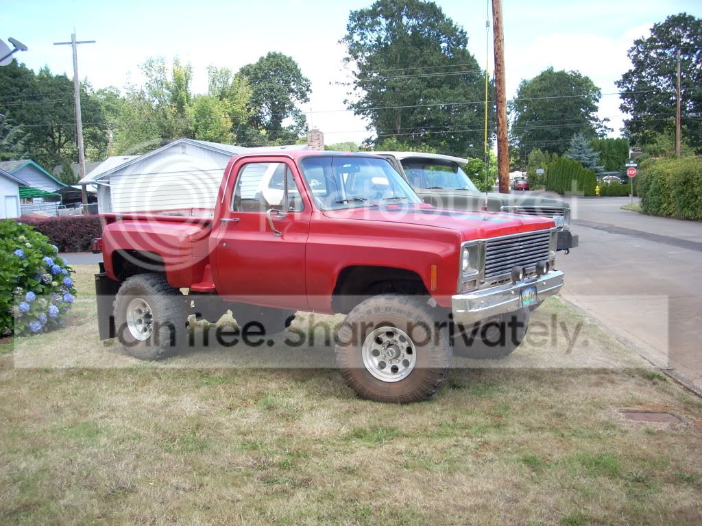

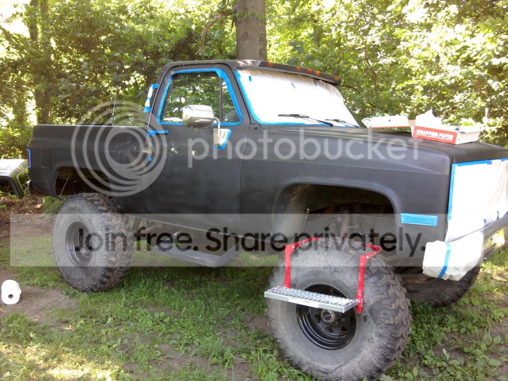

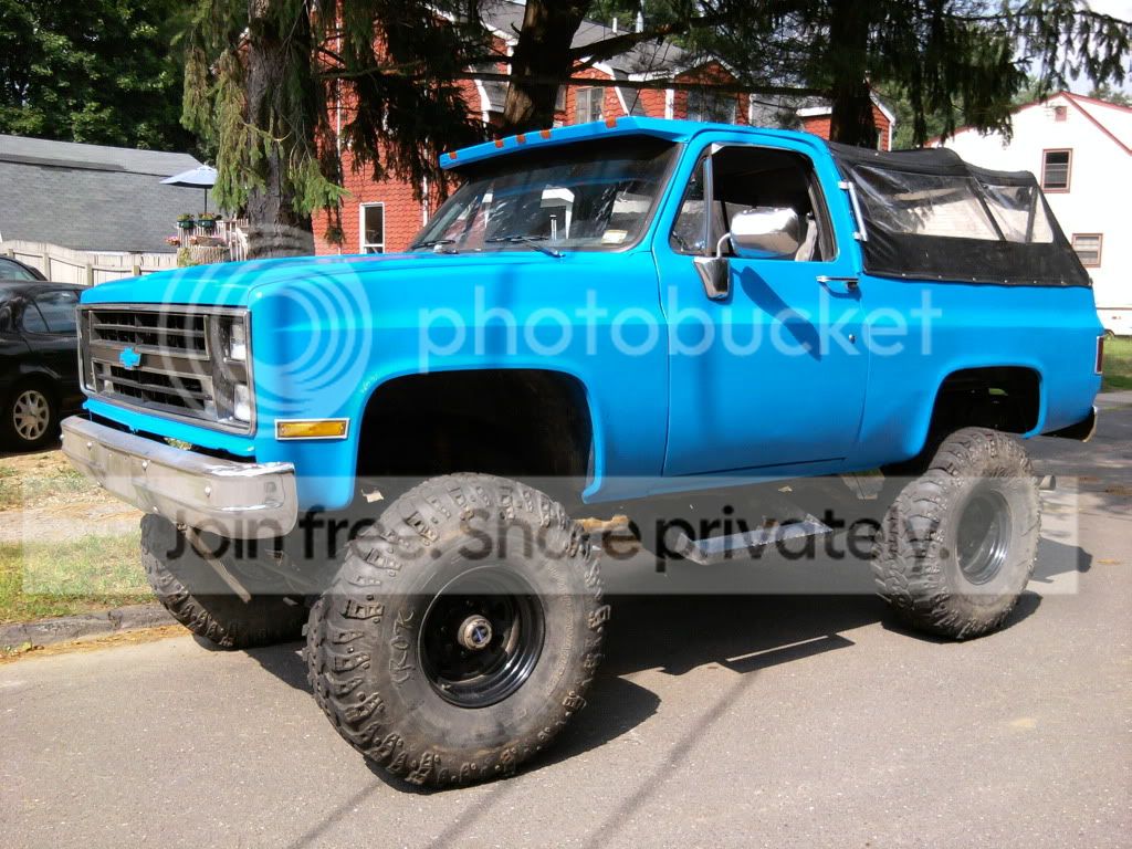

5) The color of your primer will effect how your top coat turns out, especially if your topcoat is a light color. I used a Black Primer to get my Blue darker, my truck is actually T155 / Light Blue from advanced auto.
