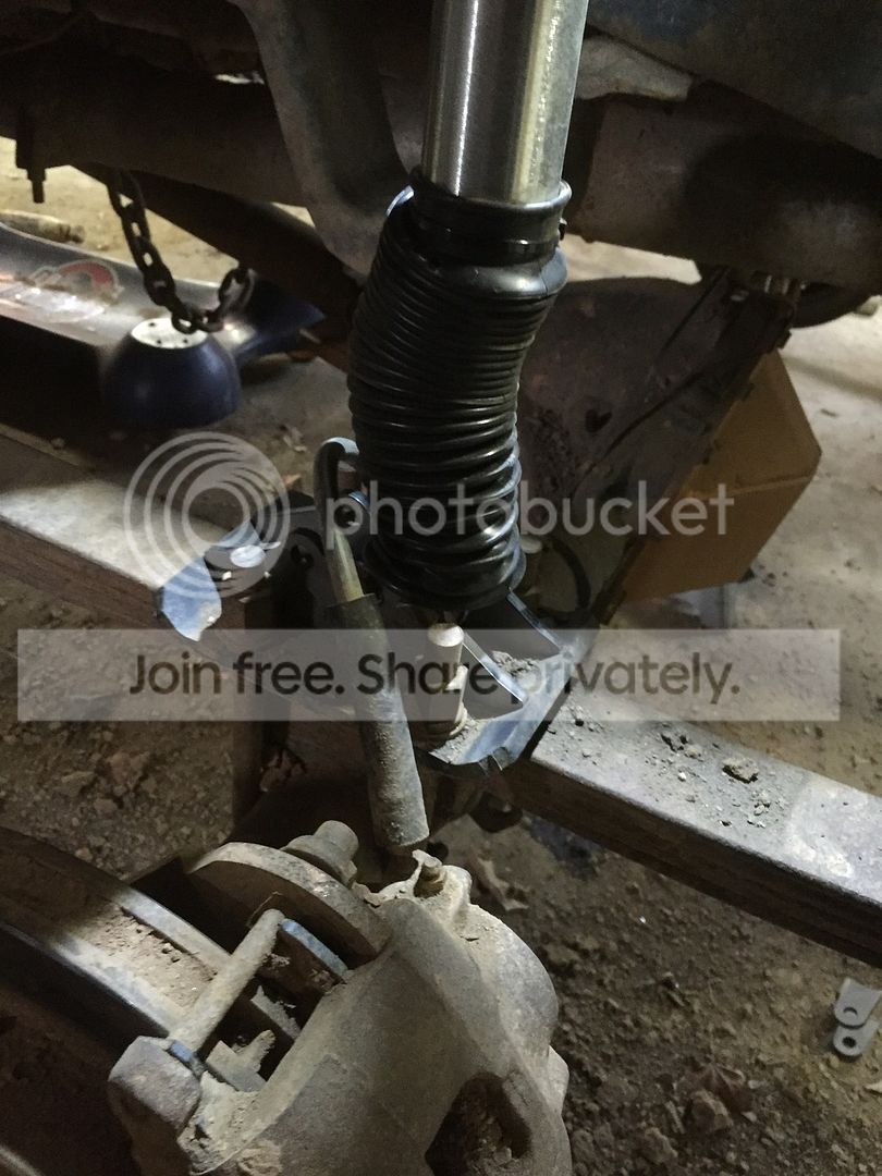

Does your center pin tighten to the spring plate with that nut? Never seen that before...
Shave those u bolts down and hit that bump right on the spring pad imo.
Hmmm I may steal that shock mount idea except with the DeulingFab shock mounts.... What kinda bumps are those?
Did you cycle the suspension to see if the shock body is going to get into the steering shaft on the driver's side?
i will when the bump stops and rear shocks are done although im very confident it wont. the shock body is about 2 inches out from the steering shaft it just looks extremely close because of the angle of the pic.
yes it does. its the way ruffstuff sets up there u-bolt plates although when i got to change the ubolt im going to drill out the center of the plate so the nut can sit down in the plate.
i might just end up shaving the bolts like you said. gonna wait and see when i get the bumps bolted on.
Nice work on the shock setup. Keep up the good work.
thanks. these are the nicest shocks any of my vehicles have seen haha
Whoa what happened to that U bolt and brake hose?
u-bolt got bent when it made contact with my old cheesy engine crossmember i made a few years back. im not sure what happened with the brake line. it got pinched somewhere but ill be securing it a little better to hopefully prevent that.
They look like ruffstuff plates, mine are the same way.
yup there from ruffstuff
not sure on the brand of the actual bumps but i ordered them through ruffstuff.
Interesting. I'm thinking of something along those lines or the stock 99-07 tahoe ones .
Hmm, I ran those in the back until I bent the plates from over torquing them... I don't recall mine sticking up like that, but I probably ground the nut down to fit in the hole or something.
