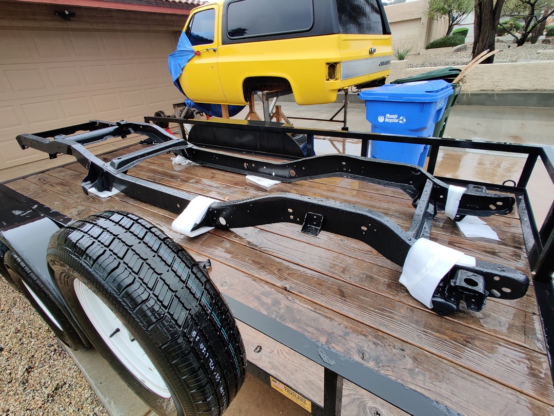

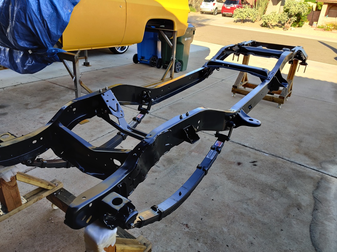

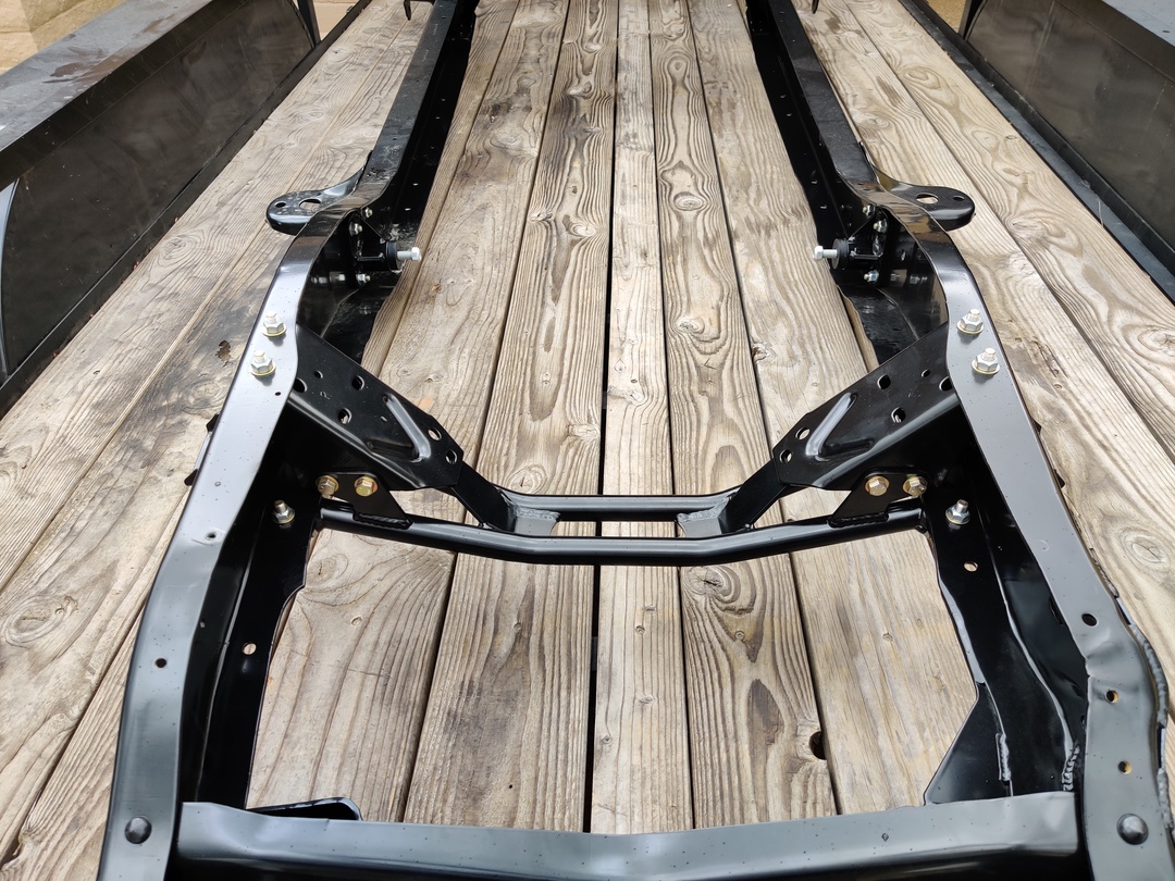

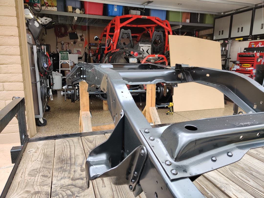

My frame finally made it's way back from the powdercoater's this past weekend. It came out great!

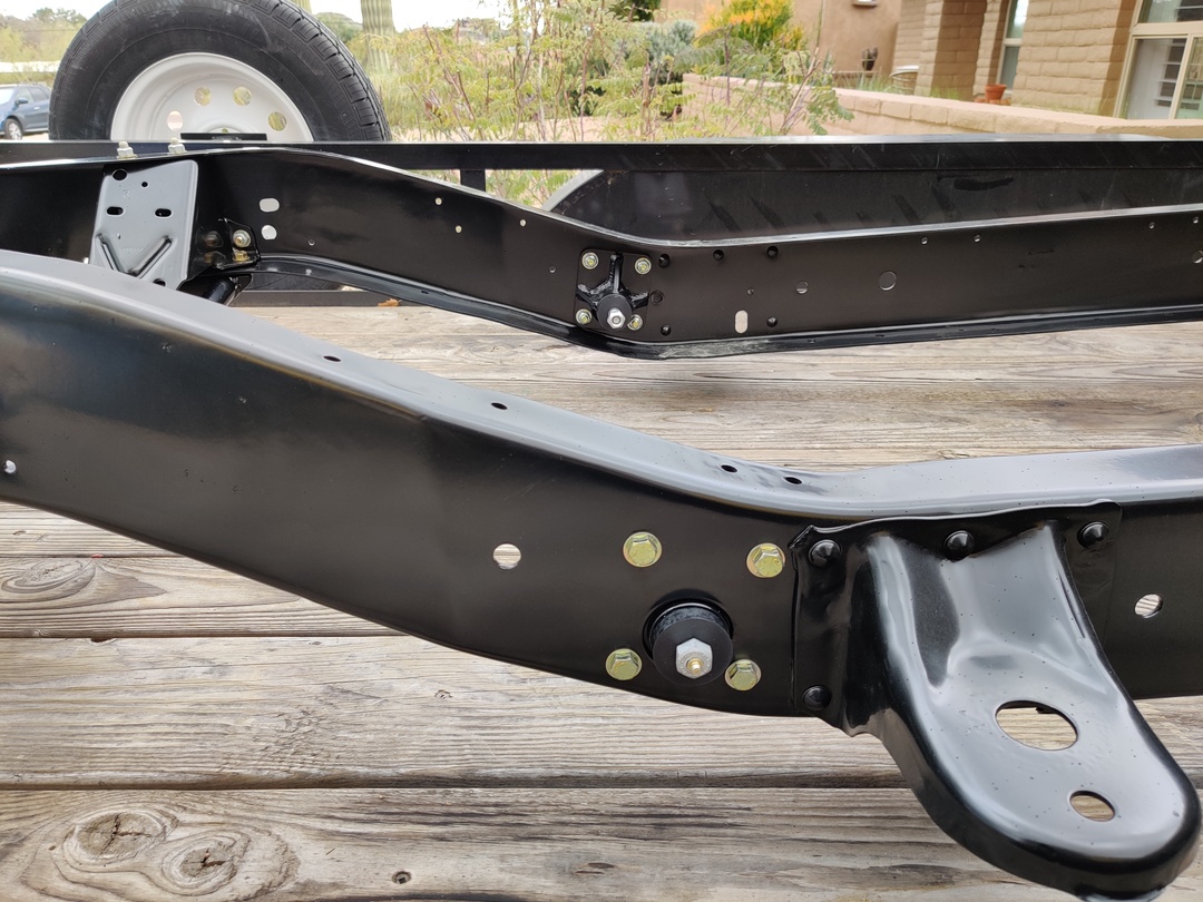

I installed the ORD front upper shackle hangers and engine crossmember right off the hop:
Also bolted up the DIY4X shackle flips that I bought eons ago:

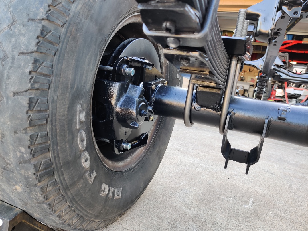

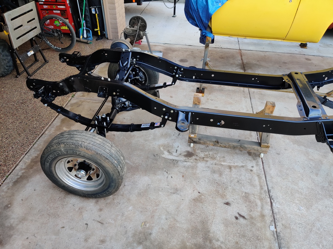

The custom leaf springs showed up, so I went ahead and bolted up the fronts.
Plan is to get the front axle bolted up and then get to work on the rear, then I'll have a roller again! Here's what I am thinking:
1. Re-gear and rebuild 14 bolt
2. Mount leaf springs, axles

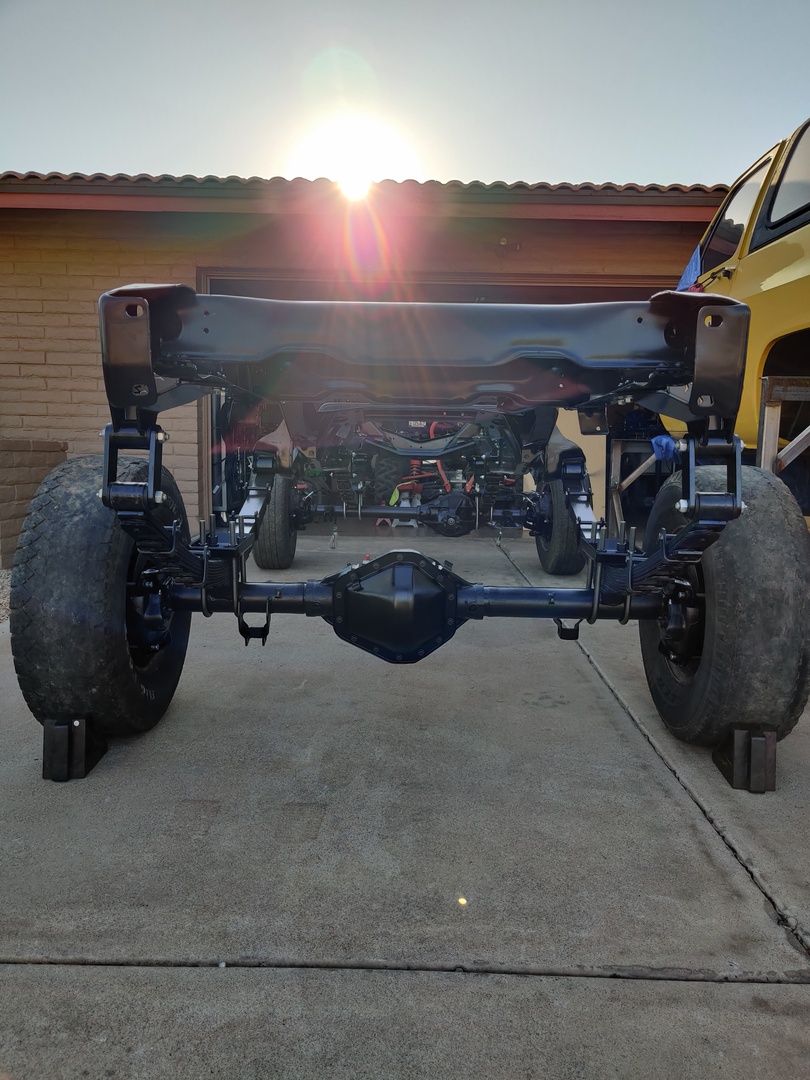

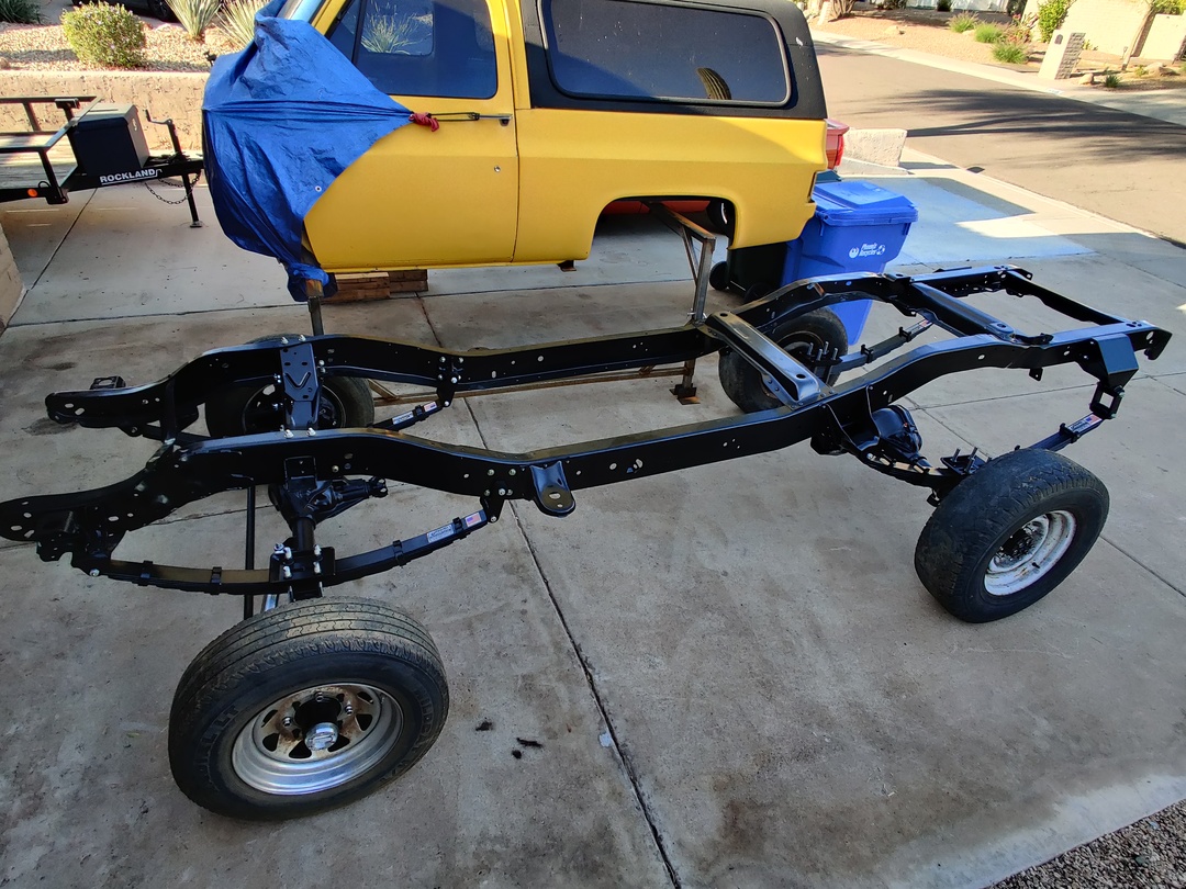

I got the front axle out of the garage and mounted up:

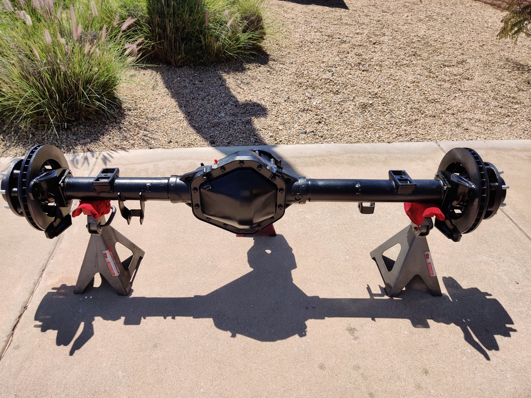

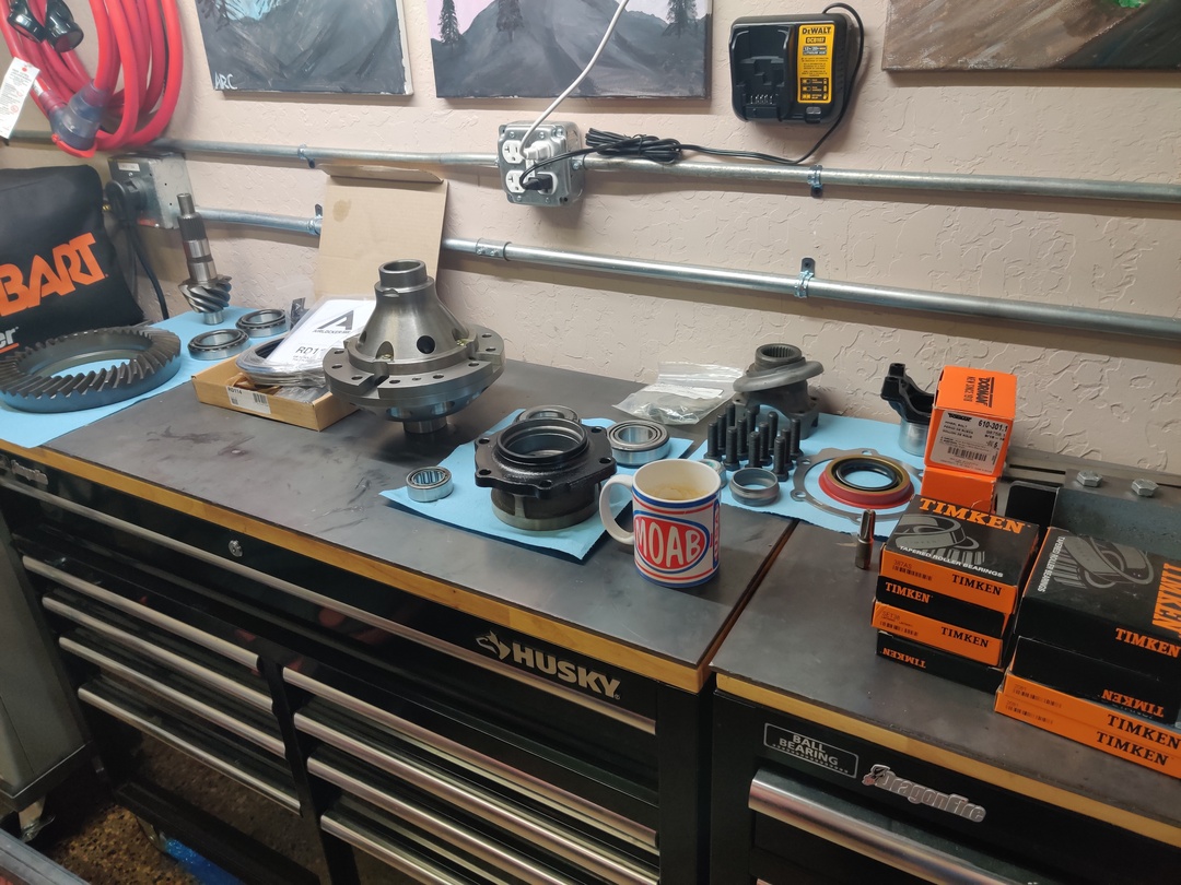

Tore apart the 14 bolt and got it cleaned up and ready for rebuild:
Bench full of parts: 5.13s, ARB, new bearings, seals, etc. Disc brake conversion not pictured.

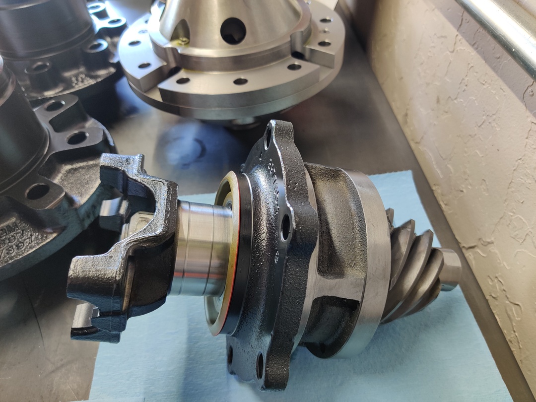

Setting up the 14 bolt is so much nicer than the 10 bolt. Love that the pinion assembly bolts on. Here it is all setup with the pinion, new bearings, and crush sleeve eliminator.
ARB dropped in and ready to setup the gears:

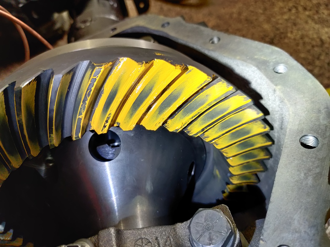

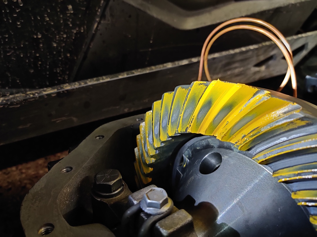

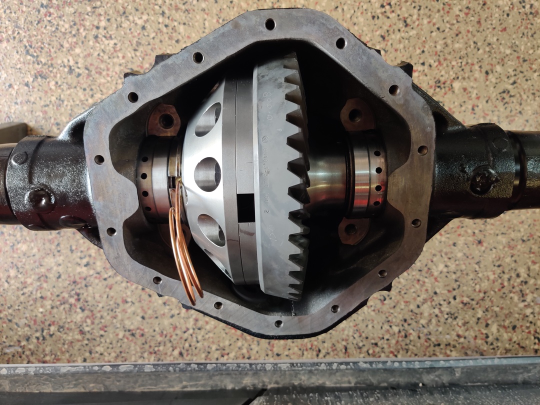

Here's what my pattern looks like right now. This is with a backlash of 0.007" (ring gear is etched w/ 0.008") and NO pinion depth shims. I'm still so bad at reading these. What do you think?
I am not a gear expert.
I would put a small shim under the pinion support. Two or three thousandths. Then try the backlash at the .008 as stamped. Just to see what happens.
I believe that you have an acceptable pattern, but I may be wrong. And I would play with it to give myself something to compare to for my peace of mind.

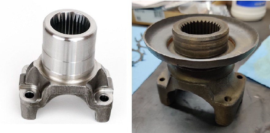

I’d send it. But why does the yoke look like it’s sticking out really far in that first pic?
Thanks for the suggestion! The thinnest shim I have at the moment is 0.010", and the gear pattern looked a lot worse with that one and similar backlash. I'll have to see if I can get some thinner shims.
@ktmoutfront , what do you think? :)
Well that may make the decision then. I thought that it looked pretty close. And I haven't done a 14FF, so I don't know what shims are available.
I'm leaning toward running it too...
Good eye on the yoke...it's a forged u-bolt style yoke from ORD without a dust seal. It caught me off guard at first, but it has a longer shank than the factory one with the dust shield:

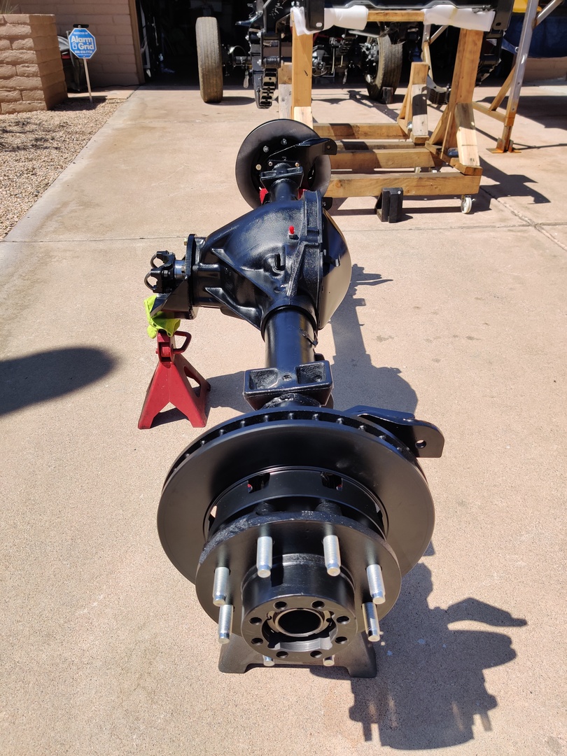

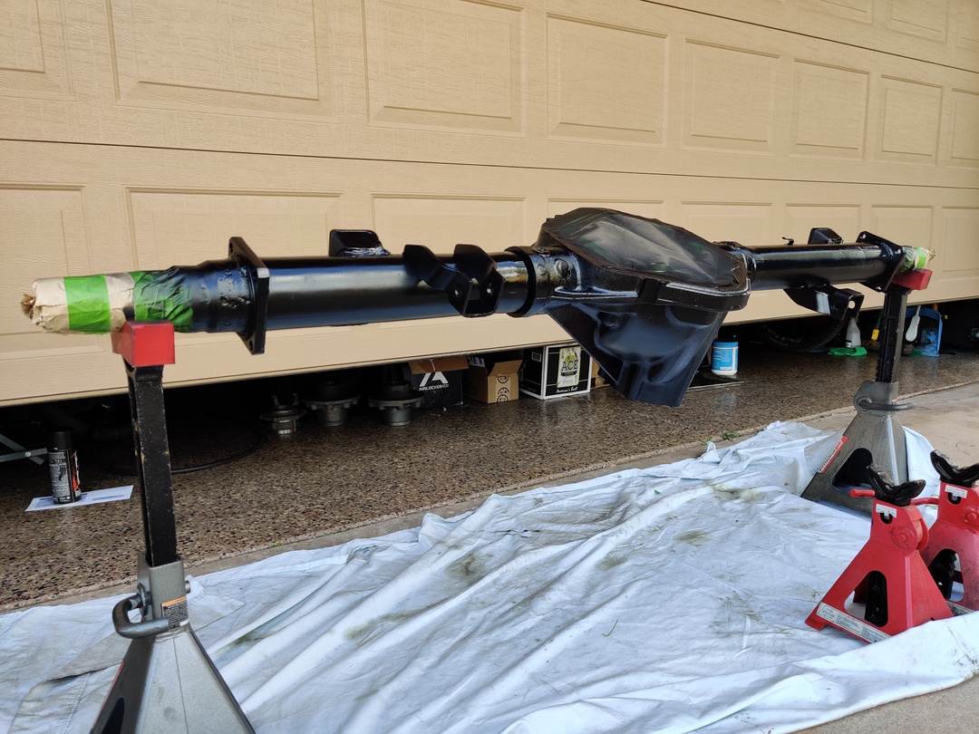

Progress! 14 bolt is all buttoned up and back under the frame:
Next, I'll probably run the brake lines, drop in the engine and trans, followed by fuel system. About time to start thinking about what to do with the body...
