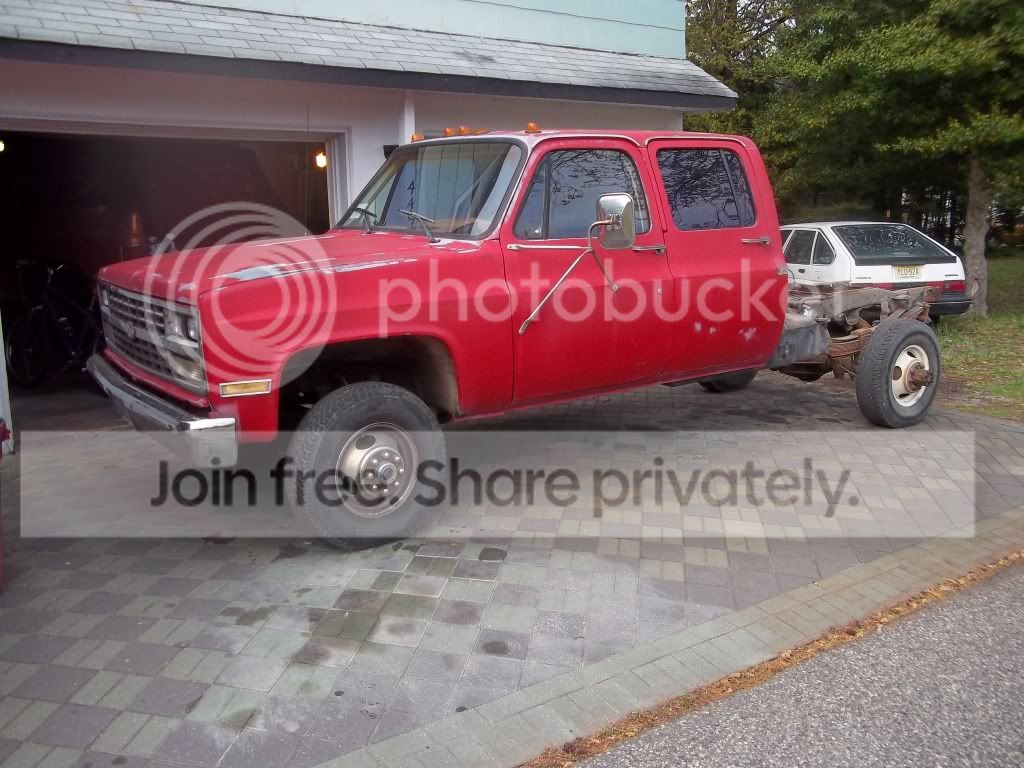

the best part was, I got rid of that horrid purple window tint! :haha:
now I just gotta get it off the back... I don't get why people like that, I always preferred a standard smoke color... :dunno:

the purple stuff? could be, I don't know, never bought it... it certainly didn't seem discolored.. and obviously a nuisance to remove...
I understand it was an Arizona truck or something and probably needed tint.. I just always thought the purple was kinda ghey looking...

yep..that looks much better all one color...the two shades was pulling some kind of trick on the eyes...it looks like a brand new truck now. looks like you blacked your wheels again
thanks, definitely looks a little less hokey now...
and it's just wet there.. rinsed off the sanding dust...
Purple tint is just old fade tint.
Looks much better all the same color.

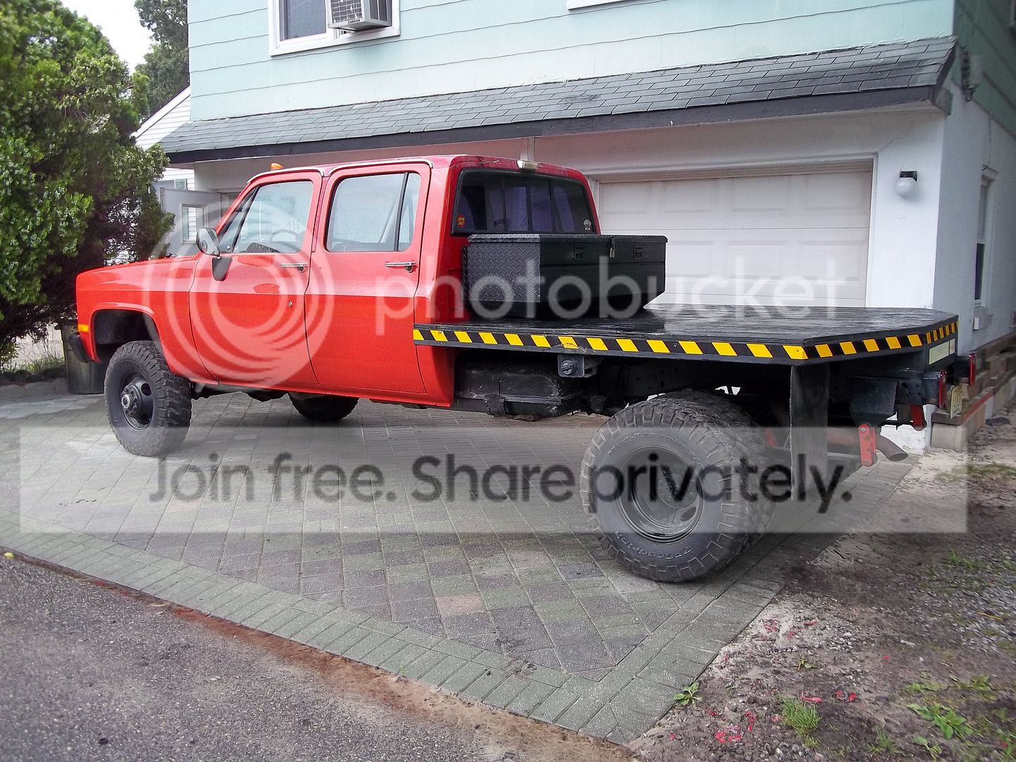

Truck is looking amazing Paul! :bow: I really like the way this build happens on a real-life, everyday work truck..... You use it all week, then pull it into the lab Friday night, do some mad-scientist stuff on it and by Monday its rolling back to work with some kind of new modification completed.
Way better than those jackstand builds IMHO! :)

the one that'll push that "in the Lab fri, work mon morn" to the limit logistically, will be the tubebed..
first weekend will be moving the flips, lopping the frame and getting a new x-member/winch mount in...
than about 160' of 2" DOM the following weekends.... :haha:
