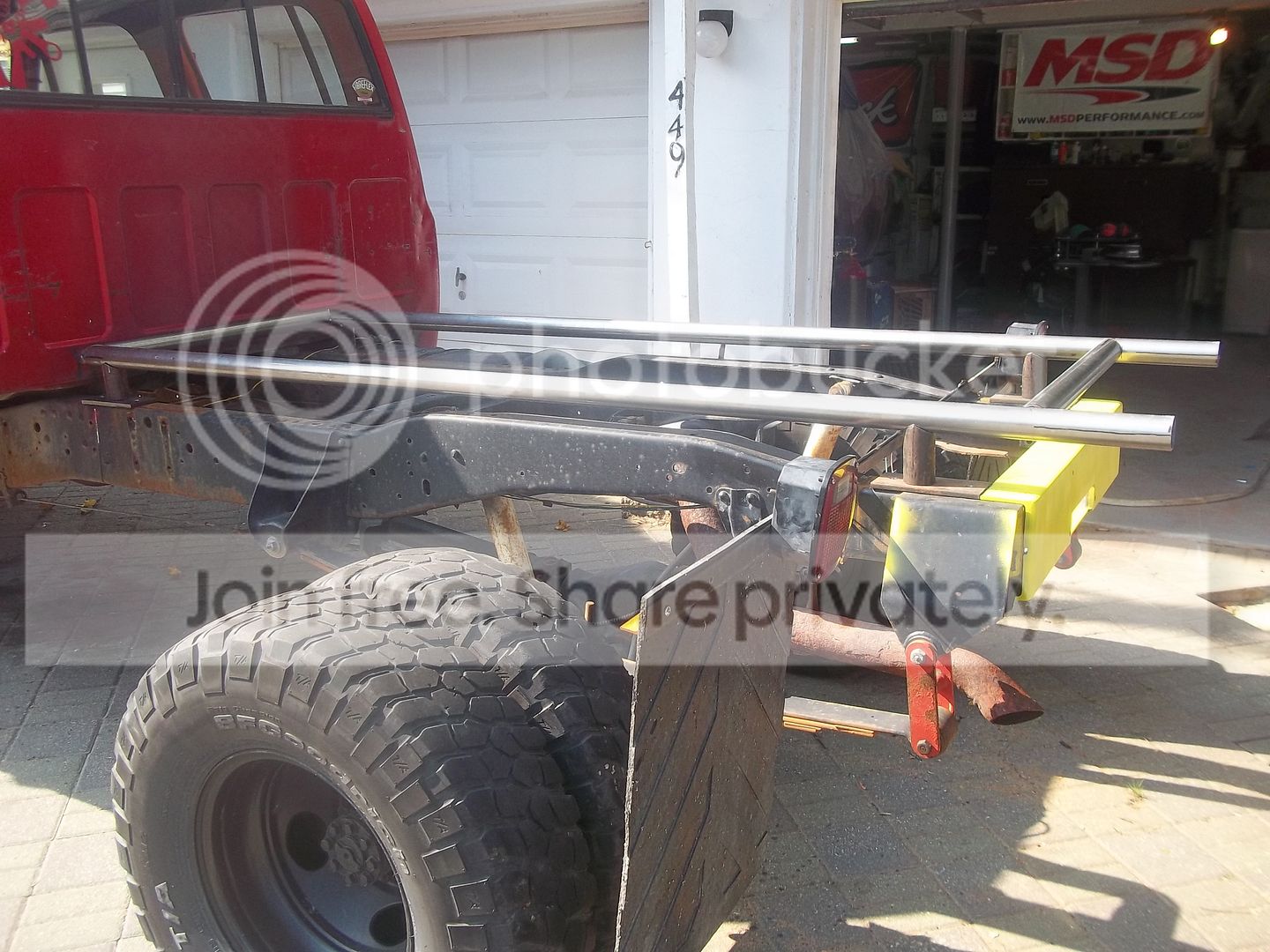

gonna start cutting bed mounts tonight after work....

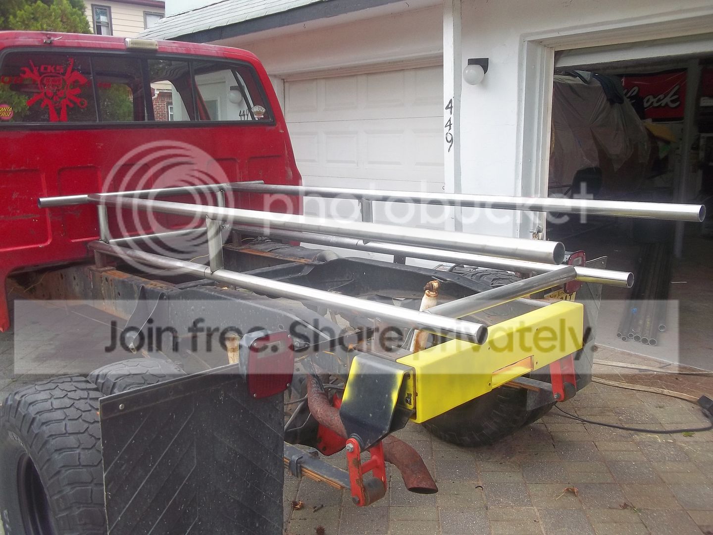

the beginning of the coffin...
ignore the extra length out the back.. needs to be trimmed down to 2" behind that back cross tube.. that's where the tailgate will sit...

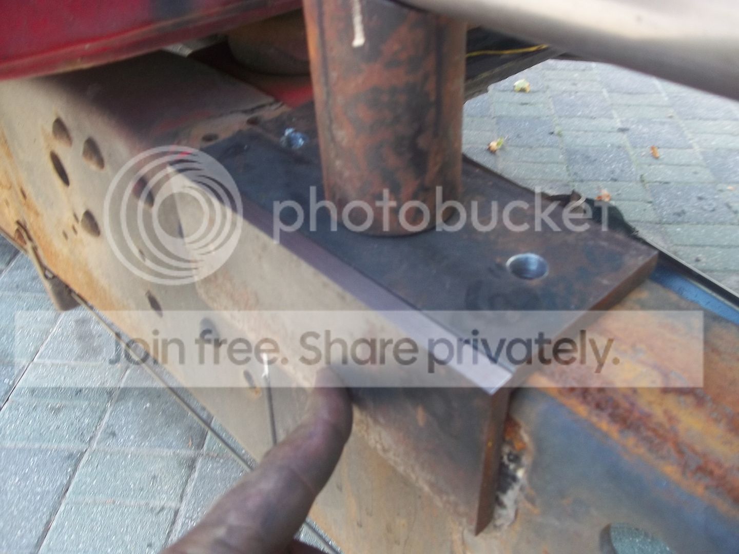

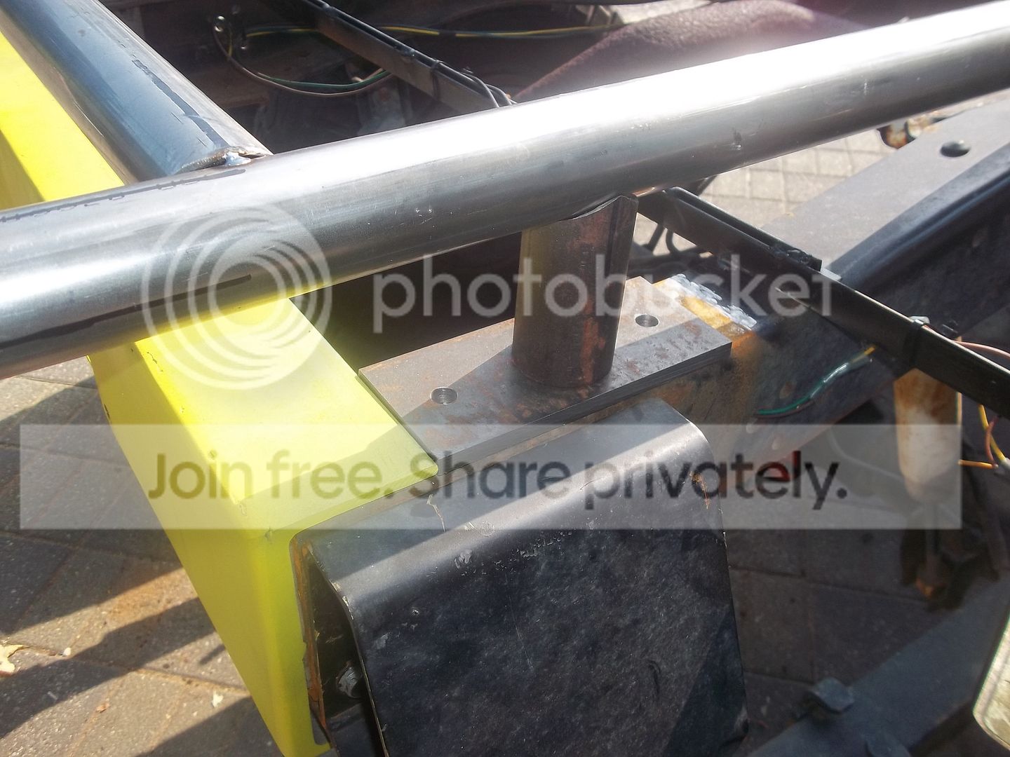

rear mounts, 3/8 plate, 1/2" bolts......
front section....
the front 3/8 mounts will get some side to side aid next week.. i'll be adding these plates to em, and 2 additional 1/2" bolts into the side of the frame...
next week I'll do the angled tubes in the back and the upper coffin tubes... after that it will be the main 2" upper tubes that go out above the toolboxes and tires..

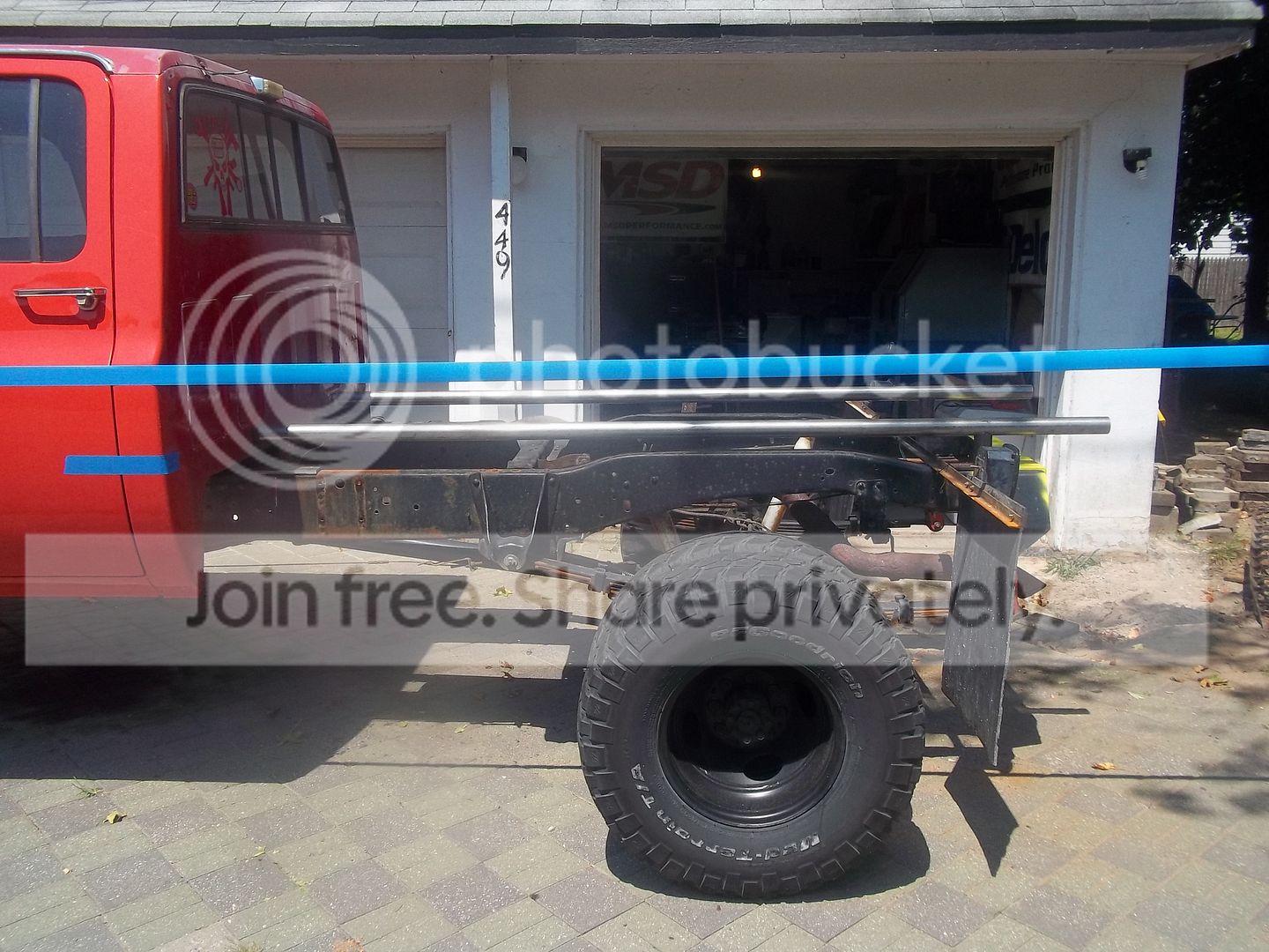

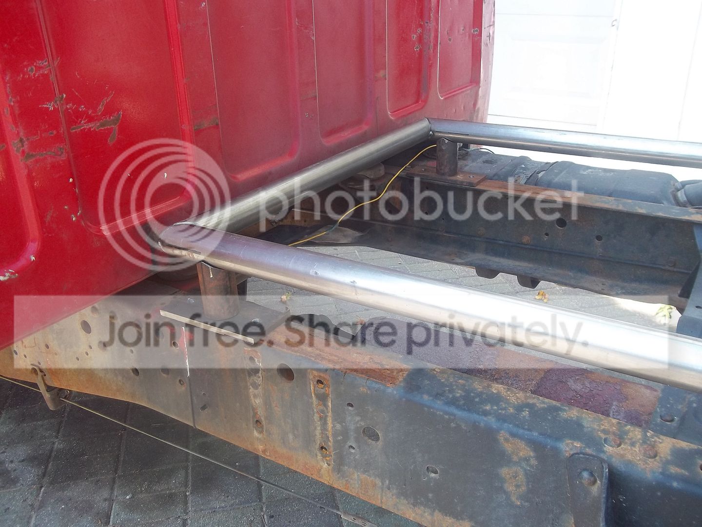

here's a shot from today with 2" blue tape showing where that main tube will run right below the bodyline.....
that lower tape mark shows where that lower coffin section sits I did today... it is also where the 1.5 tube below the toolboxes will be above the tires...

do those brackets get bolted and welded to the frame or are bolts enough?
just bolted... I want/need it removable... I figure 12 1/2" grade 8's should be plenty...

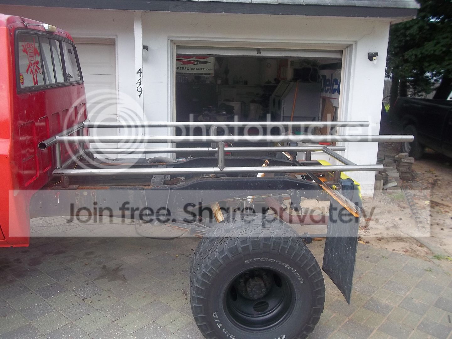

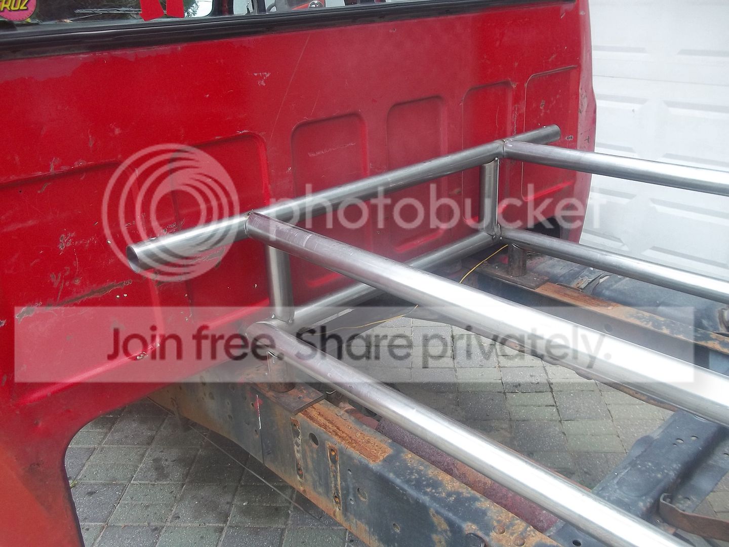

look ma, a coffin! :haha:
you can just make out the holes at the ends here where I'll be slugging in the outer upper tubes... was originally gonna do it in the middle, but this worked out better and will be 1000x's easier...

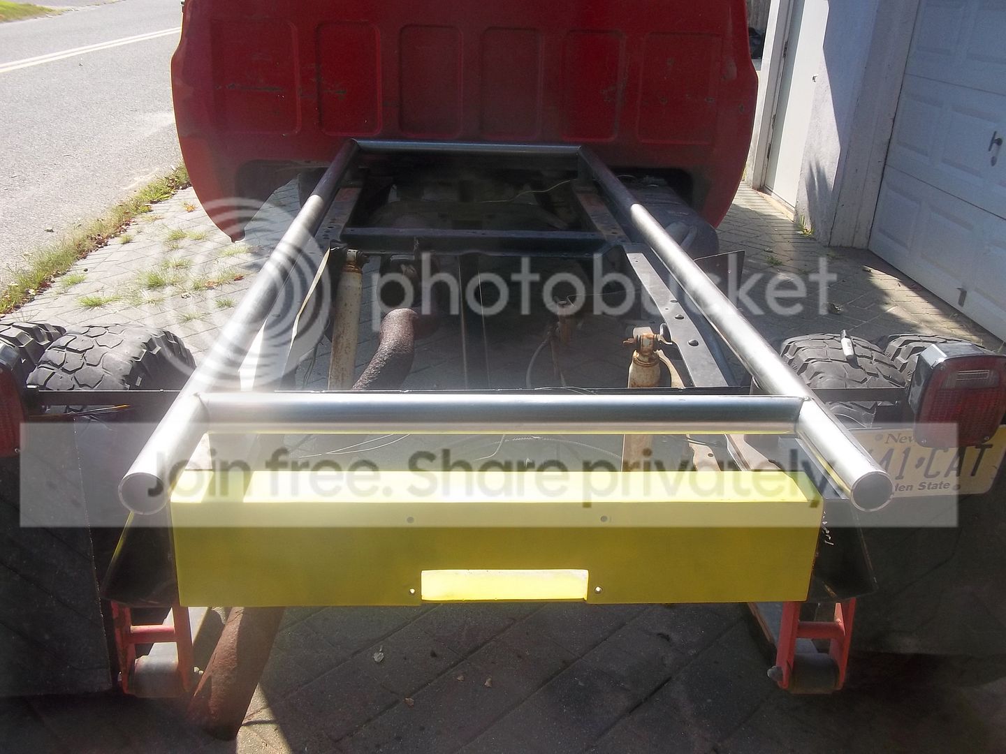

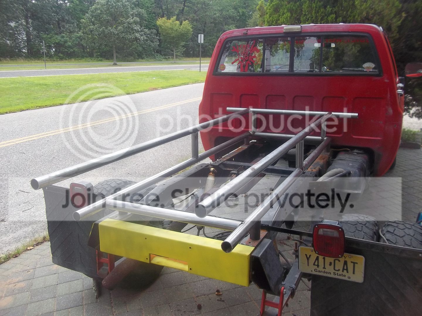

I figured out the back angle pieces and cut em, next week I'll cut the 4 long ones and get that set..
originally, I was just thinking in my head they would automatically be 45's... but as soon as I mocked that up, it was too much...
so than I hemmed and hawed on 30 or 35 degrees and ended up with 35 at the tailgate.... I always have the potential for doing a slightly different angle out behind the toolboxes too. but it'll more than likely be 35 too.....
