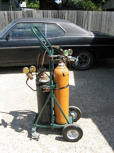

this is kinda like the setup I'm looking at.... well, bottle size anyway.. the cart is a side by side kinda deal tho..
Oh yah, a fullsize kit is way better to have in the shop. Gets you hours and hours of run time per fill up compared to a half hour etc.
But i dont have a shop to call my own so all of my personal tools are small portable versions of the full time shop stuff etc.

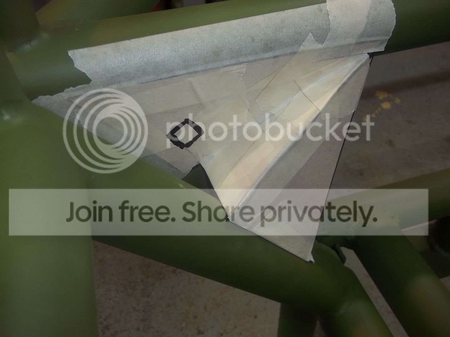

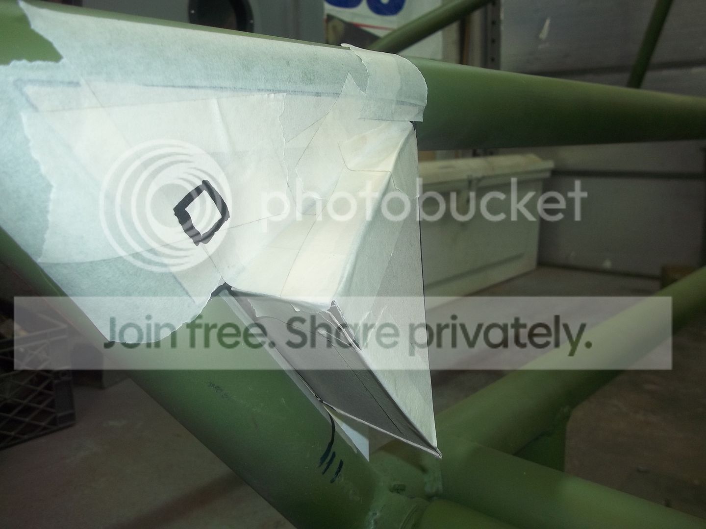

playing around today.. latches in the morn, so this will prolly change dramatically..
but I figured let me do a bit of templating and get some ideas...
the plate you can't see really that is a triangle and centered in the 2" tube basically makes a vertical up/down from where the hinge is, straight up to the upper tube..... what that's also doing for me is giving a nice surface down the road for the alum sidewall of the coffin to end on...
also one thing I'm trying to keep in the back of my cranium is a spot/cubby I could make/etc for a hardwired winch control switch.... just the in/out... i'll do the power switch in the cab...

the one thing I don't like about my template mockup is that the latch hole would need to be boxed on the inside, as that's actually a sealed, boxed area that could get rain water in it... not that I couldn't make a little cube for in there, but it's just MORE work..
but I need to see how the latch wants to be.. if I need a slightly rounded ramp kinda deal... like a house door has, etc...

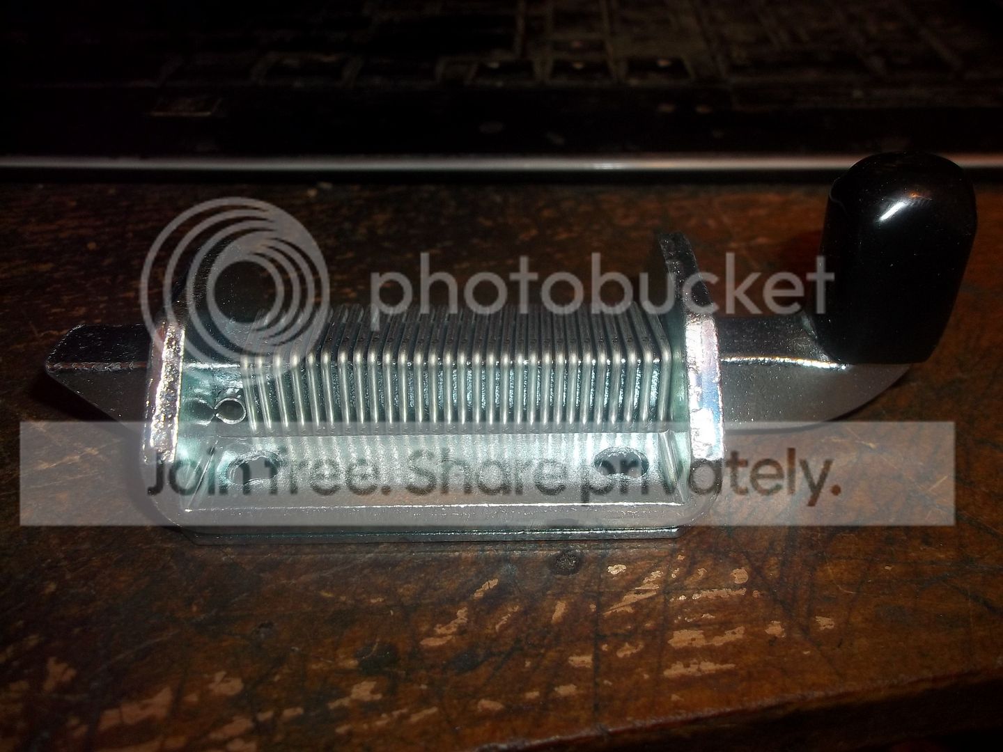

$50 later, I have 2 nice springloaded latches sitting in front of me......

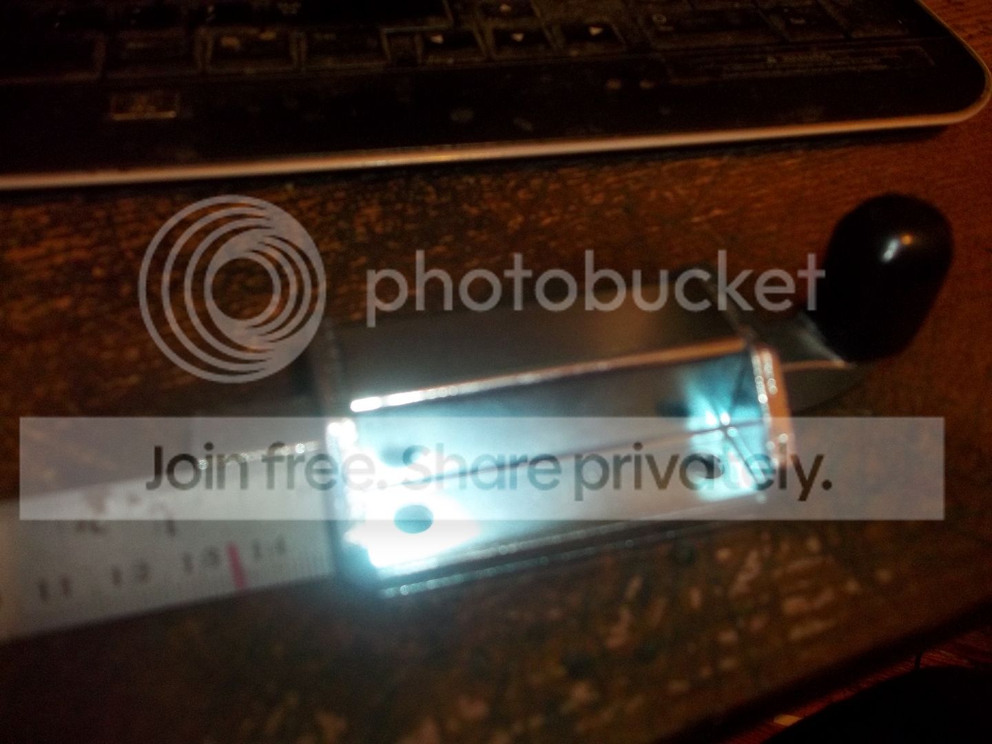

only prob is that 1 3/8" projection they where talking about in McBible, is the handle end! :doah:
as you can see 3/4" sticking out, not even close...
soooooooo, I have a couple options here...
#1 - is to just flip the handle as mentioned previously and see how "unwieldy" it'll be to pull the latches with them face in, and the outer panel being set 1/2 way in the tube...that'll be first..
as you can see, simple procedure, rollpin/flip...
the big downside to this in addition to potentially being tough to operate is that I was going to put a flush mounted alum panel on the inside in addition to the outer one...
it'd hide the panel mounts for the outer one and make it look cleaner... it would just have a rectangle notched on each side for the latches...
option #2 - redrill the rollpin hole over a 1/2"... that would prolly give me enough exposed to recut the other angle... downfall to that one being it'll put the handle like an 1/8" off the housing, leaving more of a nub than a handle...
option #3 - get some 1/2" cold rolled stock and make my own handle.. if I did this hopefully I could get the boot off these and reinstall on mine.. don't wanna have to do some plastidip toolhandle product.. tho that could be a last resort that I'm sure would work.. jar ya dip plier handles in stuff..
if I do this, which is HIGHLY likely no matter what the result from #1 and #2, I would just weld/shape a right angle piece at the end obviously, as opposed to trying to bend like the original...
