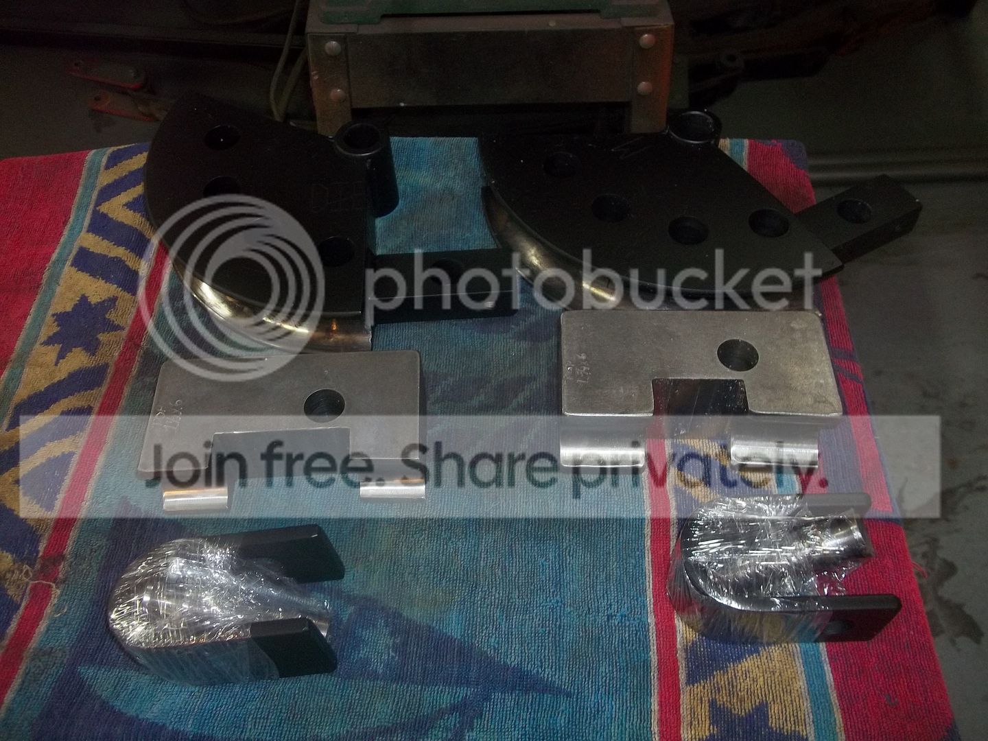

bent up the first 1.5" with the new 6" CLR die.. gonna work on the others in the morn.. maybe see about getting the 2 main lowers in tomorrow...
