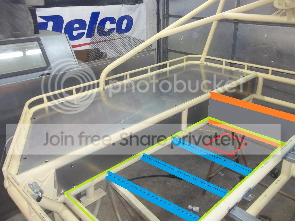

more design changes... in addition to the single floor panel mentioned last night, I'm now adding a front wall to the coffin... right behind where the tank will end...
so, a tube across the top and bottom of the coffin..... shown here in orange...
the blue are 1" x 2" rect, stood up vertically...
the small front wall, will be the same config as the sidewalls, set 1/2 way in..
the green lines show where the floor will run to... basically 90 degree butts all the way around.. you wont see any of the lower tubes...
and obviously the red is the gooseneck hatch...
oh, and to tell ya how much of an anal douche I am... :doah: :haha:
I am STRONGLY considering wasting more material and taking 3 1/2 steps back here....
I'm thinking of cutting out the tube circled here in purple, and moving it forward to the "new" "corner", in pink....
but what that does is basically make everything I did sat and sun null and void...
basically the 3 coffin walls I made would become somewhat scrap.. the only one I didn't make was the ps forward one... so I would need to remake the 2 back ones that much longer to go up to the new corners..
and thus those countersink locations would be wrong for proper spacing, so I'd have to move those panel mounts too.. tho they are just a few tacks holding them in right now thankfully...
that would also make that front left coffin wall not needed.. I wouldn't even run the front ones... the tool boxes and fuel tank will hide that area...
THE one saving grace is, I could probably repurpose one of those 3 panels, as the front wall of the coffin..
I need to do a bit of math/geometry tomorrow, but I THINK I have enough alum left to do this... I have a full 4 x 8 and all I need out of it is, the coffin floor, and the 2 small rectangles for the tubegate...
it IS the right way to go.. it would look SO much better than that tube sitting 6" behind that wall..
hindsight engineering brings the suck.. :angry1: :(
if I had realized this when I was building the coffin at the very beginning... he!!, even Friday, would have saved me a ton of effort...
what say ye CK5 masses, should I nut up, eat the labor, and do what I think is the right way/look? :dunno: :ears:
ok, I have plenty of alum to do this.. it leaves me enough leftover for 3 extra taillight panels.. so a f*ck up, and 2 for the future LED ones...

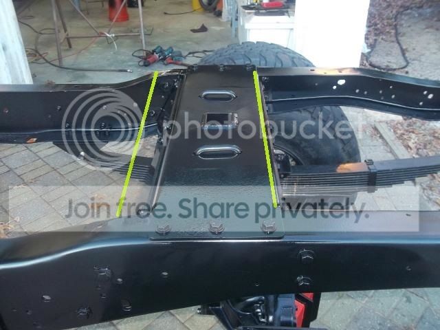

I just looked at this pic and thought maybe you should measure from the side.... it looks like you'll have to pull your spare off every time you want to hook up a gooseneck...:dunno:
that picture isn't really to scale per se....
in this pic, the front of that upright piece of metal should be the very front of the gooseneck tube....
so it should be fine...
and yeah, good point about the chains... here's my plate setup with chainholds... and relooking at this pic is a reminder to me that the window/hatch may actually end up a rectangle, wider than front/back due to the safety hooks...

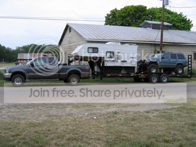

yeah should be ok with a car hauler type trailer... square nose camper wouldn't work though lol not that you'll probably be towing one
