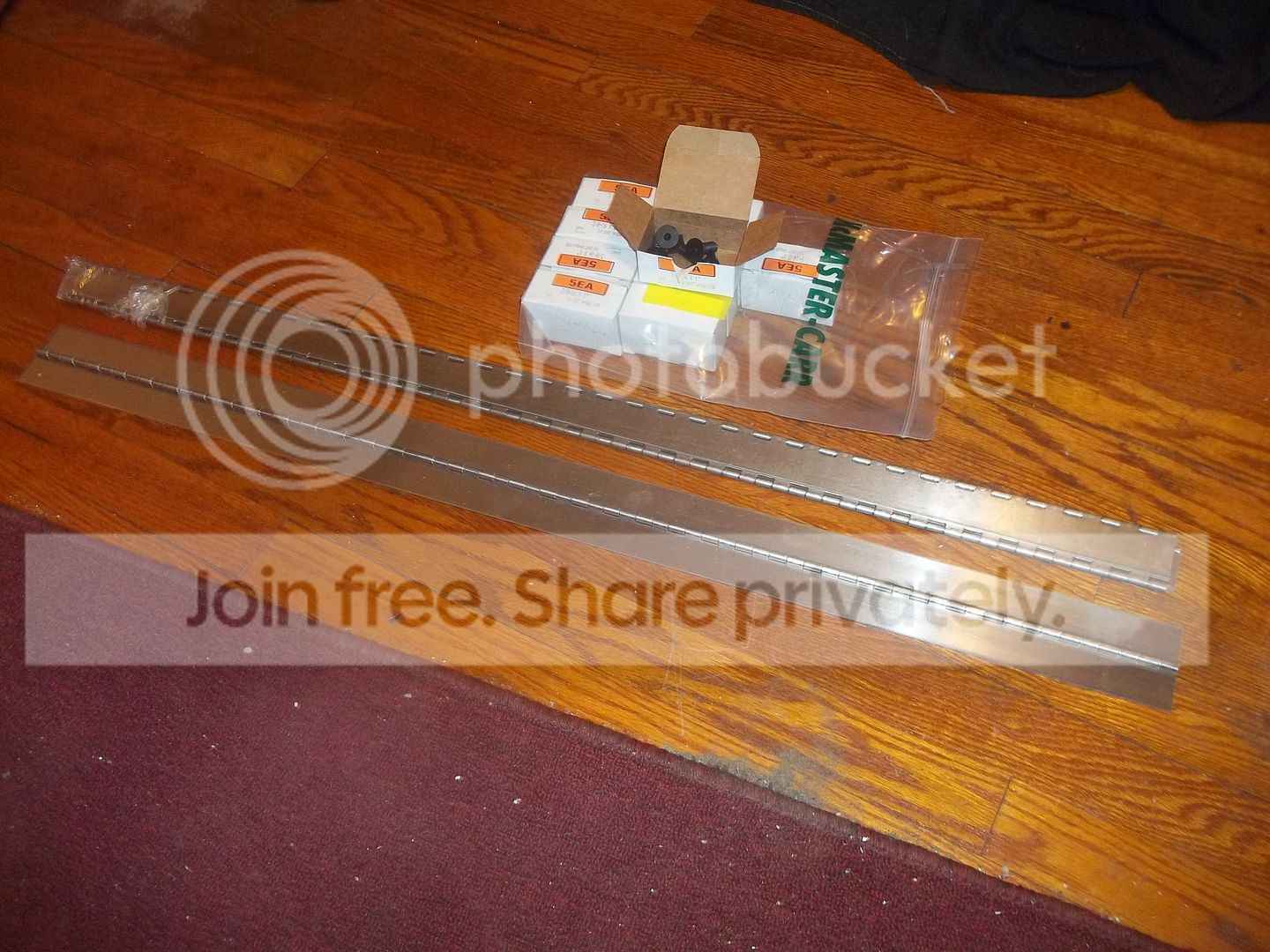

along with the rest of the countersinks, I've got my piano hinges coming in today for the dropdown doors in front of the drawers... gonna see about getting going on those pretty soon too... at least getting the doors cut out and fitted..

got the remaining countersinks, and hinges in for the side doors today..
