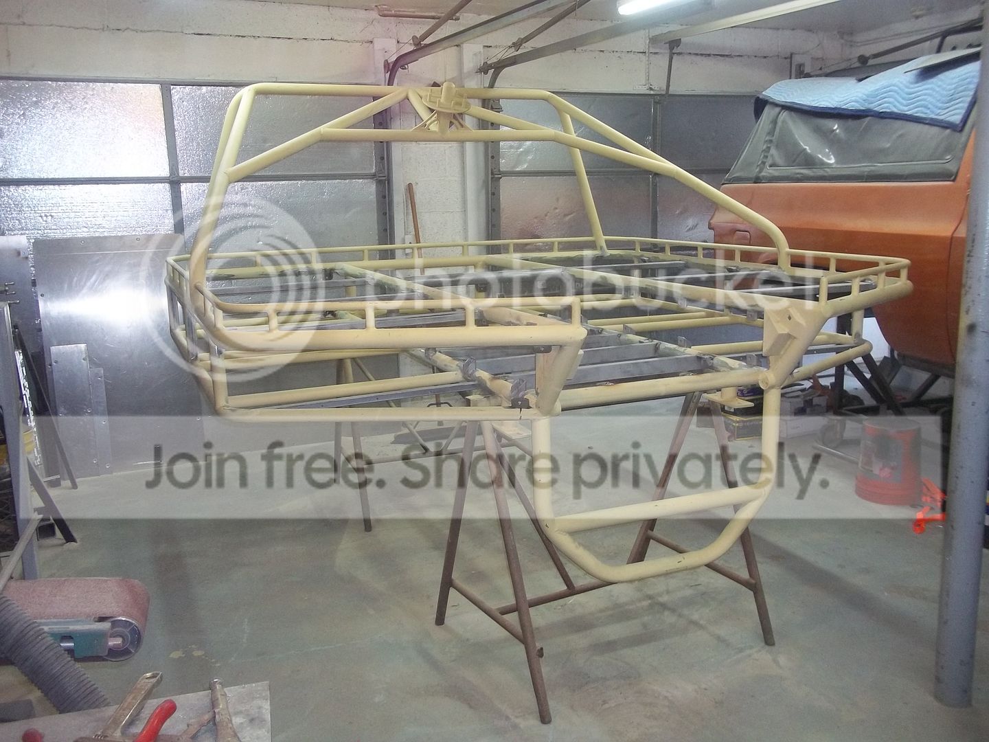

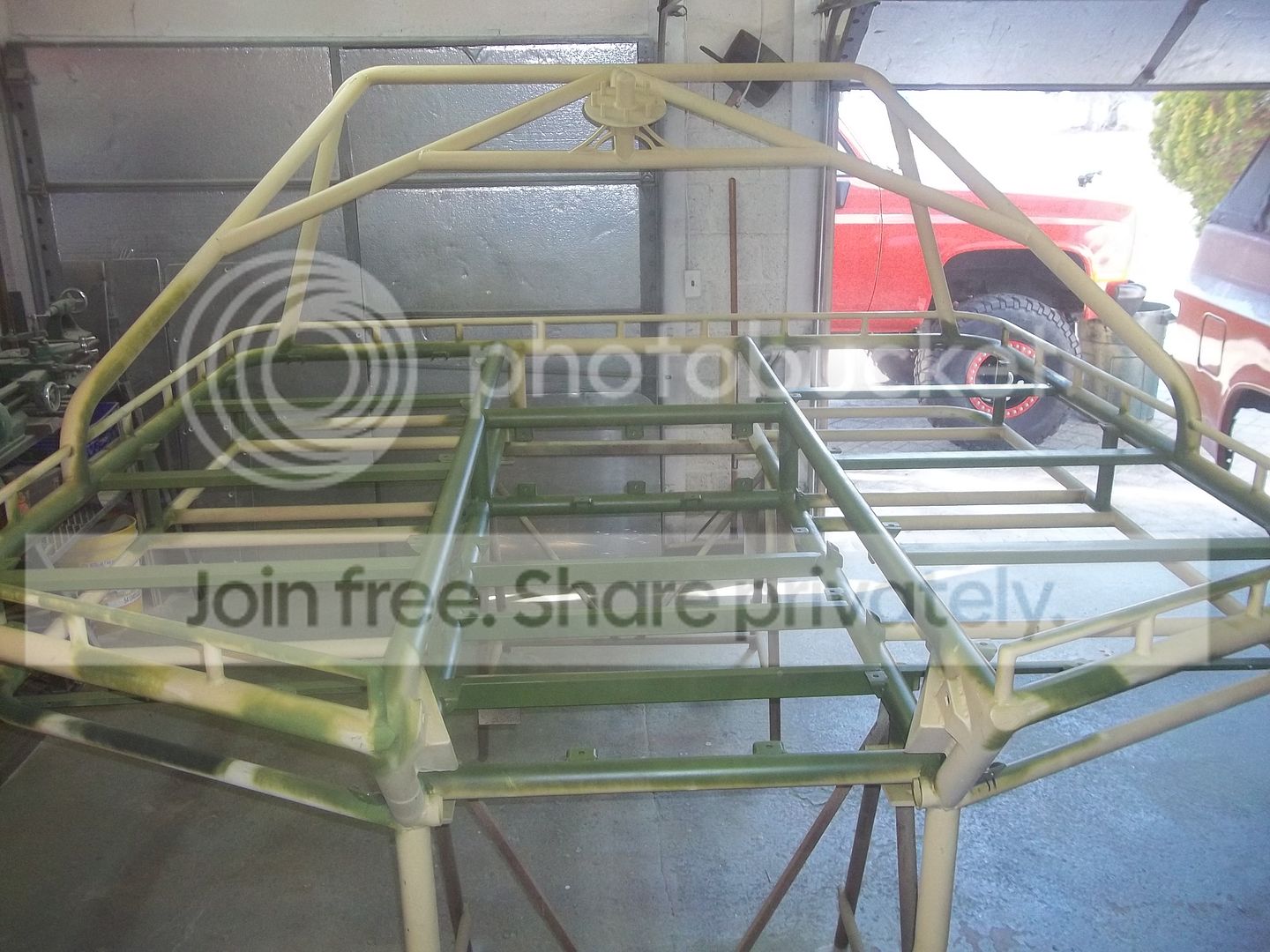

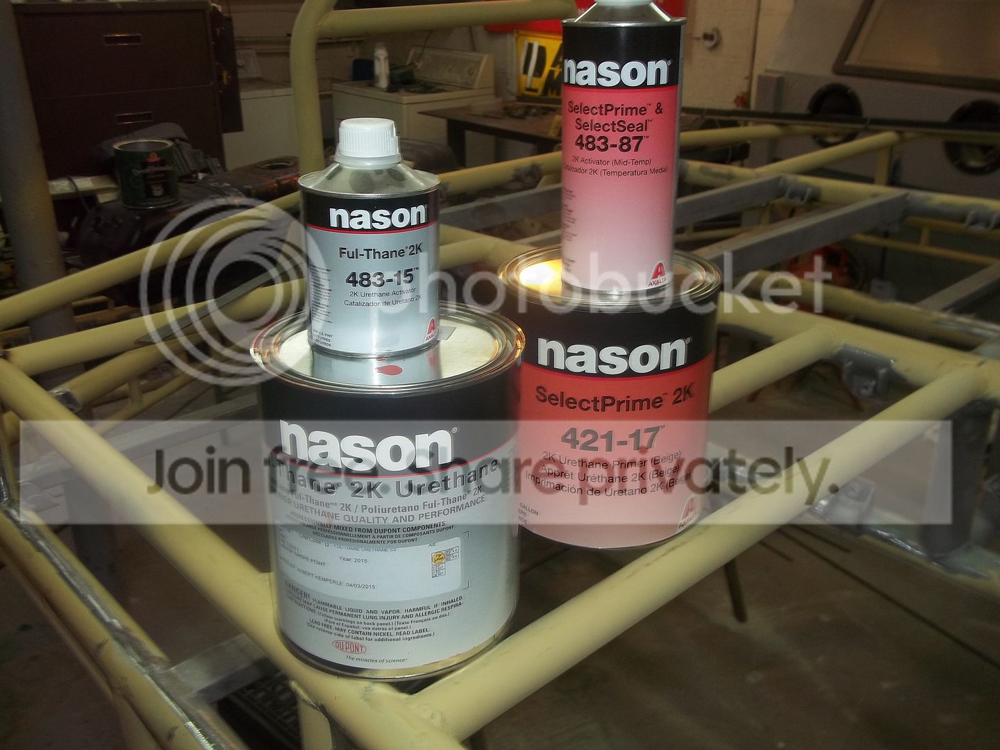

Mutt materials...
primer and Ryoken red...

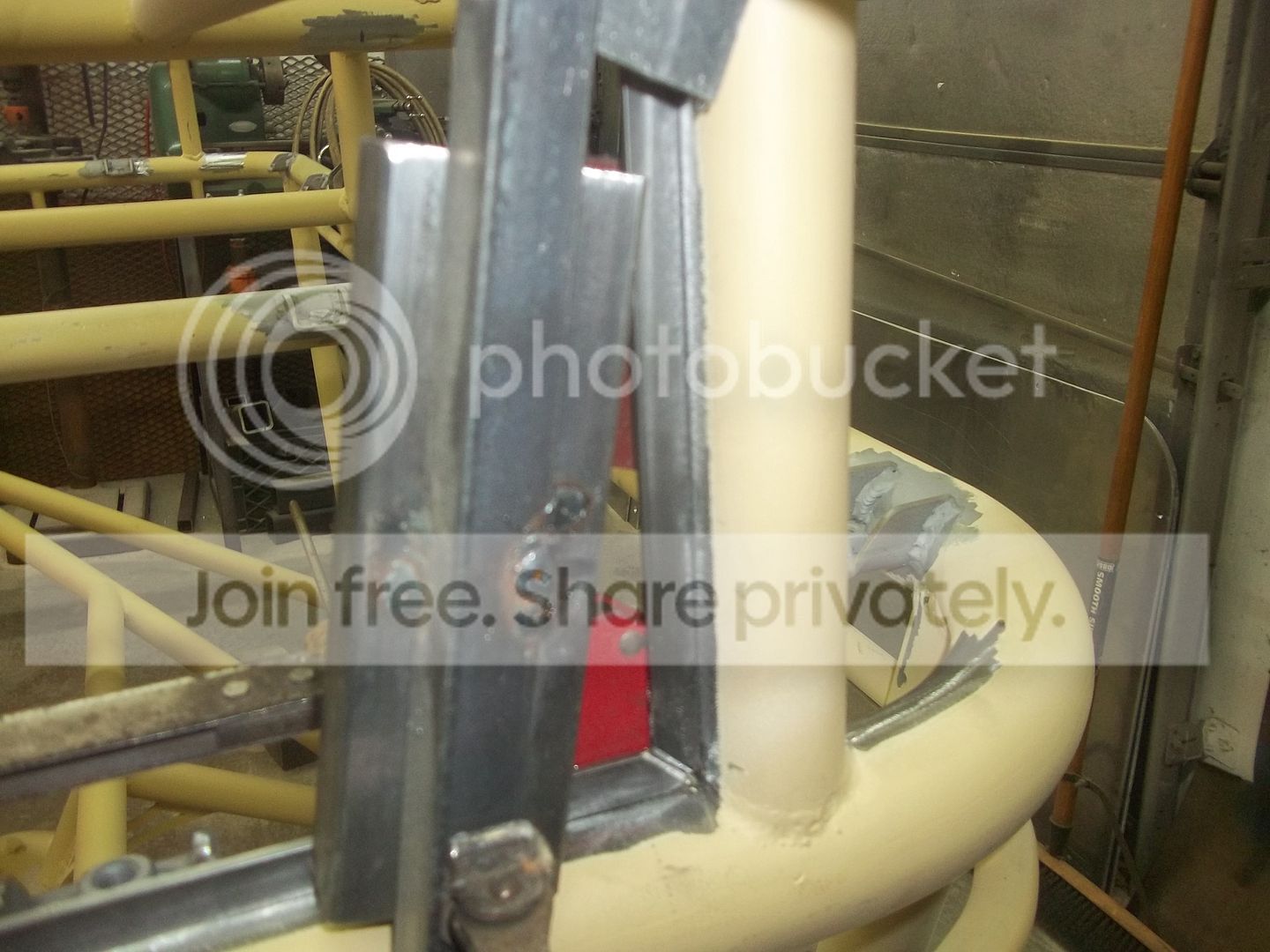

just came up from working on the side door/latch framing...

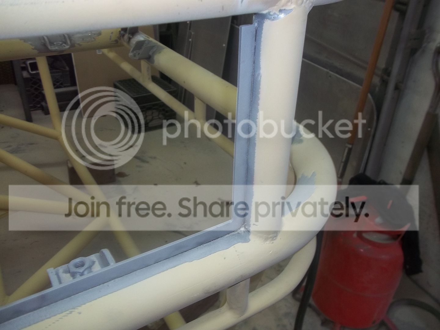

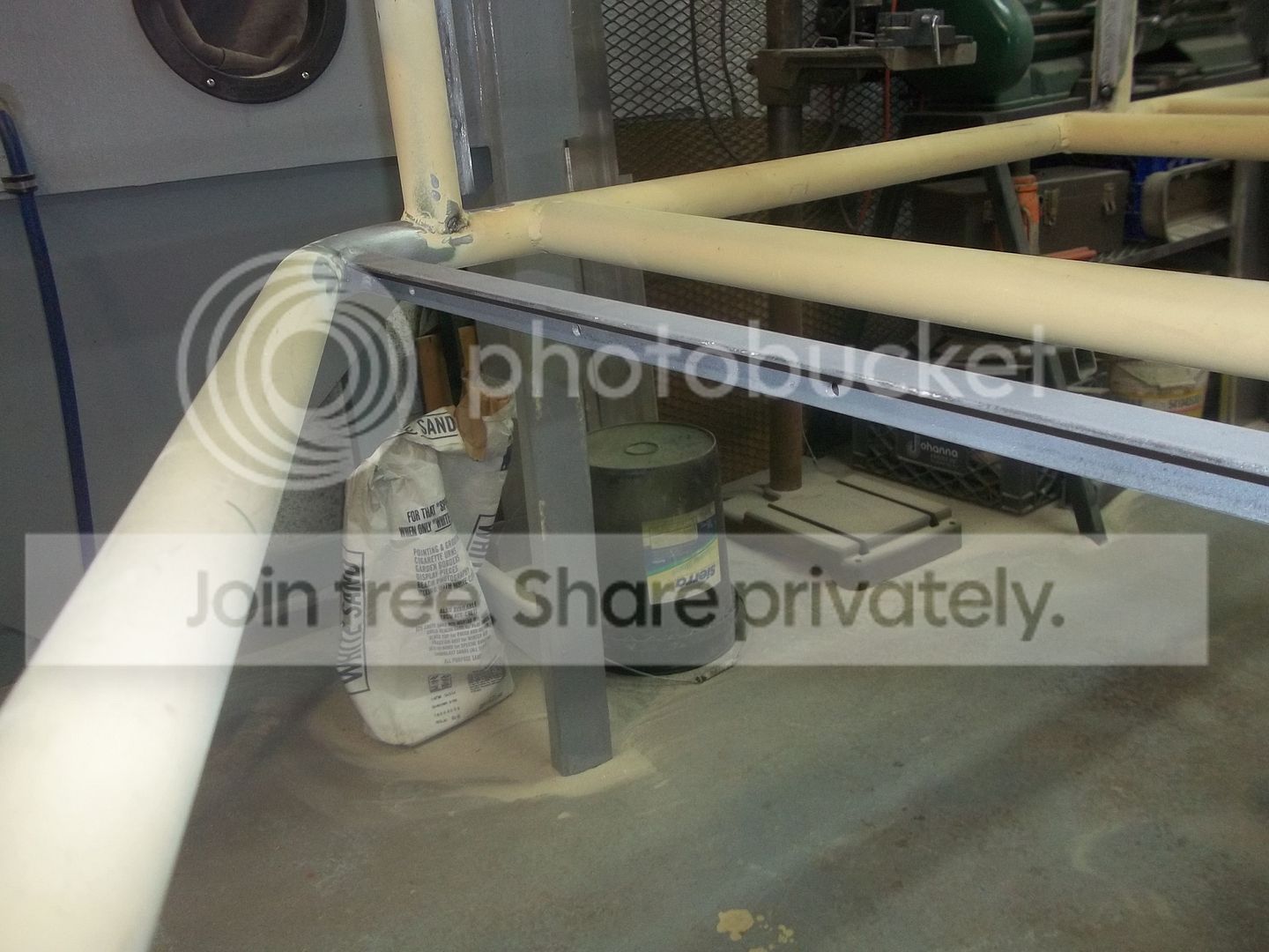

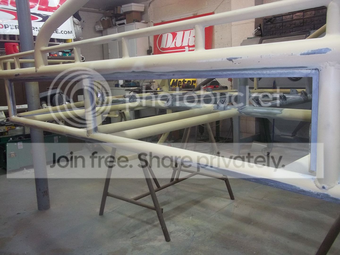

setting up the 1/2" x 1/8" strip steel... goes up the sides, and across the top for the latches to catch.. and for the alum doors to close up against...
this is obviously upside down currently...

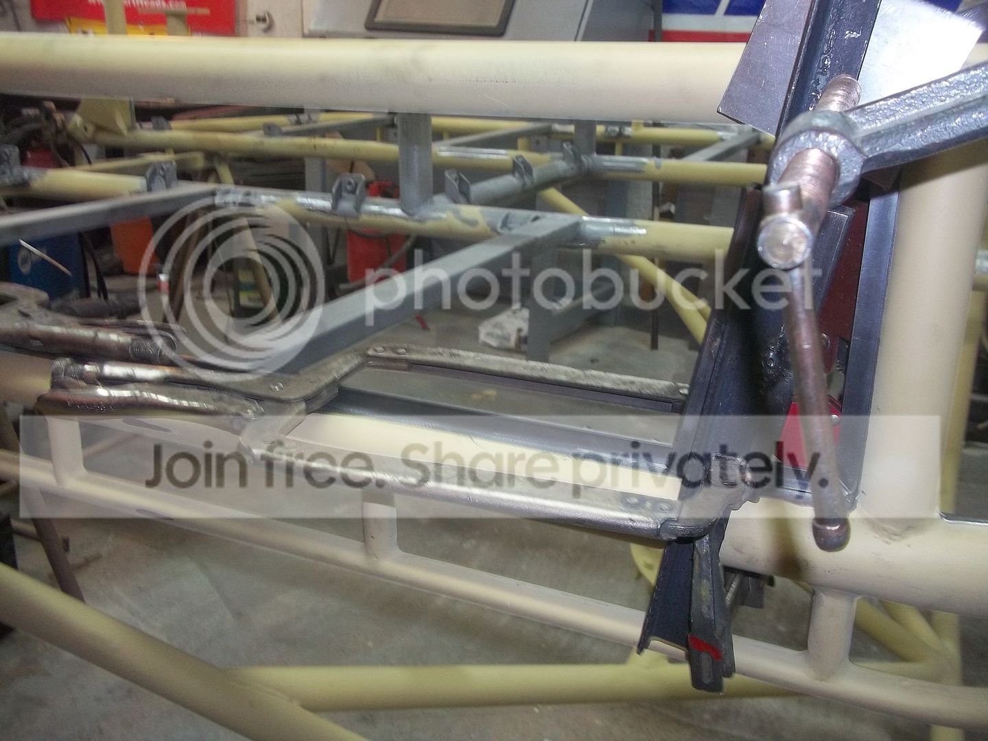

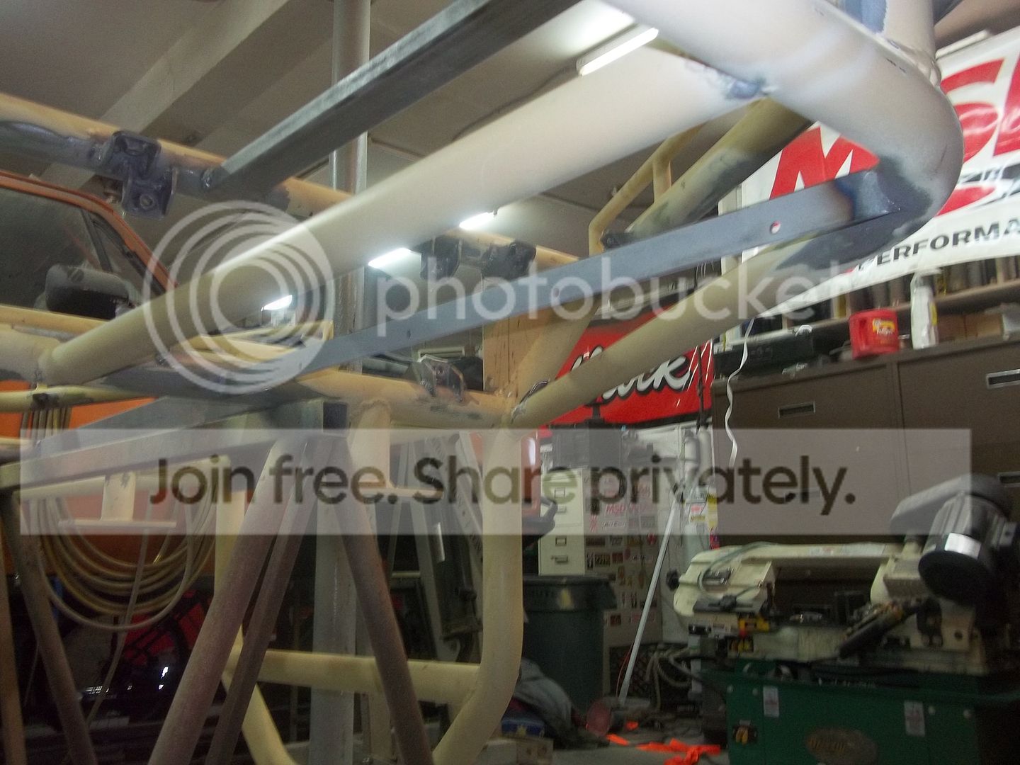

this is one of the 2, special weapon, homemade tools I've been using to make sure all the alum panels and such end up exactly 1/2 way in on the tubes... a piece of 1" rect welded to some angle iron, clamped in where needed..
you can notice at the top, a piece of 1/4" alum clamped between it and the tube... that is cuz the one tube is 2", and the other 1.5", so it spaces it off to get a perfect center...

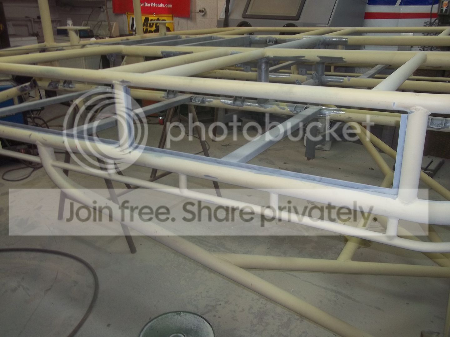

frames are done.....
the sides are down (up) a 1/2" so I can run the hinges full length on the doors....

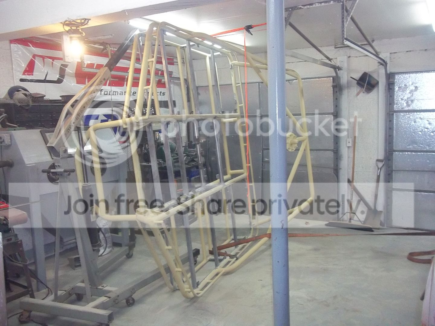

teeter mode....... :whistle: :popcorn: :pimp:
righteous side up again....

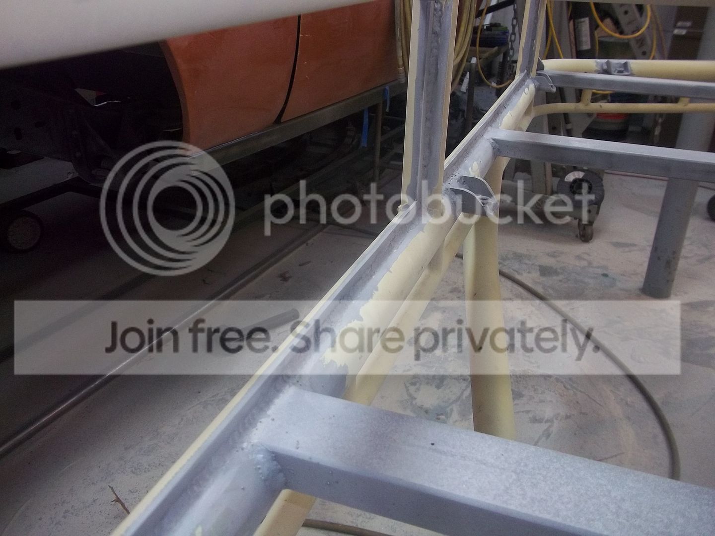

1" x 1" x 1/8" angle for the mudflap mounts....
and here's a shot of the frames the right way.....
