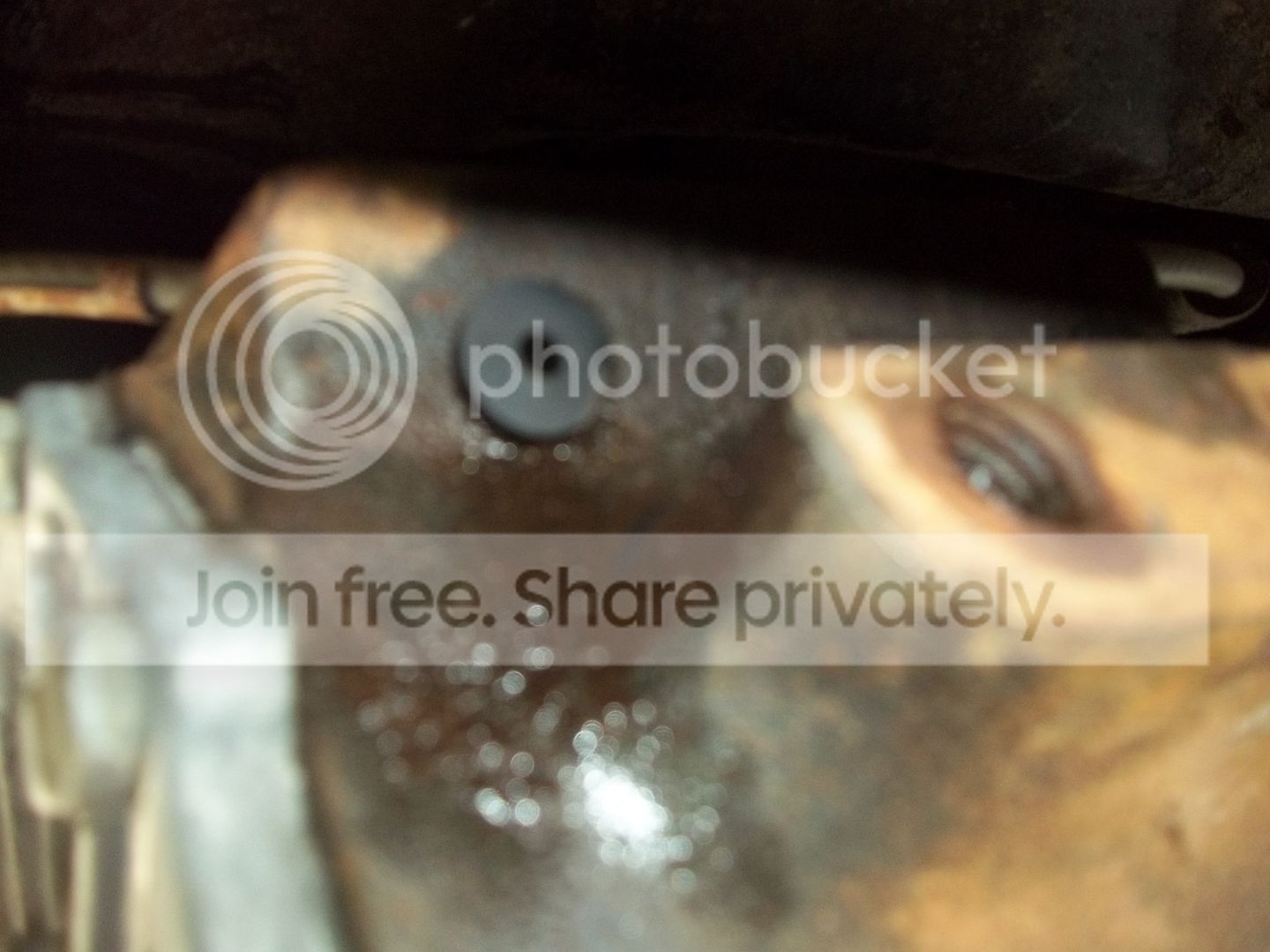

also what's with the later 205's and these rubber plugs? that's where I'm leaking from.. iirc (been awhile), my older one has alum plugs you drive in or similar? :dunno:
nobody has any info on these stoopid things? :dunno:
Mine has pipe plugs in it. Might soak one in silicone, pop it out, and see if the hole is threaded? If so, easy to put some rectum-seal on a pipe plug.
-- A
Pipe plug is not standard. In the late model case, the holes are too big. I put threaded plugs in a early model case, but couldn't on a late model case.
Hmm. Mine's from ORD, so they may well have drilled/tapped it during rebuild. Sorry :(
-- A
I found this about those rubber plugs and a replacement but I see JDNobodi beat me to it
Most late 1978 and later NP205 transfer cases used QU10679 Rubber Plug to seal the four transfer case access holes. QU10679 is now out of production and no longer available. In most cases either plug type worked just fine, but if the transfer case breather plugged up, the rubber plugs could be forced out of the access holes as pressure built up when the transfer case heated up during operation. This did not happen often, but when it did, oil would blow out the now open hole(s). If this problem was not caught pretty quick, you ended up with a seized transfer case. For that reason, I feel these steel plugs are superior to the rubber plugs.
http://www.quad4x4.com/qu50224.html
good info, thanks guys... :waytogo: yeah, my older one has those metal ones.....

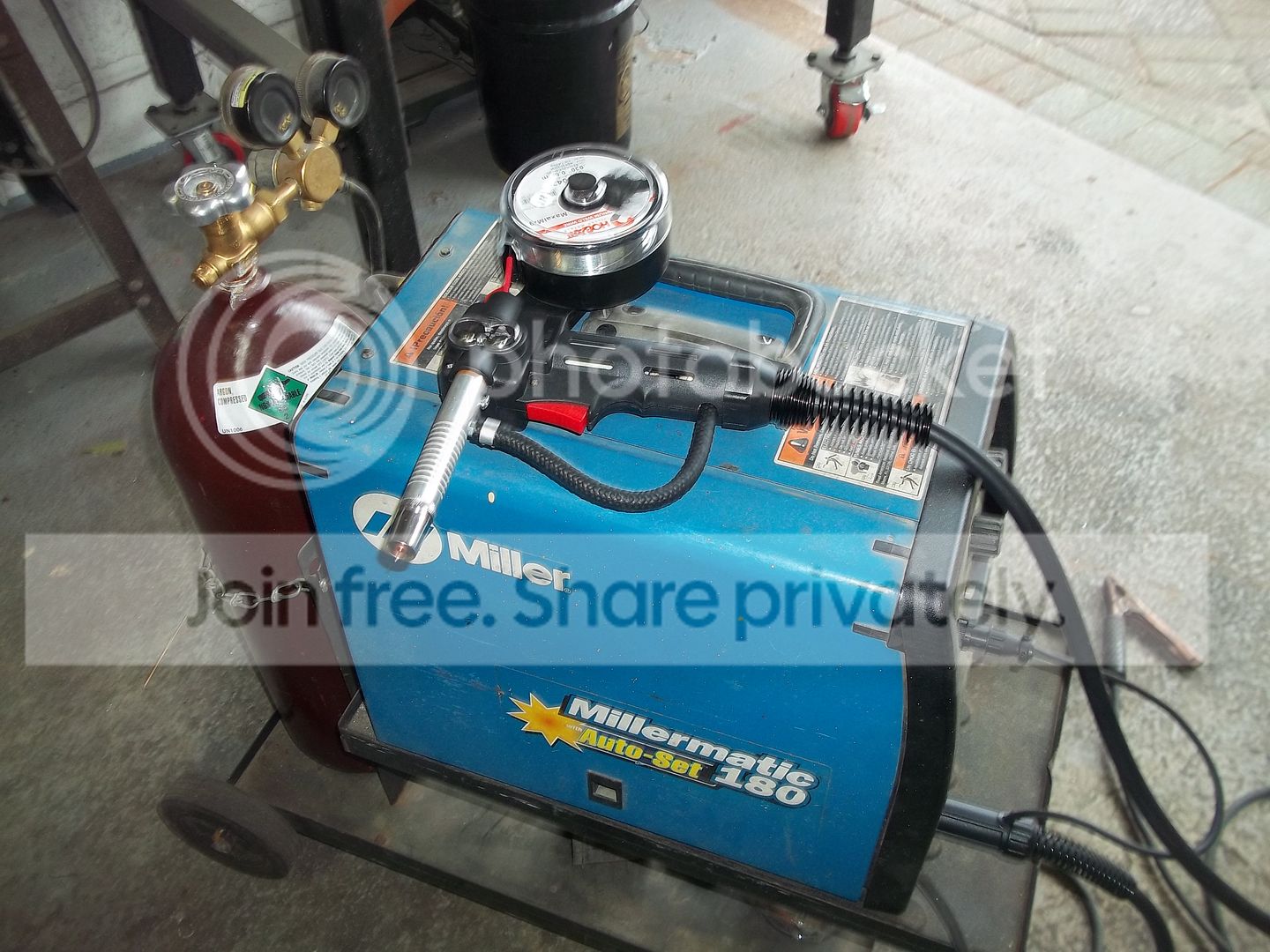

start messing with my alum welding today... :weld:
