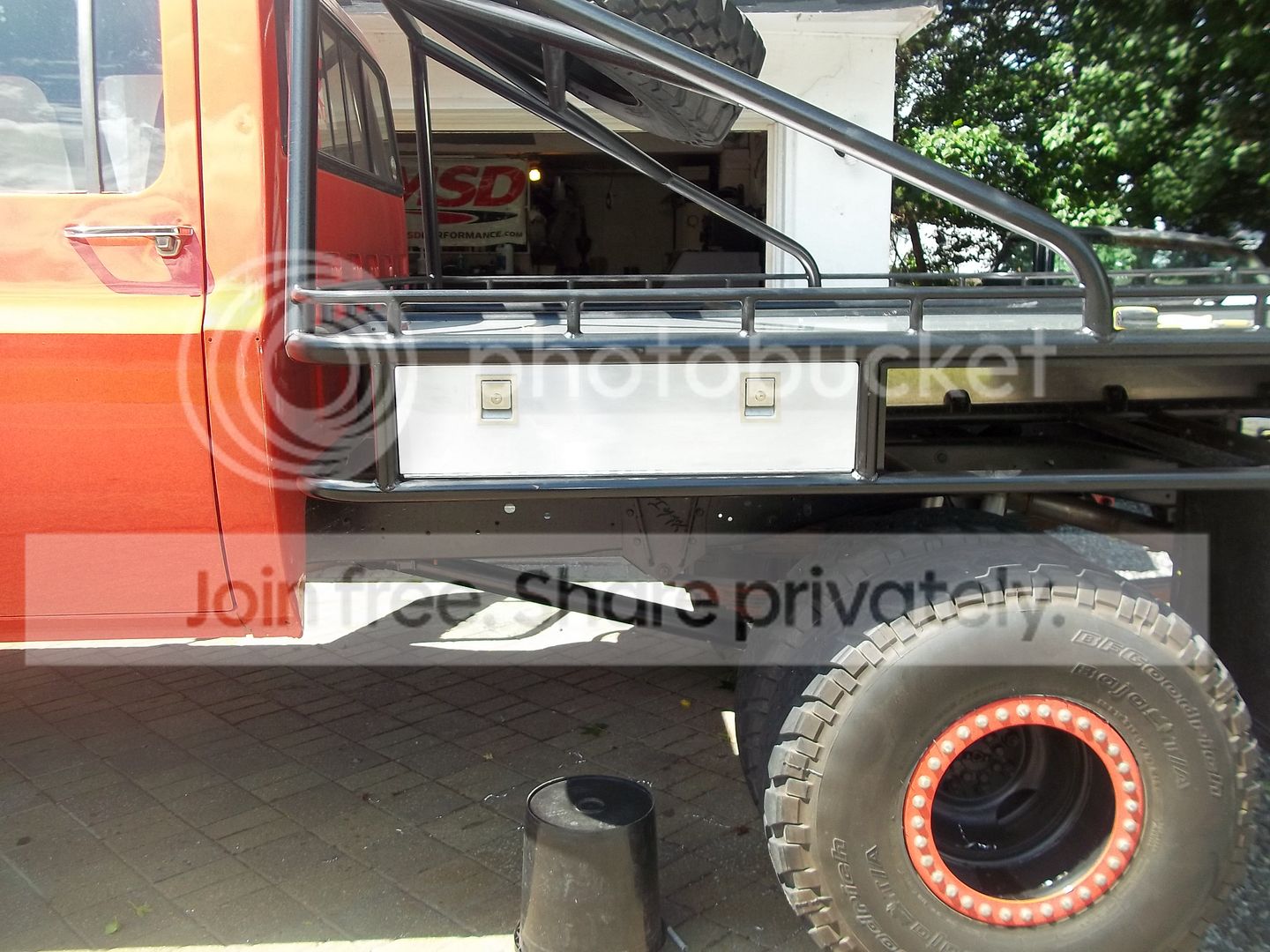

I think those latches loo on pretty good. Fits the truck well. Only thing is is that the front one looks crooked, could just be the angle of the picture too.
I just didn't bother straightening it when I snugged up the back nut, being it has to come apart for burnishing...... the holes allow for a little bit of wiggle room...
Looks great! You don't think you could get away with a single latch? Two latches and two locks seems like a PITA. But looks awesome.
thanks... with the width of the panels, I felt 2 was better looking/more proportionate, and much more secure in it's actual closing...
they all have locks cuz I had to get all 10 with locks to get a deal... for the most part, I'll just lock one on each door at night..... you don't need to "unlock" em every time you open it..
but it'll be nice to have that added security if I think I need it, considering 1 or 2 of the drawers could have thousands in Snappy tools in em...

oh... and what does everyone think of my latch choice? :ears:
I think the look is spot on IMO...
I think they look super!
I like the ones on my box...but yours are cooler with the hidden fasteners. :thumb:
thanks.. :D
I think the paddle latches where definitely the way to go..... those are actually medium sized.. with the panel height, the larges would have looked stoopid...

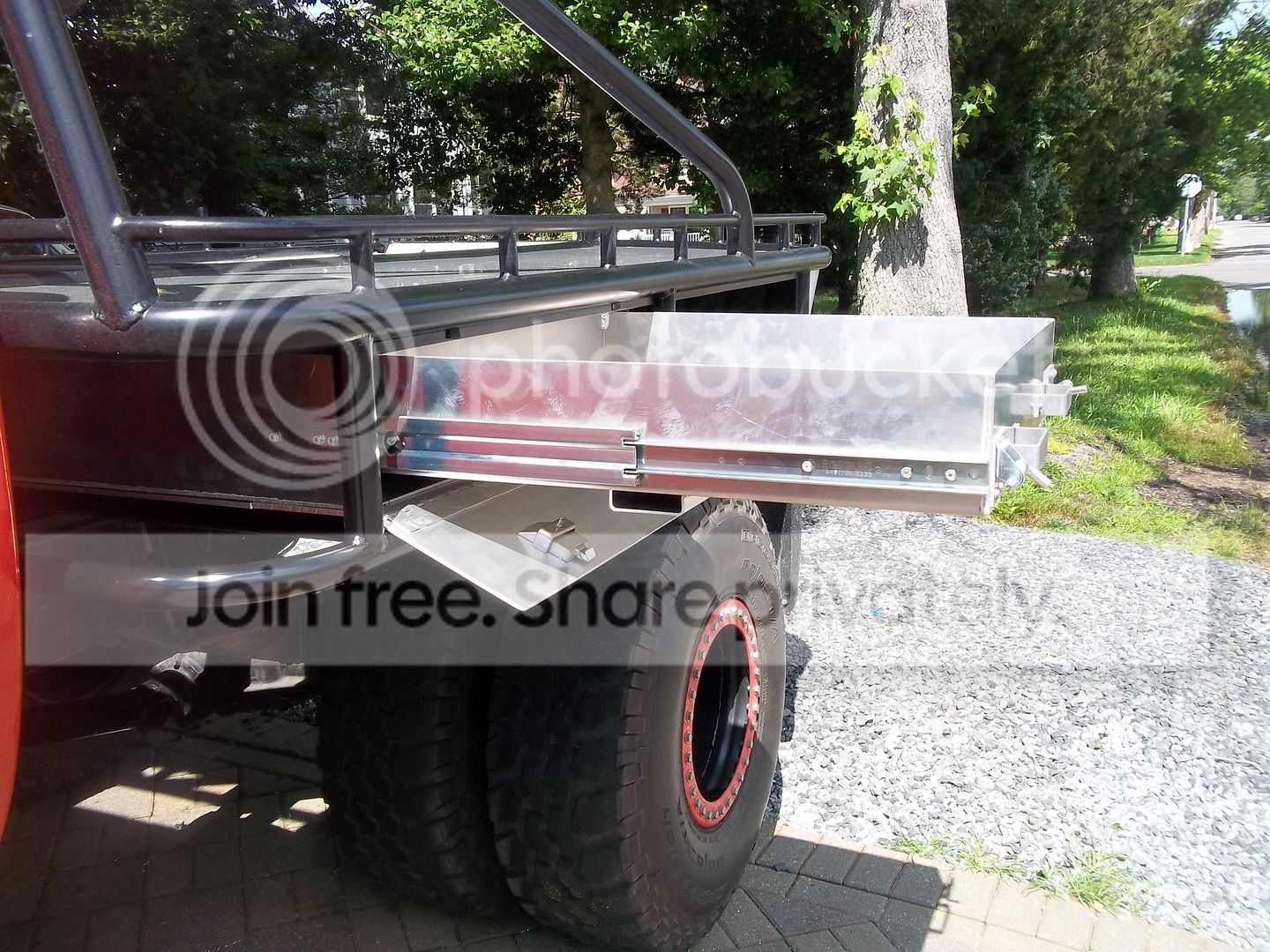

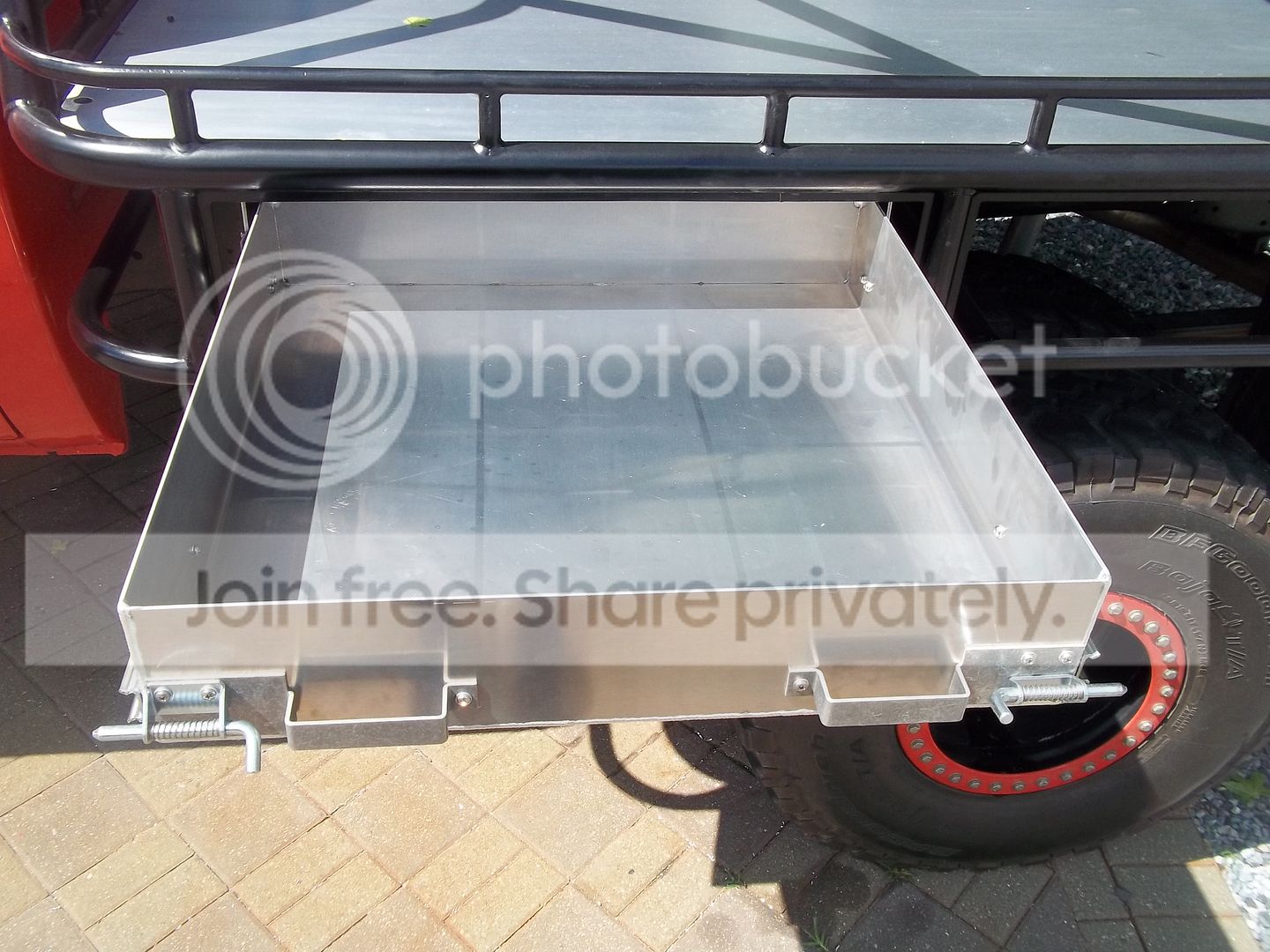

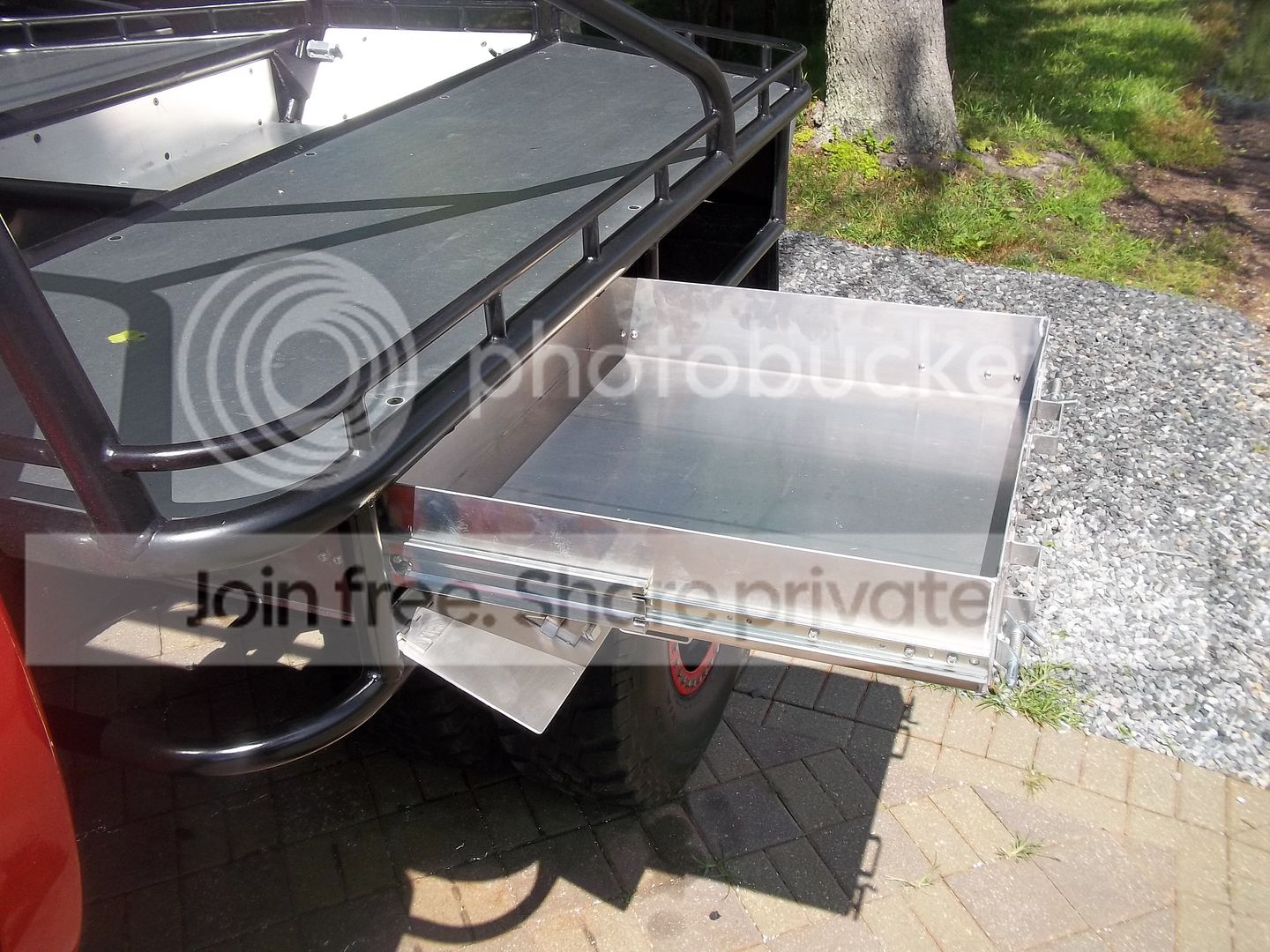

1 down, 3 to go...... slutfest ensuing....

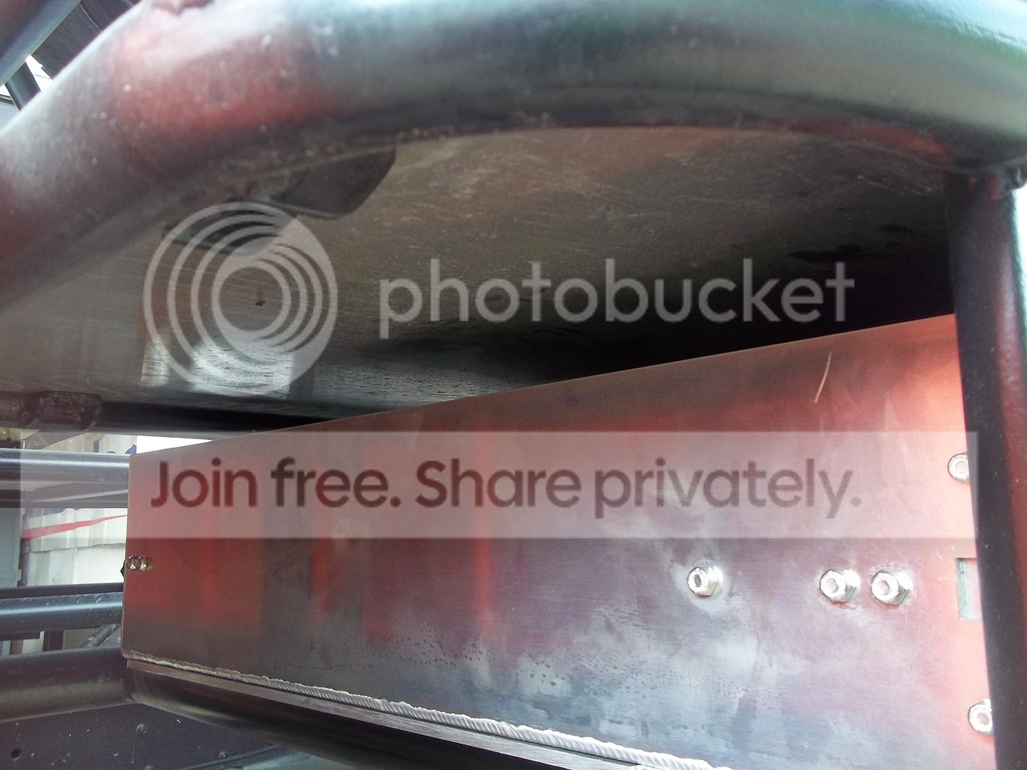

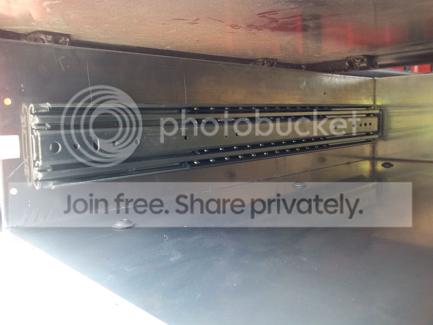

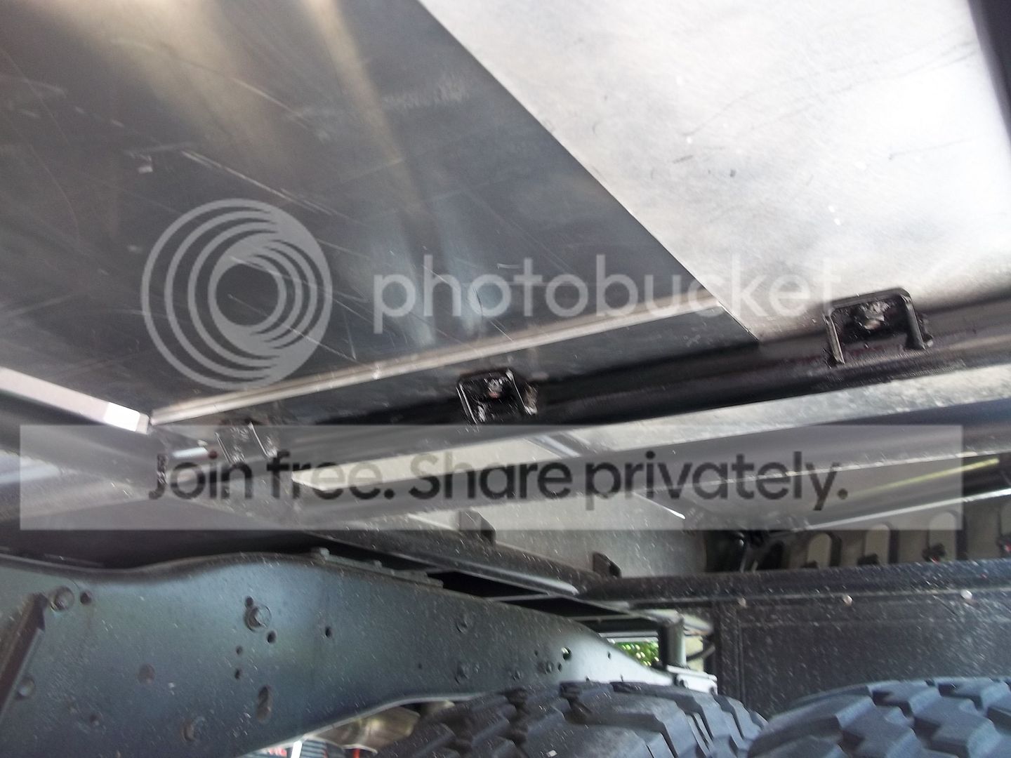

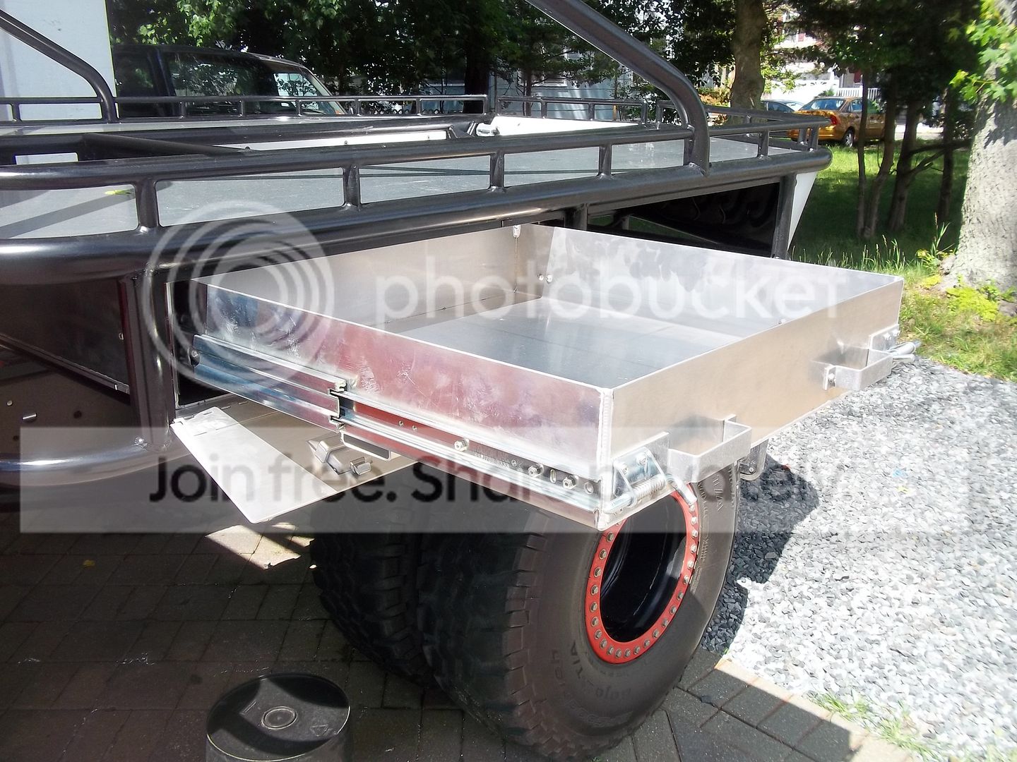

here's a few without the drawer in to show the sick slides and the mounting, 3/8 button heads
to Kert's panel mounts.... 1/4" spacers... all that will be hidden by the hangin boxes and underskin...

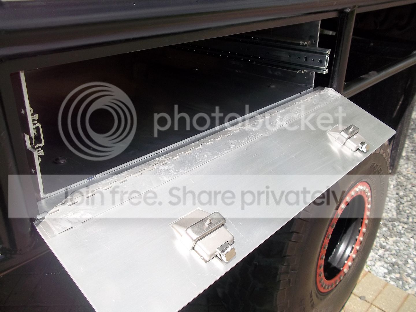

here you can see the hinge setup...
you can also see in this shot why I'm going to put a top on the units when I have dividers put in... note the 1.75" space above the open top drawer...

One thing I didn't see any mention of it and you may have thought about this. The drawer covers ( not sure what to call em) the aluminium with the latches and hinge on it. Might be a good idea to have a limiter on that. I realize the tube probably stops em just fine. And since it's hard to see its hard to tell if you actually need it or not. Might help to keep stuff off the paint on the tube too
Also I dig the latches. Here is another reason 2 is better than one. Wind. I built some side boxes out of steel a while back. Put one latch on em. At certain speeds with certain crosswinds the wind would try to open the box. 2 latches solved the problem. That and we put some 1/8 rod around the edges to stiffen up the outer cover
for now using the tube as a stop seems to work pretty good... it is laying on the tube in those pics... it was kinda dumb luck that they seem to open just about a perfect amount... plenty for the drawer to clear, but not excessively hanging...
if it starts to become a wear issue or something, yeah, I'm sure I could come up with something so they sat an inch higher at the end or something to keep off the tubes...
good eye.. :waytogo:
