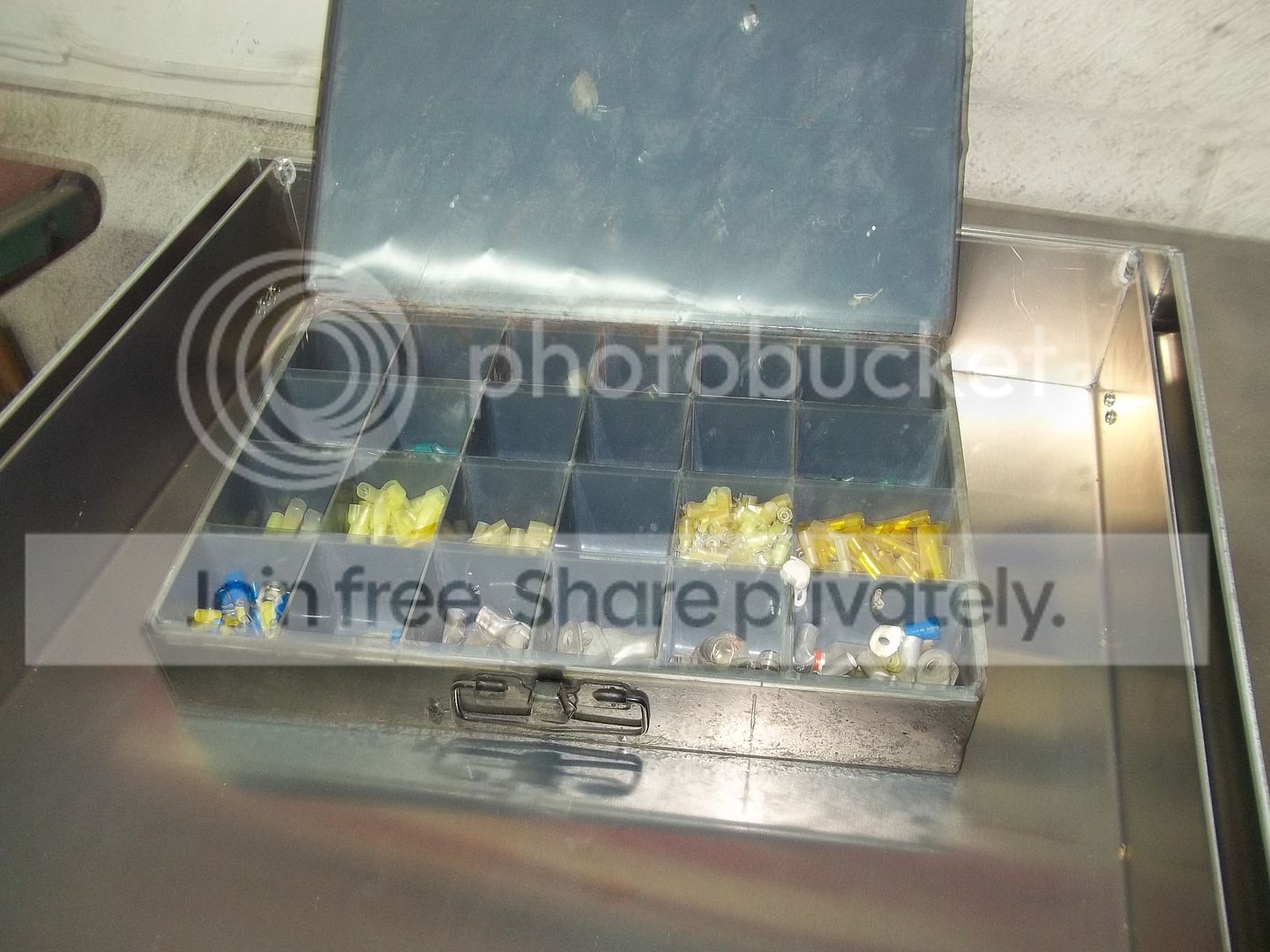

ANYWAY, where I need input is for the hardware/parts one.... any suggestions on containers for in there for bolts/nuts/screws and such? I'm thinking things that have tops would probably be good and can stack in there side by side and utilize the space well...... like square-lidded plastic Tupperware or something???? :dunno: :haha:
I wanna start looking around at things so maybe I can buy some over the next weeks, so I can modify my dividers exactly if I find a good solution, so everything fit's great...
the drawers are about 5.5" deep.. I'd like to utilize that well.... I have a bunch of these
but they only go up about 2/3 to the top, couldn't stack 2..... ideally 4 smaller ones like this to take up the whole drawer footprint, and deeper would be ideal...
but I'm wide open to suggestion... :confused: :popcorn: :ears:
this will be nuts, bolts, screws, electrical connectors, cotter pins, switches, smaller parts...
obviously it would nice to just have the whole drawer turned into like 4" x 4" cubby's to the top edge, but I'm thinking that may drive the welders nuts and cost a bunch more than a simple 6 or 4 compartment deal.. oh, and if the containers reach near the top, they probably wont needs lids, as the top I'm adding is literally 1/8" above the drawer or less...

Go to your local Sporting store or tackle shop and look at Plano boxes. They're a lot like the divided box you posted but their dividers are moveable. They come in all different sizes and shapes to accommodate different lures, plastic baits, etc. I use a bunch of them in the wood shop to hold pen bushings, drill bits. . .
Bring some tools and/or hardware you'd expect to put in them to get sizing. They have lines for other stuff that may be adaptable, too. Ie, their fishing line spool boxes look like they've be good for holding spools of wire. They have waterproof models, tool boxes, gun boxes.

I like the idea of using a bunch of random-sized Plano boxes to mix-and-match a combination that works for the things you carry. It probably makes sense to avoid welding in dividers right away. It will probably take some time to figure out the exact amount and quantity of parts, and which Plano boxes will work best... So you probably want to get that all dialed-in before building permanent compartments. :thinking:

I'd try to avoid the harder plastic type. They are brittle, especially in the cold, and would be prone to cracking/ breaking after bouncing around in those boxes. I'd try to stick w/ the more flexible type of plastics, think tupperware. You could also check your local dollar store. The ones by me have a pretty good assortment of plastic kitchen containers and they're cheap compared to name brands. I recently bought a bunch for the pantry that are perfect for holding bags of flour and sugar.
Why not just buy some flat bar of the appropriate width for your drawer depth, and then cut slots in them to make your own dividers. No need to even weld them.

I like that idea, thanks... :waytogo: might work good for the hardware drawer, and changable down the road by just adding some more slots here or there..
I'll keep it in mind when I go pick up more alum for the other projects.. thinking maybe that idea combined with some Tupperware type containers might work very well, and be flexible for down the road..
gonna hit the dollar stores this weekend and look around for possible containers..

with that above slotted method I could make 36 4.25" x 4.25" cubby holes.. it would require a 4' x 26" piece of 1/8's...
