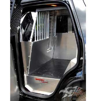

Stop by your local PD and ask to check out one of their K9 cars before starting the kennel. The units they use have a couple trick features you might be interested in.
anythng in particular?
my one concern is what exact kind and size of expanded steel is good... I'm concerned about the pooches claws/pads... I really think it needs to be something that's round... like a chain link fence kinda deal, but with a bit smaller openings and definitely a bit thicker for rigidity..
expanded steel isn't probably the right term I'm looking for... :dunno:
There is the rubber coated expanded steel. I'm not sure where you can find it but I think that would work perfect.
I can't wait to see this part come together. The transformation of this truck is amazing:waytogo:
hmmmmm, maybe that's not the best solution...... vertical square/round tube might be a better choice..... seeing a few setups designed with that instead too.... definitely seems like it would be safer for the pooch to not get a paw hung up......
