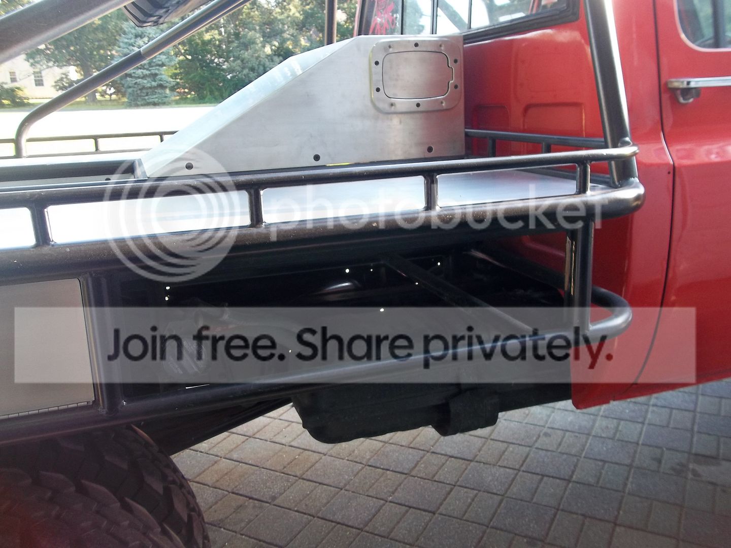

I was going to ask if you are going to put a matching box on the other side then realized you still have the factory fuel tank on the other side. Where exactly are you planning to put the new fuel tank.
the new 70 gal goes in the middle. under the doghouse... I can't build the lower box for the other side (dual bat box) UNTIL I install the new center tank.. and thus can remove that passenger side saddle tank.. where the box will hang...
I'll also install the forward drawer on the ps at that time too... I can't put it in cuz my temp fuel fill for the factory tank is in the way....
here's how that side sits now, and until the new tank goes in..

forgot to post a couple of the box interior.... it's actually quite a large space, being 30" deep or so.....
oh, and I'll be running the same rubber bed mat stuff that I run in the back of the coffin, on the bottom of that box...

Are you going to try to seal that lower box? You know like a bead of silicone along the seams and/or a gasket on the door?
as with the rest of the fixed alum panels, they will get a dress bead on the exterior of black silicone... but the boxes will also get beads on the interior corners too..
all the doors, lower and upper, are set up to have a thin, soft weatherstrip on the door stop/lip to seal the doors... I'm waiting on installing all that till all the doors have been fabbed/finished...
