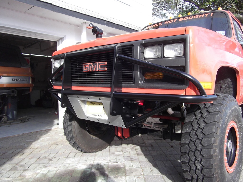

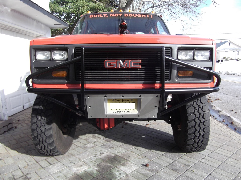

wish i could.... there are multiple things that will make it goofy... one it really hinders the turn signal view.. it's WAY tight in that regard to begin with.. it was an issue when I first built the bumper, and it will just get worse... two, it will look goofy height-wise with the grill/toptube/GMC, in addition to the standard valance issue...

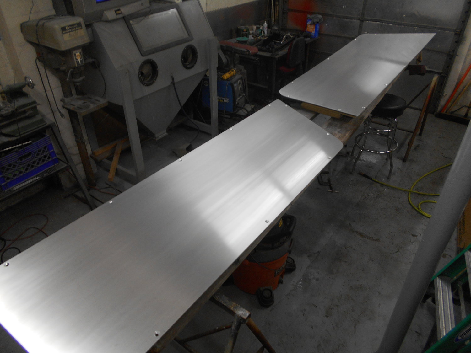

last AL batch.. stoked.. hope i don't run out of Sharkhide... :doah:
the epitome in my life... the last 2 per se, and most challenging... I'm tempted to use a 6' paint pole and sheetrock thingy with a maroon scuffpad on it!!!!!

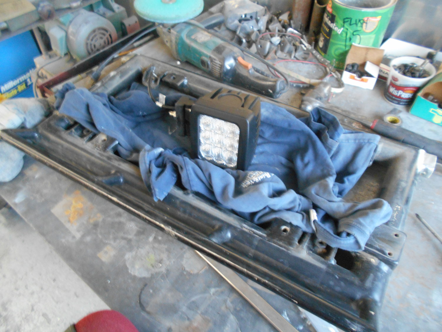

anyway, hoping to get a fab day in sunday and get worklight # 2/3 mounted.. they're badarse, and it's going to be perfect.... bit more welding and I can get to paint on the tubebed...

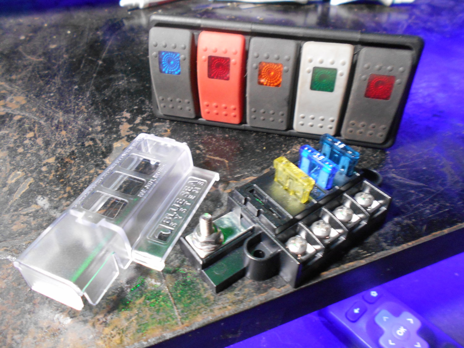

some of the temp stuff for the light wiring.... the mini panel was a freebie and should be perfect for what I want to do... everything is relayed, except worklight #1 under the tire... the switches are left to right, front lightbar, rotators, alley lights, WL #2, 3 and WL #1 amber/white...
