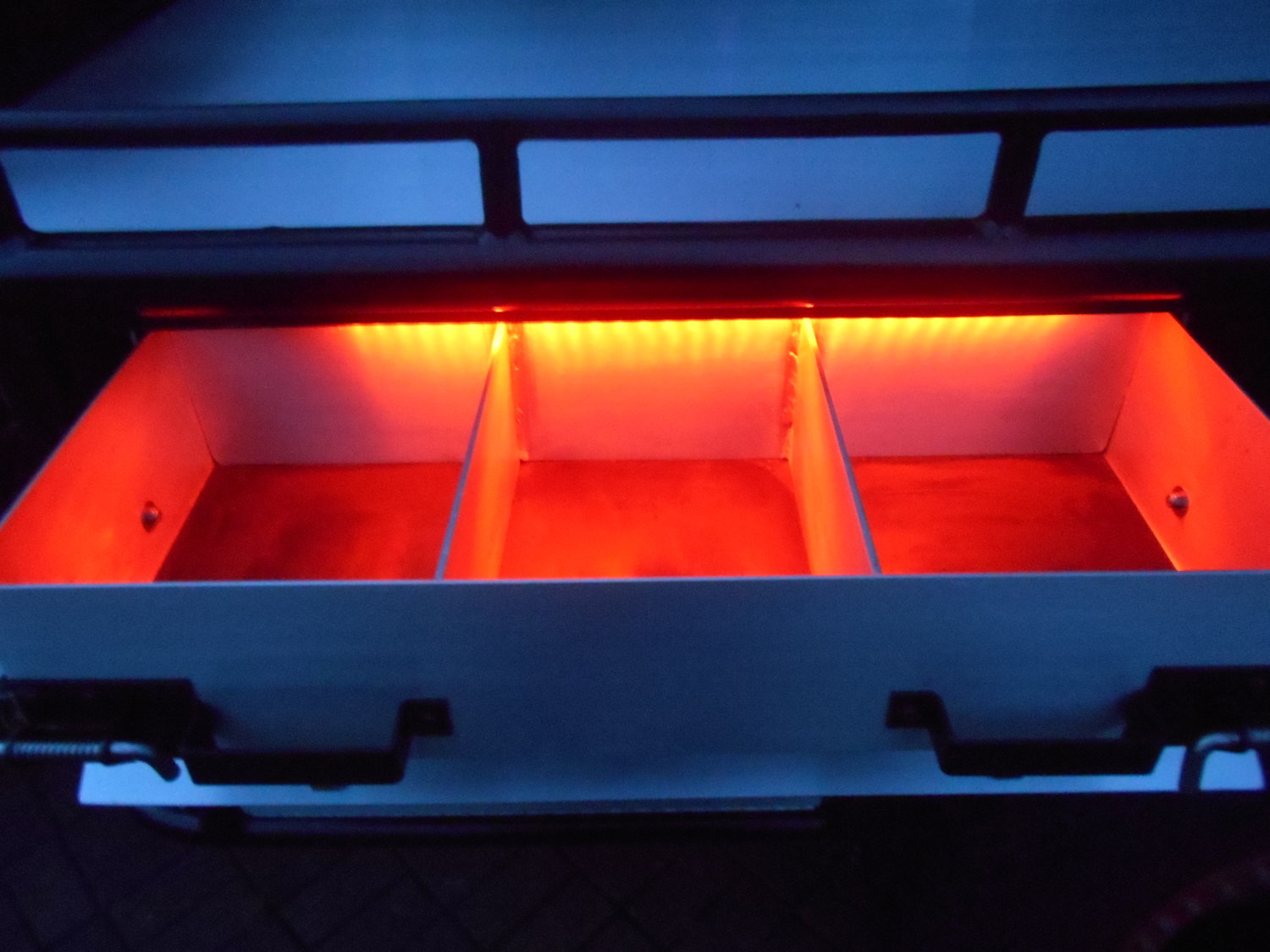

so, my drawer light idea is fighting me a bit... i really want to track mount the lights.... you stick them to the track, than mount the track....
https://www.superbrightleds.com/mor...dized-aluminum-led-profile-housing/1421/3323/
https://www.superbrightleds.com/mor...us-24143-led-profile-mounting-clip/3447/7367/
much more stable app than trying to stick directly to the underside of the removable top panel, than going around the couple supports and panel mount tabs... it also allows me to use a clip-in diffuser lense... this eliminates the hotspoting of the LEDs...
https://www.superbrightleds.com/mor...rotracted-round-frosted-lens-gip-l/1424/3325/
the prob being, said supports, etc aren't allowing the tracks to mount up high enough due to the lense...... I'll figure sumfin out...

oh, drawer light psychosis has reached stooopid levels.... customs lenses, yada, nutjob, #last2.7%

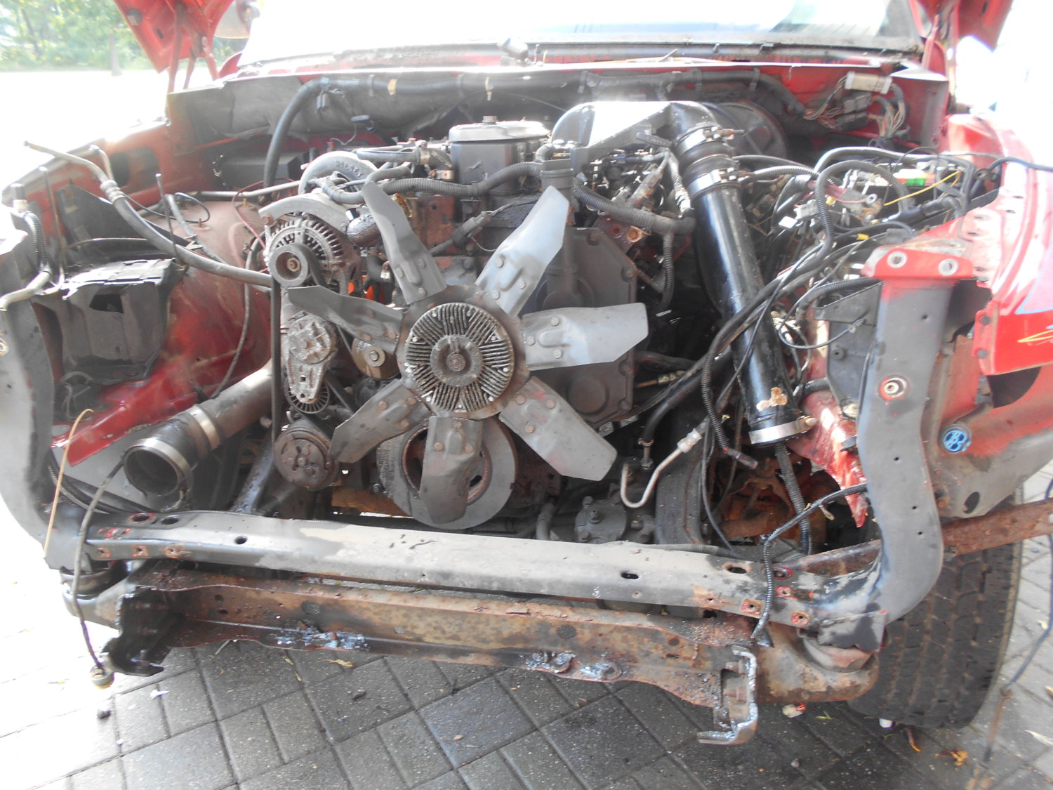

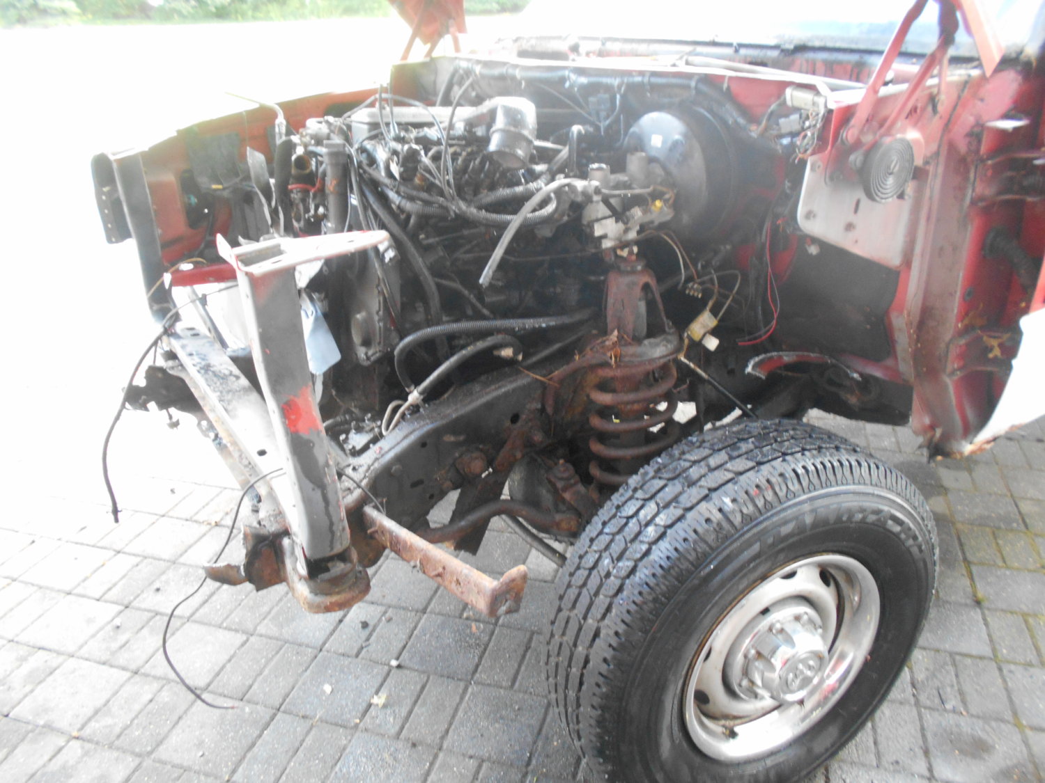

question for my cummins brethren, ;) what are most guys running for radiators on this swap? i'm gonna use the stock intercooler.. the dudge rad looks huge! :eek1: tho I'm not crazy about the plastic end tanks...
Most people put the second gen radiator and shroud with the intercooler all fitted to our core support
If you dont want to modify the intercooler I'd run an aftermarket big block radiator. A nice dual pass Ron Davis like @AgDieseler put in his suburban would be perfect.
