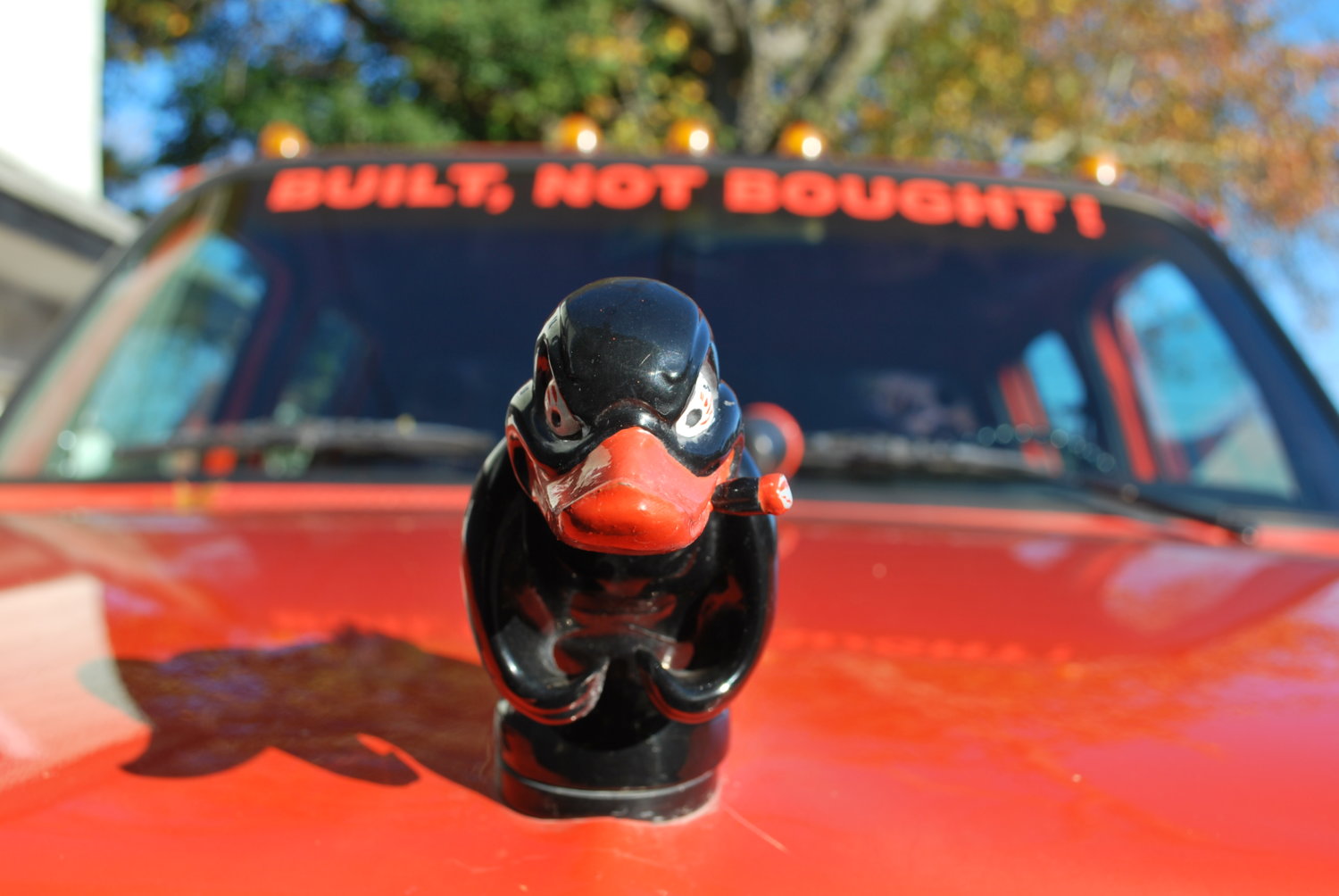

I really like that last picture.

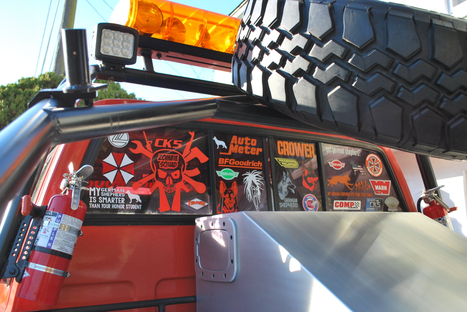

Not sure how you're going to fit a cummins sticker on the back window.
it's my middle finger to popular world.. it's my rig, built for me...
should I hate them??????
ehh, you build a bro-dozer, i hate ya...
I am going to try and keep it as low smoke as possible. A muffler! No badging and pretty low key. Just an old tractor motor with 50 psi.....
snotty BB, got ya covered! no clue what make a good dizzle note... no fuggin tip..... just not sure where to dump it...
That is badass
remote fired with a momentary contura in the cockpit... that remote "clunk" you here from the switch when ya hit the contura makes ya giddy...

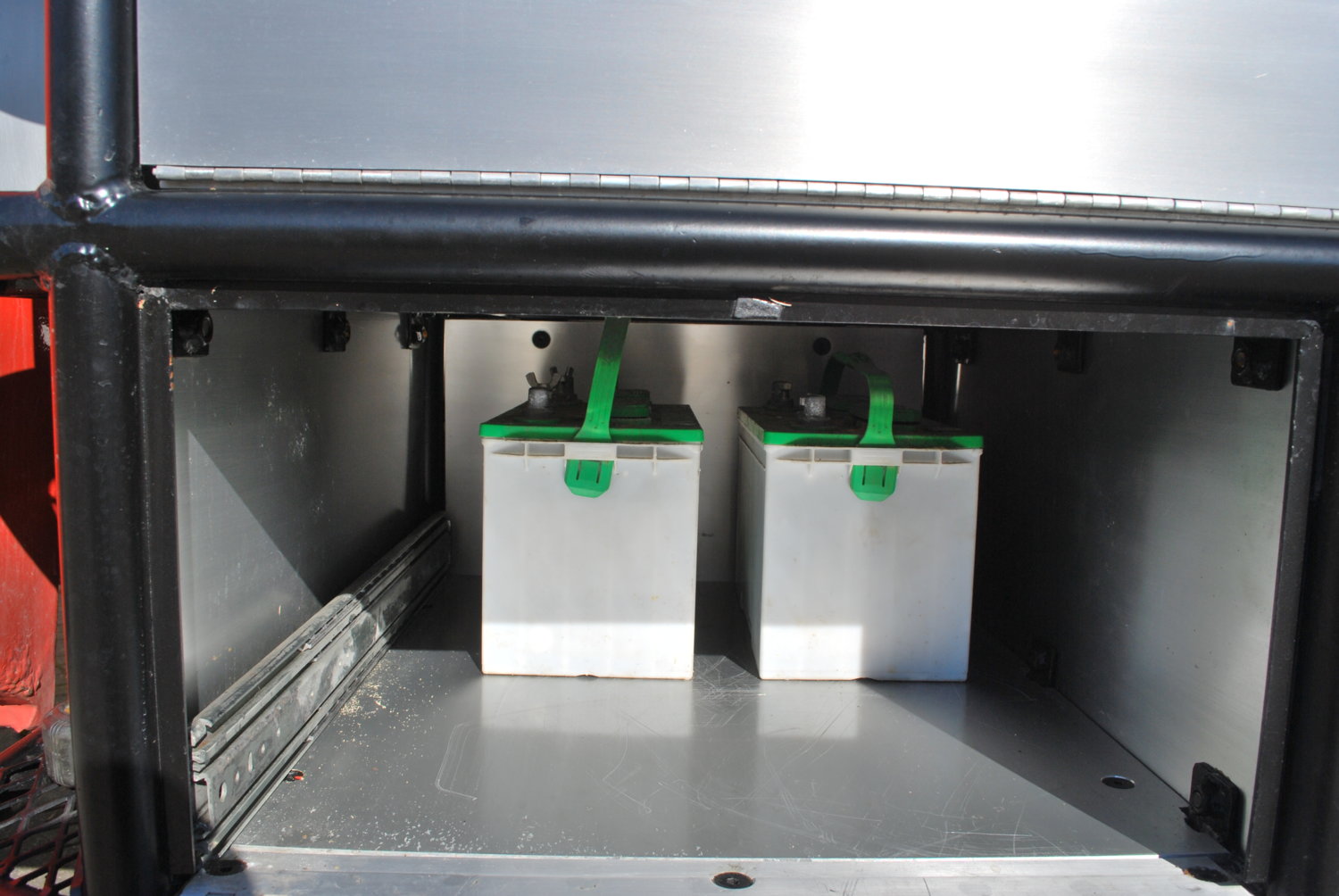

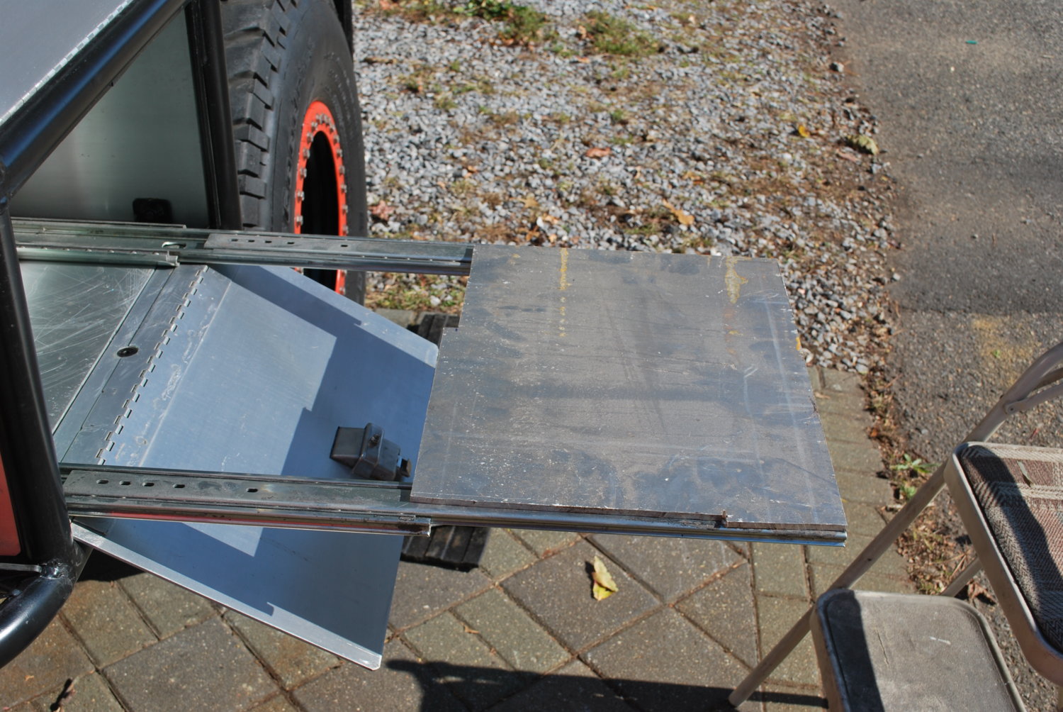

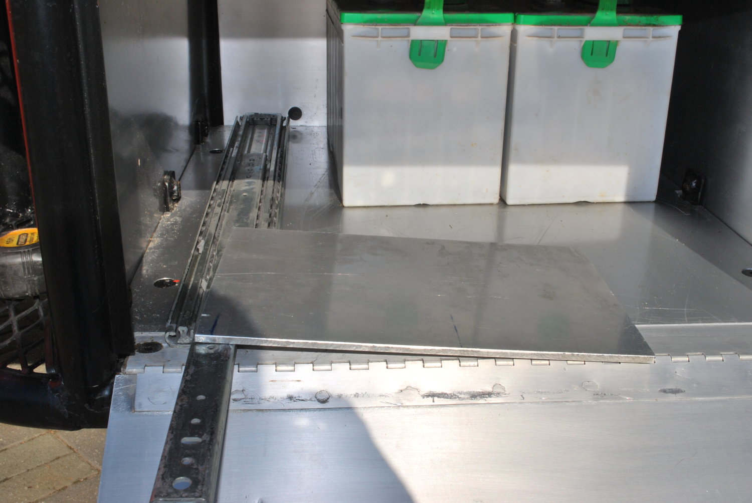

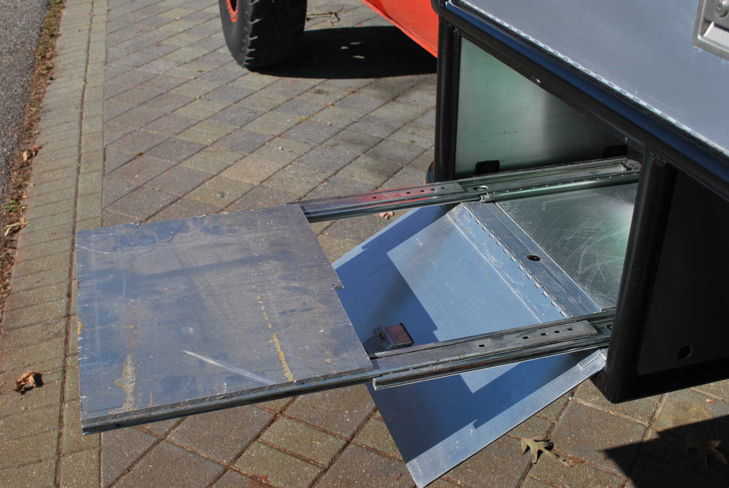

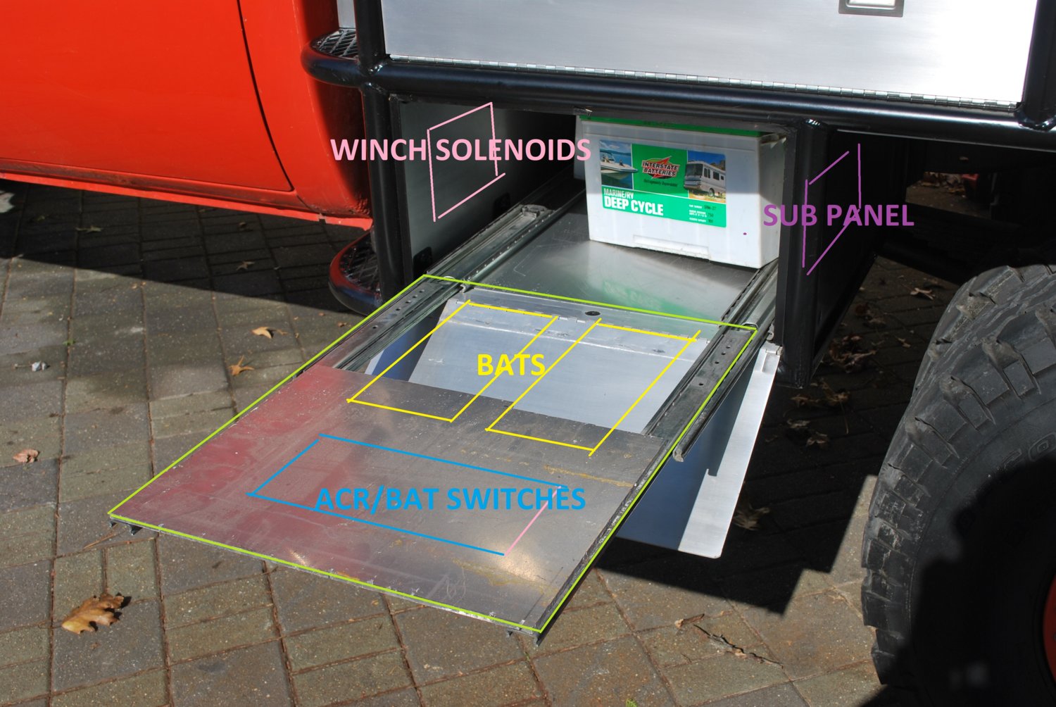

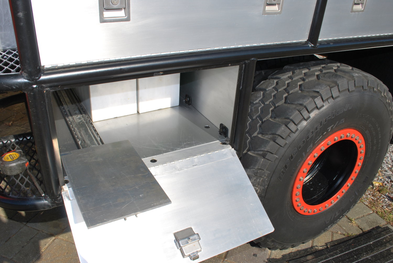

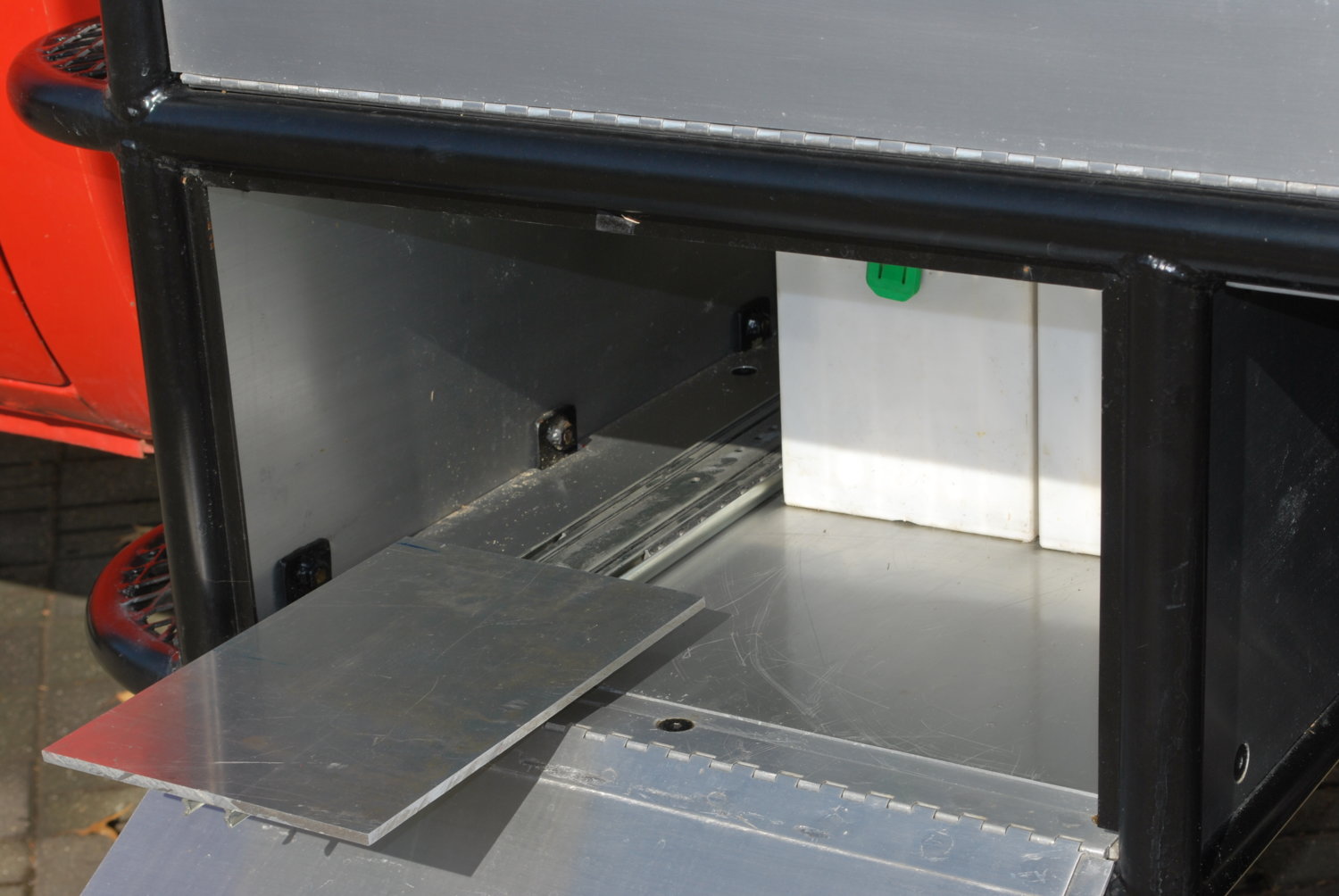

you can see here... the drawer bottom acts like one to an extent, but that area to the left is completely open at the top... it needed to be done at some point, no matter what... more panel mount tabs, yada...Hmm, an idea to utilize the entire box area:

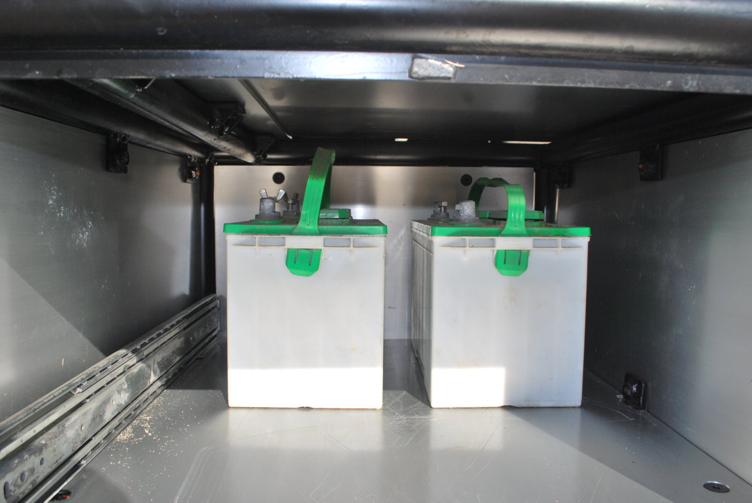

Batts secured at the rear like you mentioned
Have 2 (or maybe more) compartments in the drawer. One compartment to serve as the "control area" with the switches, winch solenoids, etc. The other compartment/s to hold the winch controller and the jumper cables.
For the battery cables, welding cable might be flexible enough to use the non bulkhead fitting.
as a marine guy, the tinned high strand boat stuff is superior to welding cable IMO... doesn't quite bend as nice, but it's oil/grime durability, etc make it a win for me.. we'll see, I'm thinking a bulkhead is gonna be the way to go unfortunately, once i post pics, you'll see what i mean...
