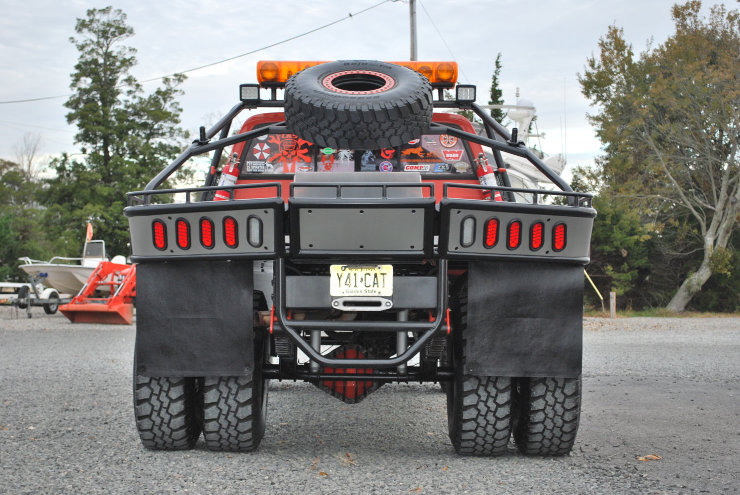

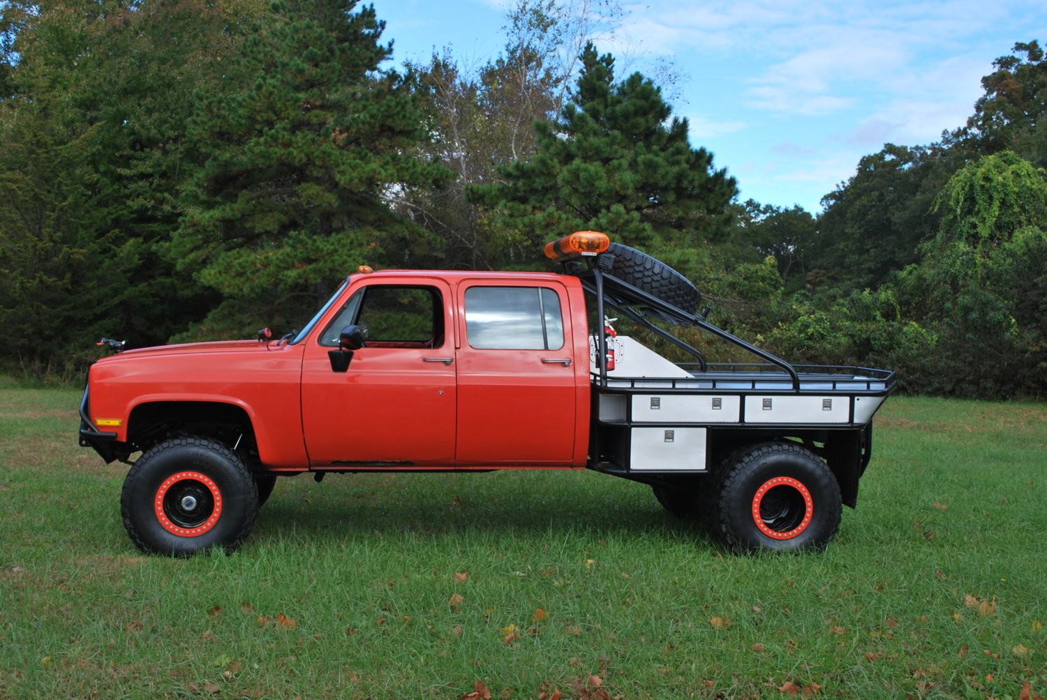

the fronts are just standard US Wheel 70 series steelies from summit.. 16.5 x 9.75, with rim stiffeners welded on..
full
the backs are what make the rig... stock duallies, widened 4" by Kert.... here's pics of the original mockup from him...
full
obviously the same rim stiffeners added to them..
full
full

Badass, never knew that regular backspaced wheels would work on the front dually hubs without sticking out alot.
Any clearance issues with the inner dually 'rim stiffener' and the brake drum?
I run SRW hubs up front... ;) not an ideal spare setup, but with a dually, I can get away with it...
it's a disc set up in the back... it's only the outer rims that have the stiffener...
