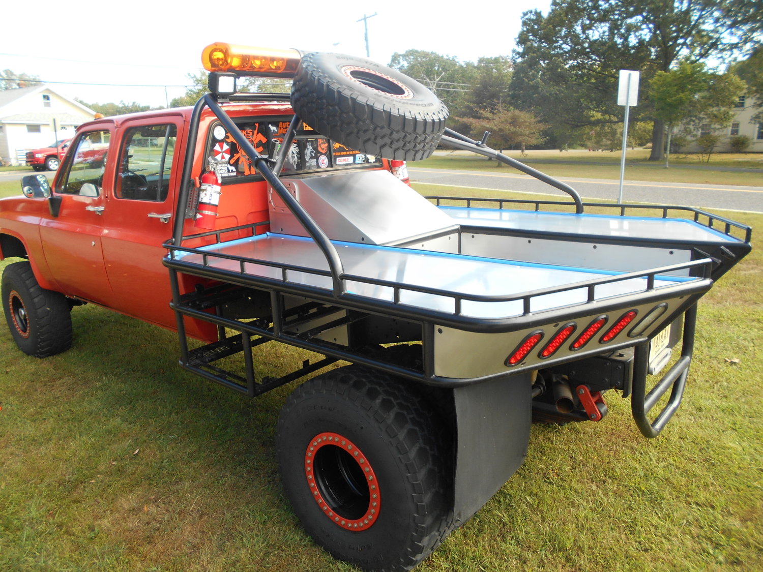

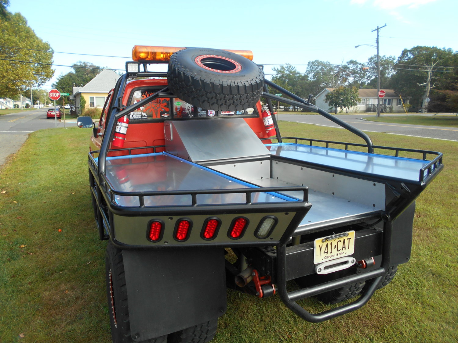

all the ds bed panels need to be cleaned up and reinstalled... I started stripping the ds top, big panel... from water sitting on it, life, the Sharkhide has failed in spots... recoating it...at least, for a "show" look.... I'm ok with the corrosion protection it affords on the undersides, but it is far from a suitable solution to the exposed surfaces...
I really need to consult some honest "coating experts" as to the best route once all panels are "final fit"... whether that's clear PC, anodizing, etc.... they are large panels, yada... I expect the deal to be like 5 g's to do everything (i tend to guesstimate high for happy endings) but at that point in the build, it'll be needed... it's a battle currently keeping everything tits.... :doah:

What is aluminum coated with on boats? I'm sure they have good stuff going on w/ the salt.
When's the oil burner going in... :whistle::D:p
both, are loaded questions.... ;)
marine alum can be found in many iterations, most things are powdercoated these days.... some are painted.... once in a while i'll see anodized brackets on glen-dennings synchs and such.... and "raw" tuna towers and such usually get something like sharkhide... or often coats of woody wax or similar.... I'm guessing clear PC will be the most likely route.. i just don't want to rule out other possibilities like anodizing... I'm also guessing PC will be the cheapest route.... unless i went for something like car clear....

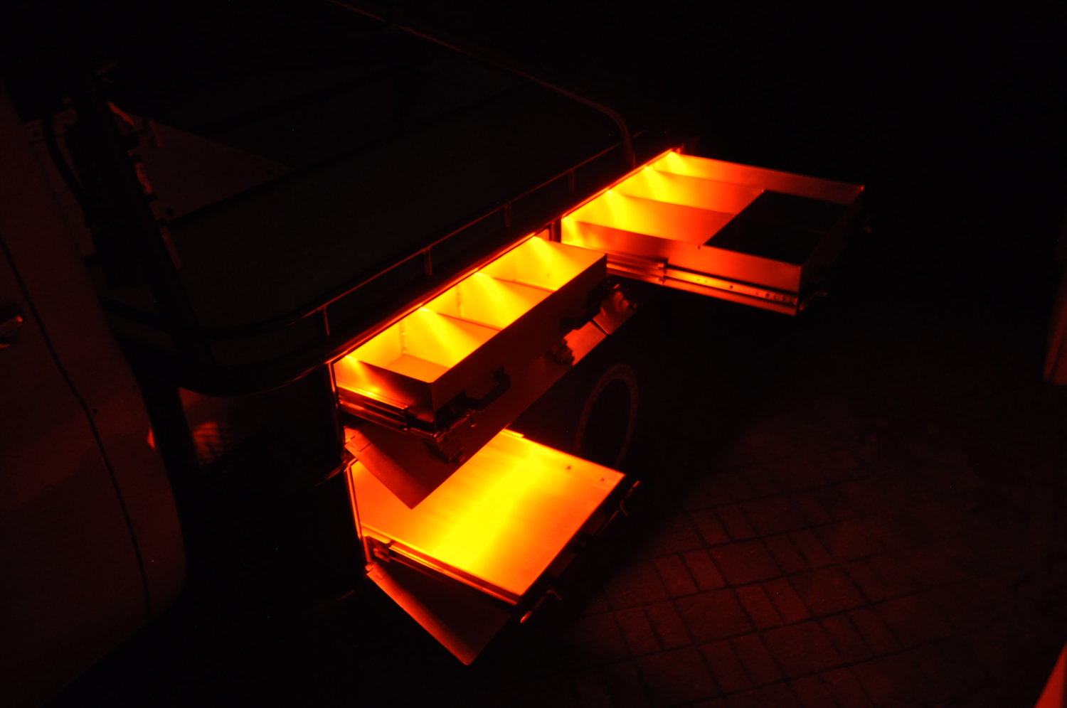

I'm a piece 0' chit.. I have zeRo luck.. it's all good... karma and all that... my big motivation this weekend.... first time... amazon prime decided to send me a free harness for a lightbar.. cheap, like $10... +/- leads to a fuse and relay, long switch lead, long +/- lead to the lights...

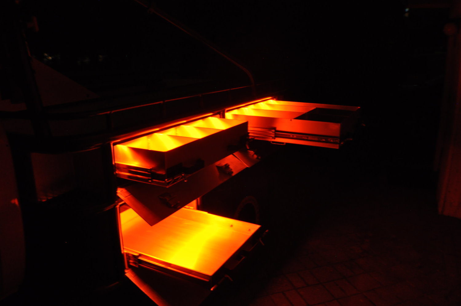

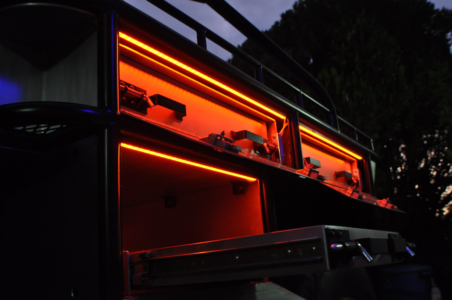

"oh them drawer lights be going in now!!!!!" :saweet: :saweet: :saweet: :haha:

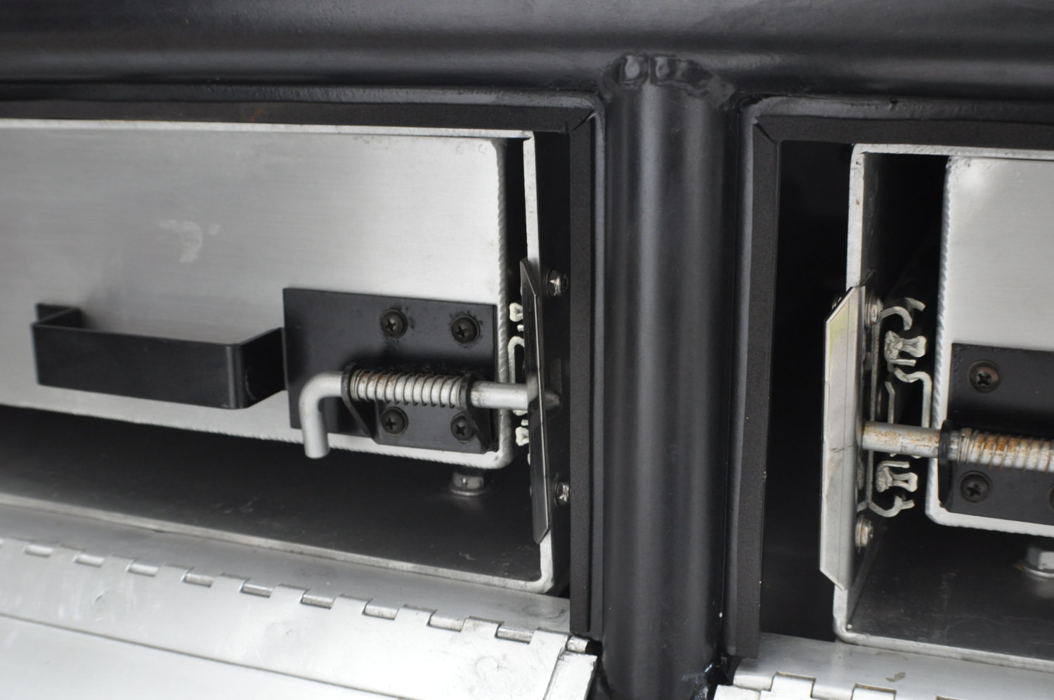

note the rusting pins.... my quickie clear douche ain't cutting it... need to add that to my "coating dilema" list... ;)

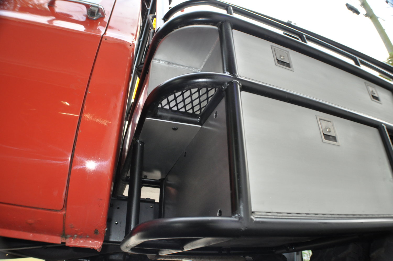

first order of biz is figuring out exactly what wires need to pass thru the bat box..... the intention is to move my lightbar sub panel in there, and the winch solenoid pack.... than it will also end up with an inverter... i'm running the Heyco fittings like I ran on the K5 stuff....

but I also need to run smaller control wires to various components in there, winch, the bat switches, parallel, and all the light sub panel wires...
